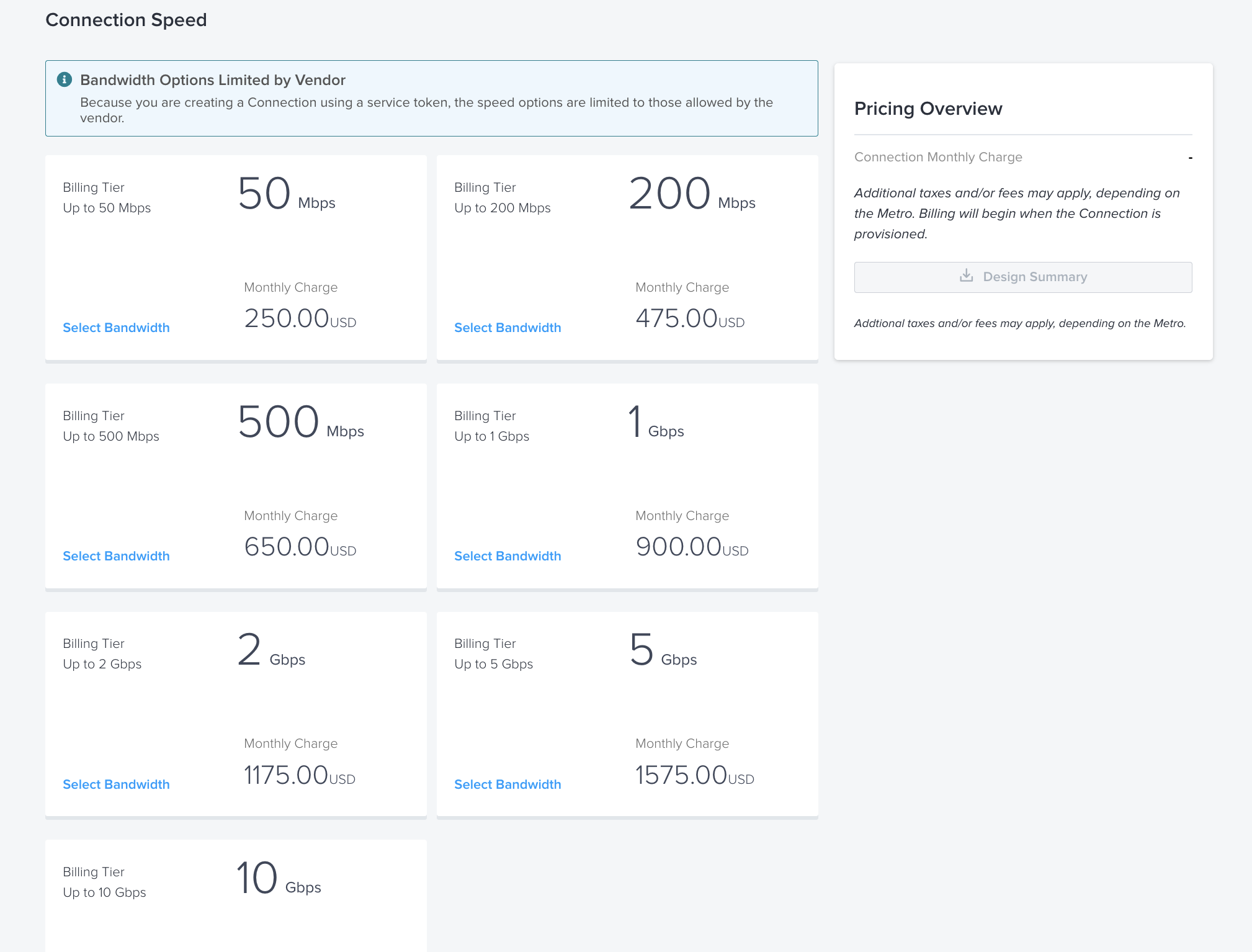

- The Maximum Interconnection Speed is set to the default maximum of 10 Gbps. You will select the actual speed of the connection when you redeem your service token in the Fabric portal.

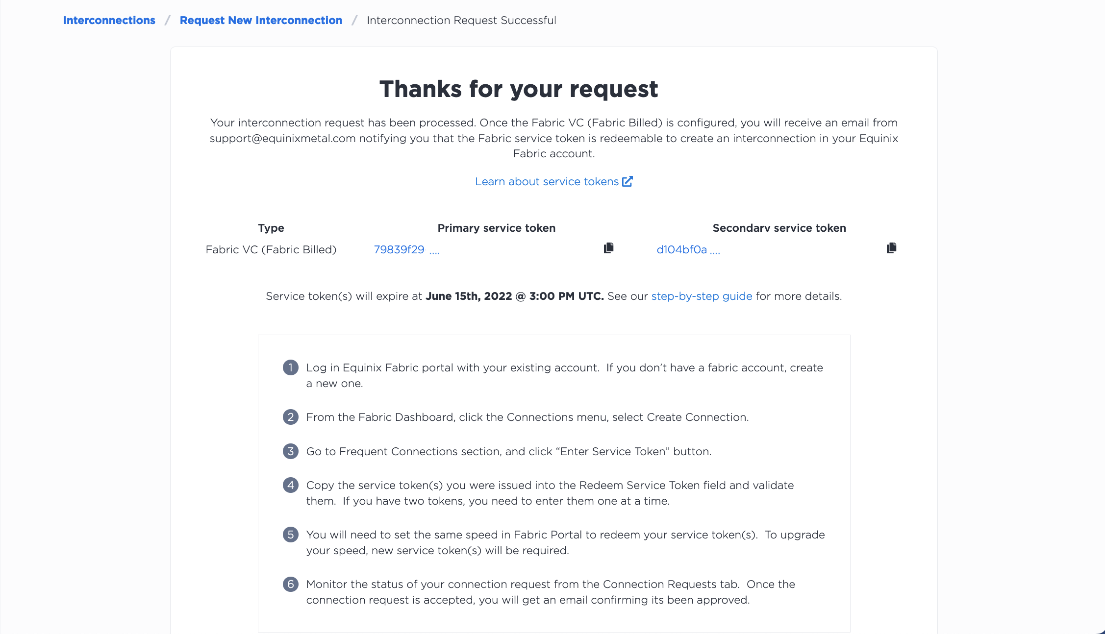

Review the summary of your request. Click Submit Request to receive your z-side service tokens.
Tokens expire in 7 days. You should also receive an email with your tokens and expiration information. On the Interconnections page, your newly requested Fabric Virtual Connection will be listed on the Pending Requests tab.

Sending the request creates generates your z-side service tokens. The tokens are included in the response object. If you requested a redundant connection, you will receive two tokens.

Tokens expire in 7 days. You should also receive an email with your service tokens and expiration information. You can check on your request and retrieve the tokens during this window by sending a GET request to the /connections/{connection_id} endpoint.

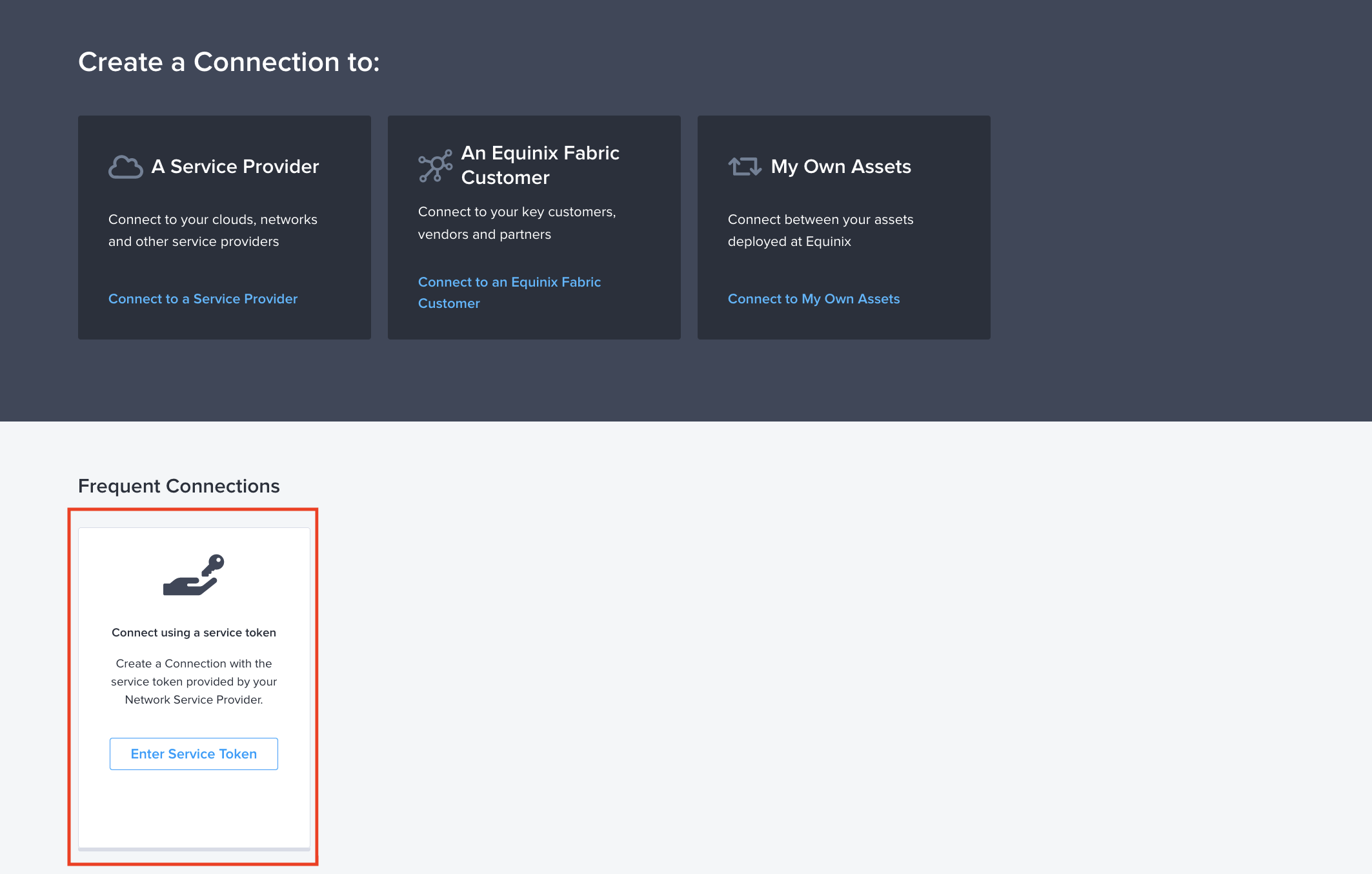

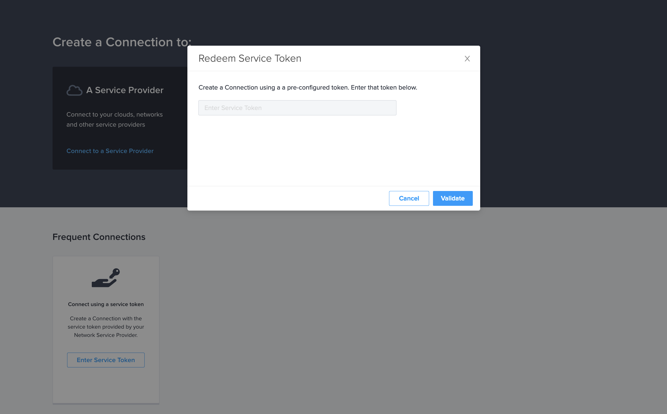

To redeem your token, login to the Equinix Fabric portal and from the Connections drop-down menu, click Create a Connection.
Under Frequent Connections, select the Connect using a Service Token tile, and click Enter a Service Token.
In the dialog box, paste your token in the Enter Service Token field, and click Validate.
Verify that the details of the token are correct, and click Redeem to redeem your token and finish setting up yor connection to Fabric.

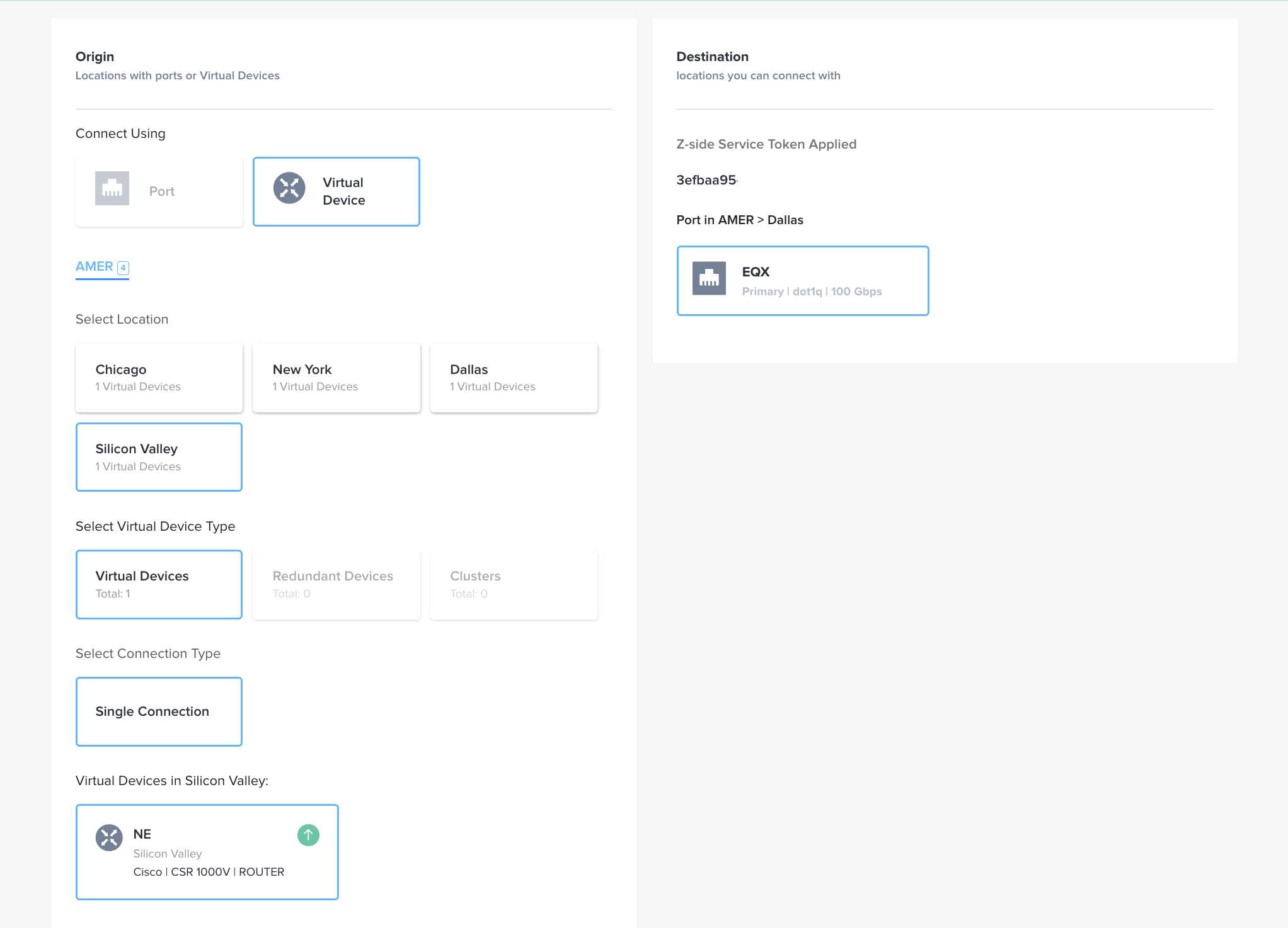

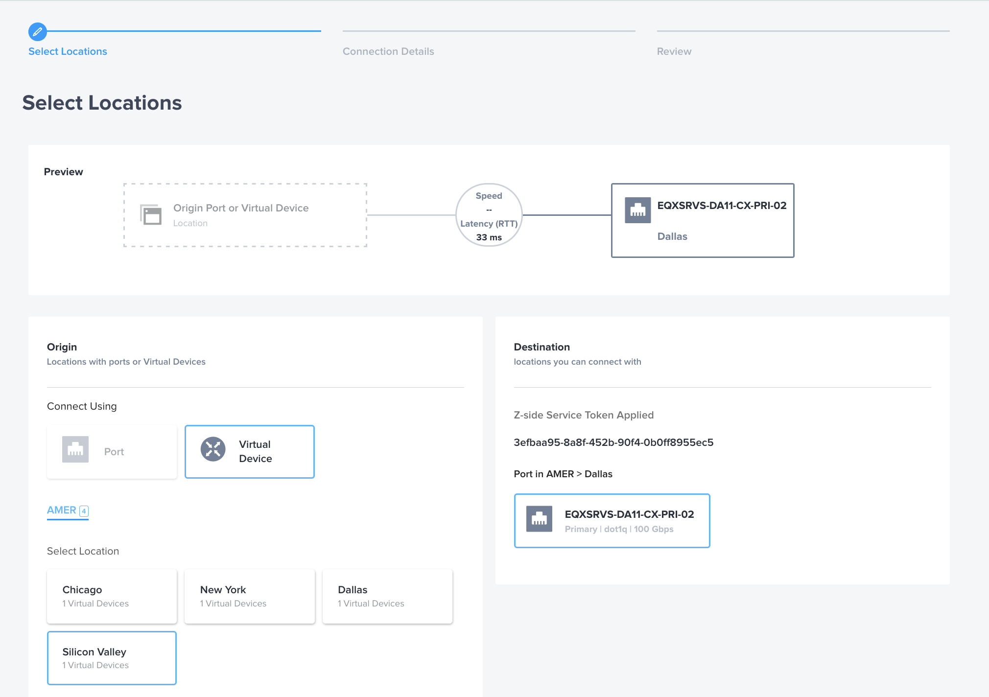

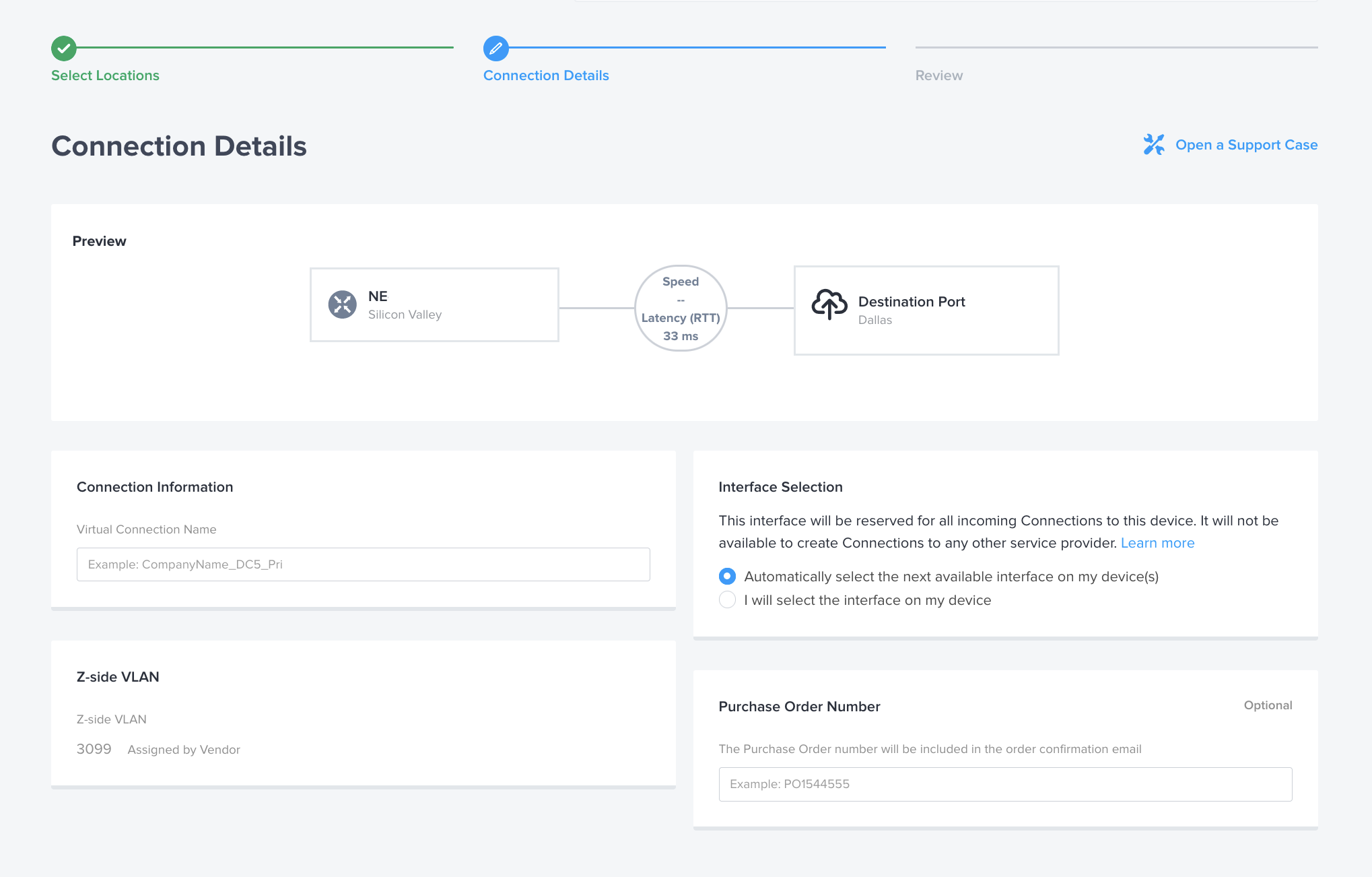

You can now continue setting up your connection in the Fabric portal. Since you redeemed a pre-configured service token, Equinix Metal will automatically be set as the destination for the connection and you will be choosing the origin.
First, select the location of the origin of the connection. This is most often a Virtual Device, but could also be one of your own Equinix Fabric ports. The virtual device or port can be in any metro.
If you are using a Virtual Device, select the device type and the connection type. Currently, Redundant Devices and Clusters are not supported.
On the Connection Details page, give your virtual connection a friendly name, specify which interfaces on the virtual device to connect with (if necessary), and specify a Purchase Order number if your organization requires it for billing purposes. The z-side VLAN is auto-assigned by the service token, and does not have to match your VLAN IDs on Equinix Metal.
Next, set the speed of the connection. Equinix Metal sets the maximum speed for Fabric Virtual Connections - Fabric Billed at 10 Gbps. Choose from the Fabric speed options and pricing.
The last page is a review, where you can review your choices and go back and make changes. When you are ready to place the order, click Submit Order. This initiates a connection setup process between Fabric and Equinix Metal in the background that can take up to 10 minutes to complete.

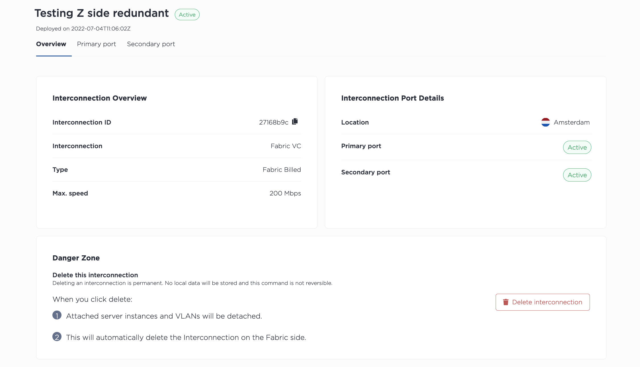

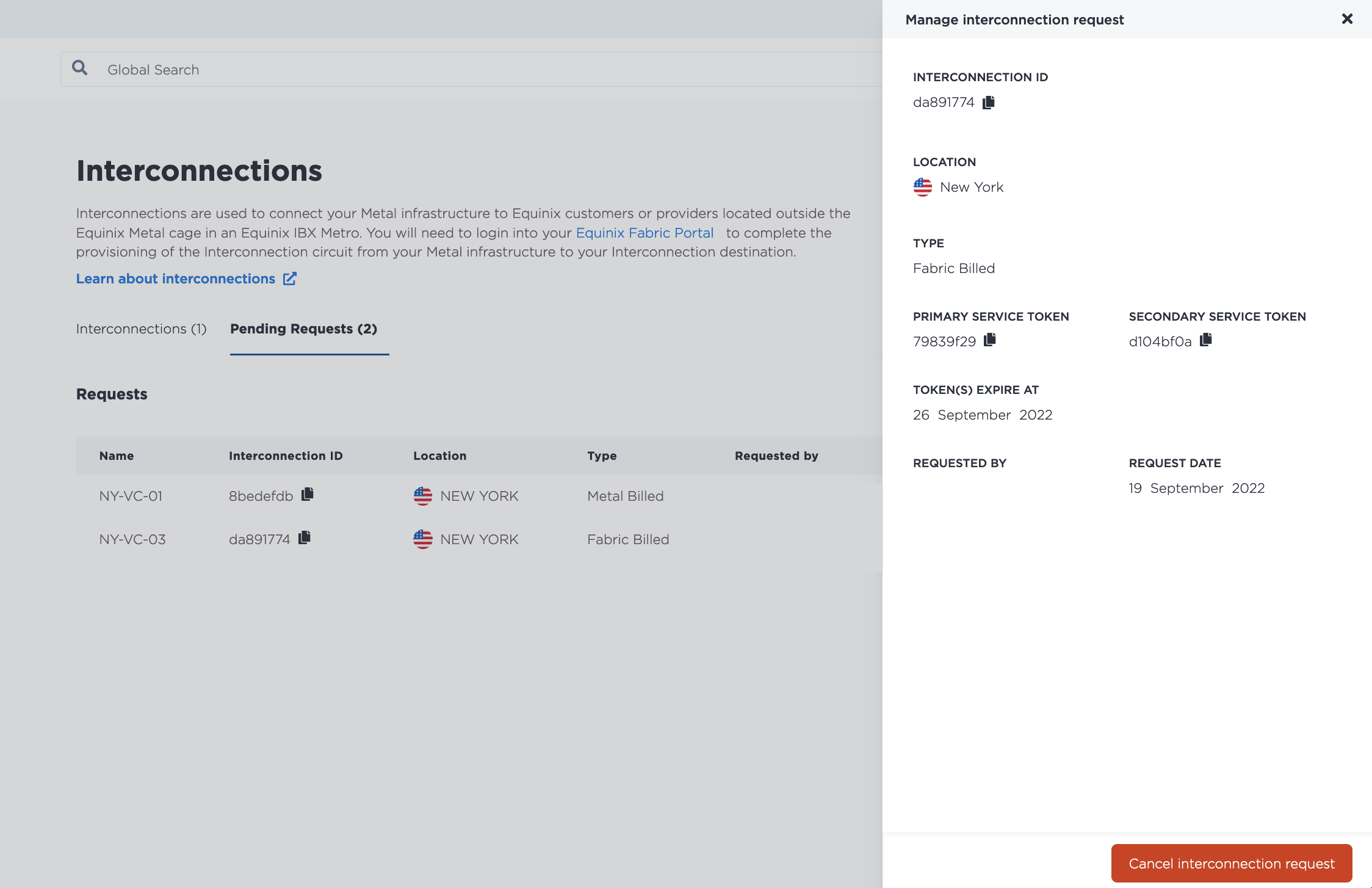

Once the Interconnection is established between Fabric and Equinix Metal, it will appear on your Project's Interconnections page, in the Fabric VC section, with Active as the status.
- Fabric Billed Fabric Virtual Connections have type Fabric Billed.
- Metal Billed Fabric Virtual Connections have type Metal Billed.
- Interconnections that were set up as Shared Ports are indicated with type Legacy.
Note that Dedicated Ports are managed at the organization level, so if there are any Dedicated Ports in your organization, they will also appear in the Dedicated Ports section.
Clicking on the Interconnection's name brings you to its Overview page, which contains a detail view as well as a summary of the primary port and secondary port configurations.
Clicking either Primary Port or Secondary Port displays the port's status and configuration.

Deleting a Fabric Virtual Connection is permanent. When you delete the connection, all attached VLANs will be detached, and traffic from Fabric to your servers will be cut off.
Deleting a Fabric-billed Virtual Connection from the Equinix Metal side automatically deletes the connection in Fabric. If you delete it from the Fabric portal, it will also be automatically cleaned up on Equinix Metal side. This is an asynchronous process that can take up to 3 minutes to complete.
