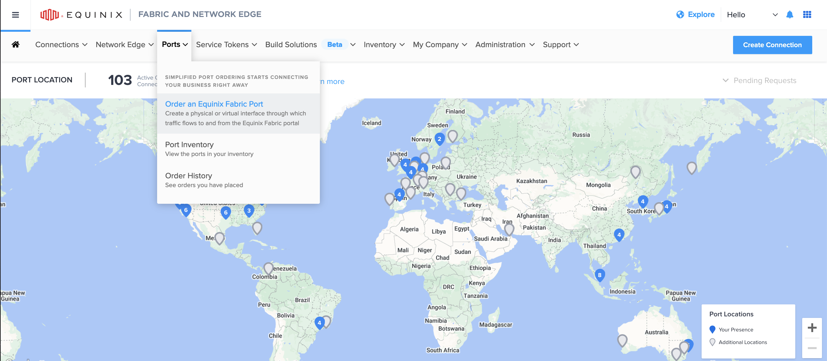

After you have received the LOA from Equinix Metal, you can place an order for your remote port in the Equinix Customer Portal. From the Customer portal main page, select Order an Equinix Fabric Port from the Ports menu.
Customer Portal Main Menu

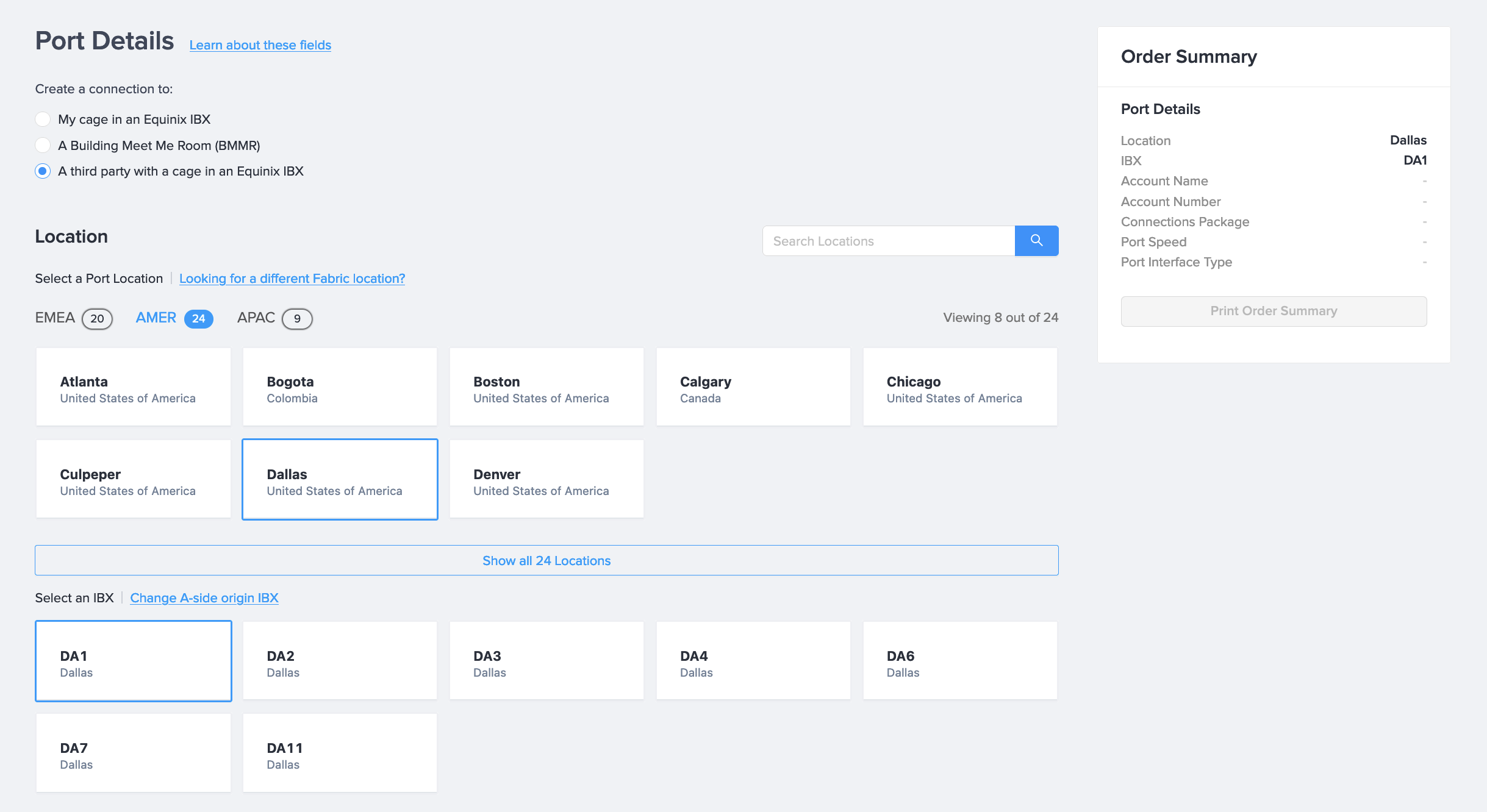

From the Create a connection to: options, select A third party who has a cage in Equinix IBX.
Then, select the Location of the remote port. The location you select must be the IBX site specified in your LOA. Please note that the patch panel location for the NNI port specified in the LOA might be in a different location than your Equinix Metal instance, but both will be in the same Metro.

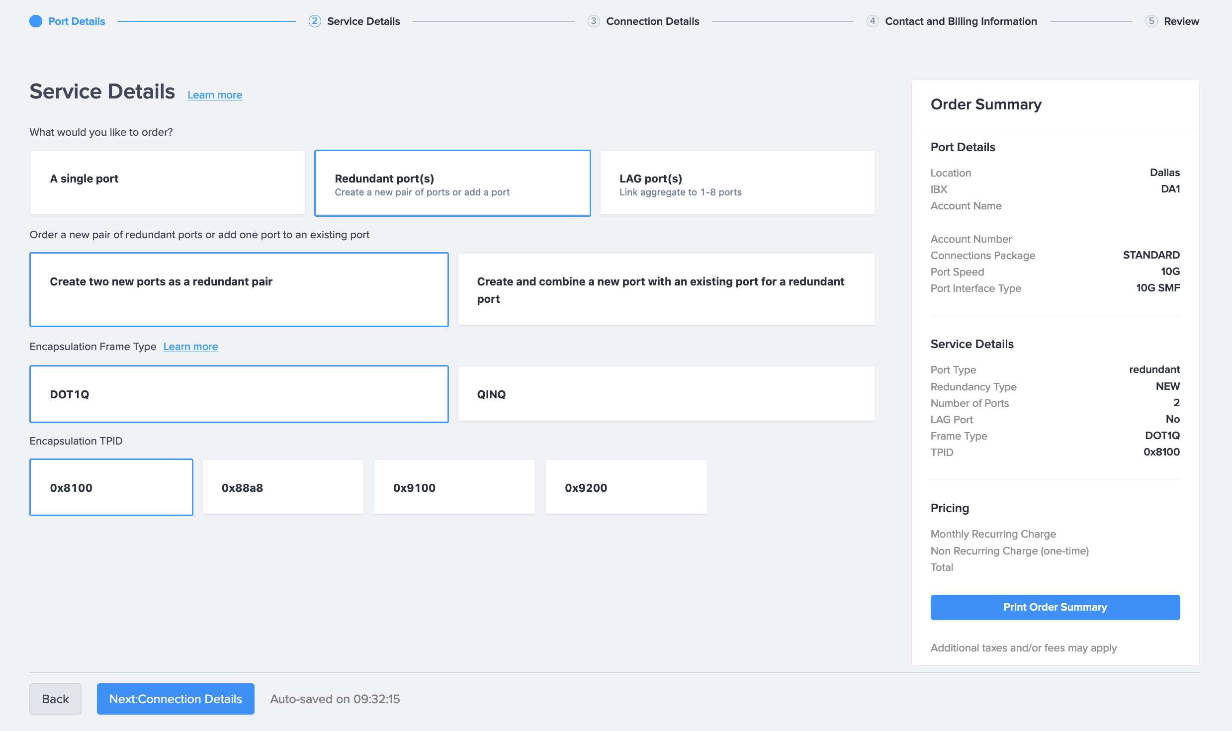

On the Service Details section of your order, select the following options:

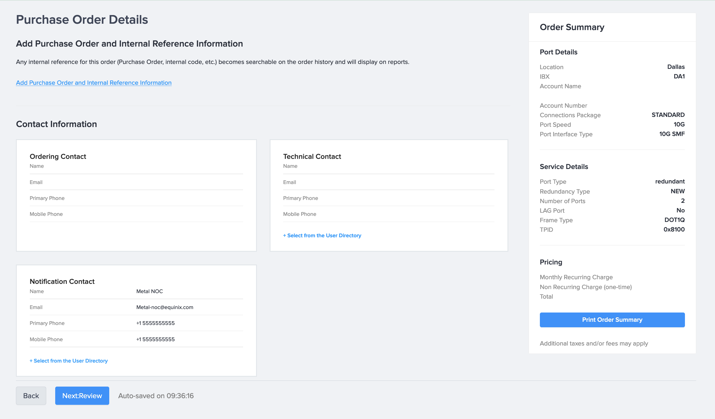

  • For Single vs Redundant, choose the same configuration that you choose on Equinix Metal. So if you choose redundant ports, select Redundant Port(s) and Two new ports as a redundant pair. If you choose a single port, select A Single Port. LAG ports are not supported.
  • Equinix Metal only supports Dot1Q on the Fabric side.
  • Equinix Metal only supports 0x8100 TPID encapsulation.

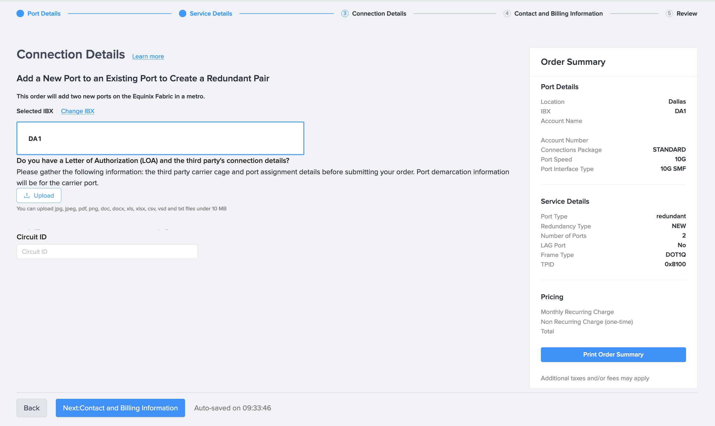

Connection Details
On the Connection Details page, upload the LOA provided from Equinix Metal.

Contact and Billing Information
Confirm your contact information, and add any necessary Ordering Contacts and Technical Contacts.

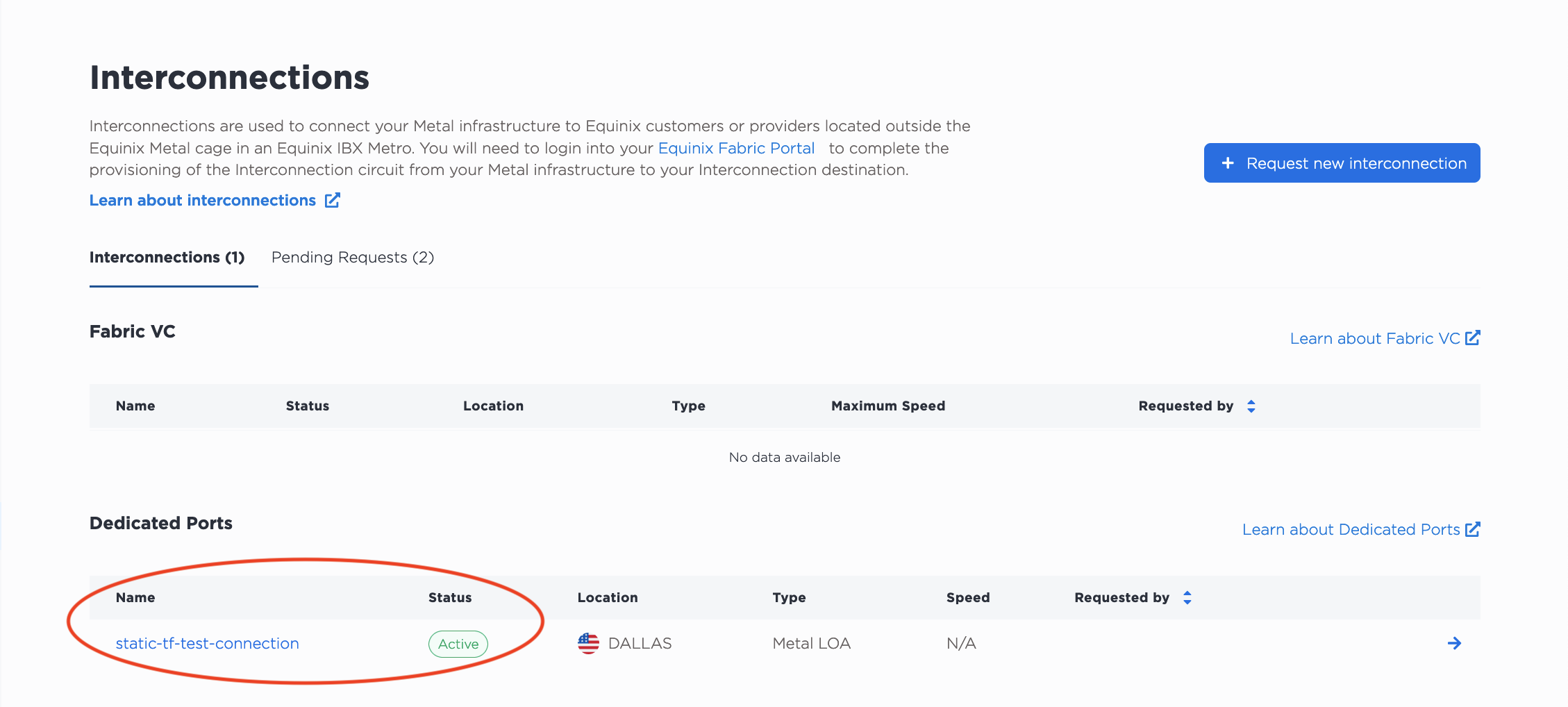

Once your port is physically ready on both sides, the Equinix Metal console will show the Dedicated Port status as Active.
Active Dedicated Port in the Equinix Metal Console

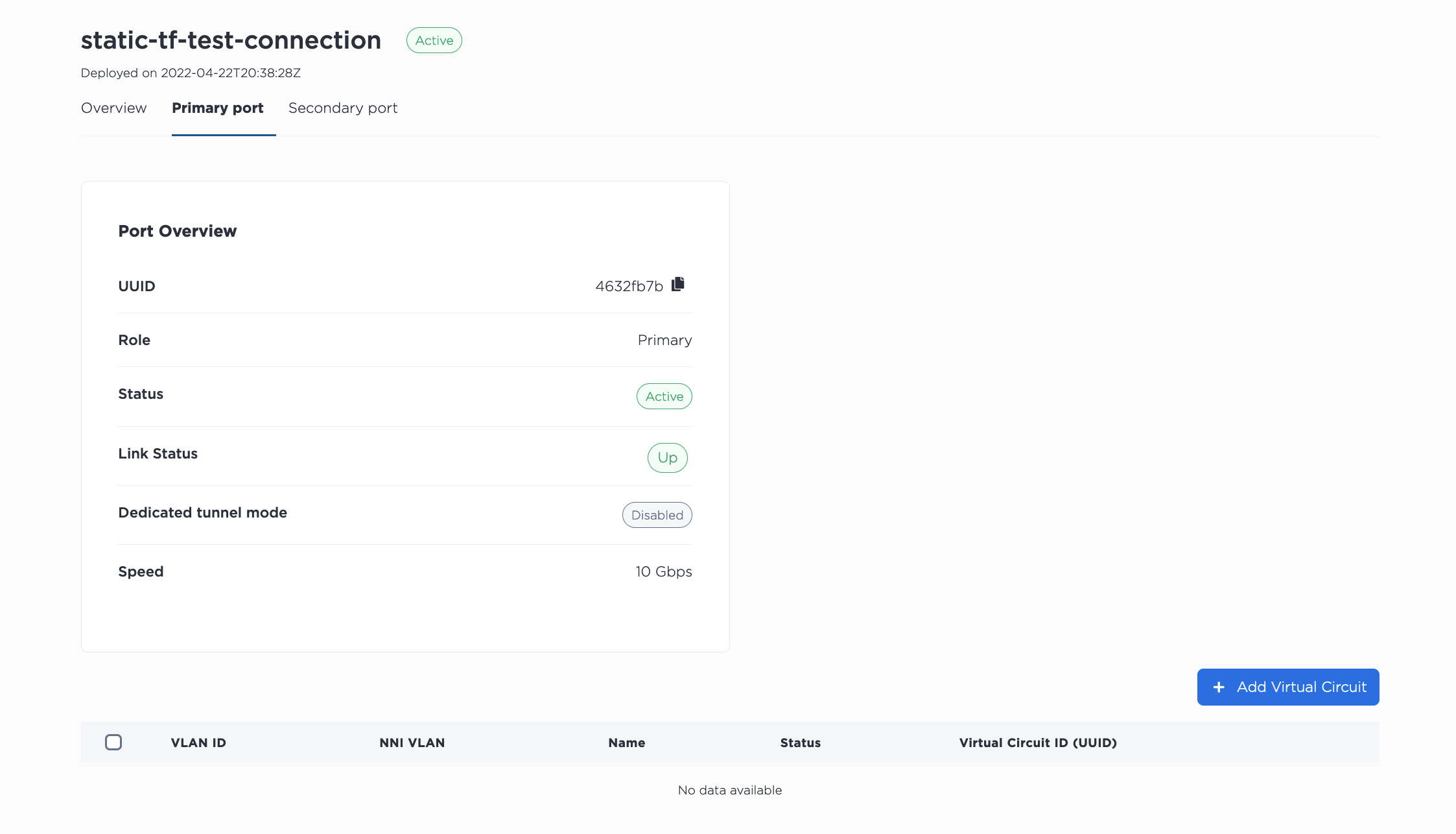

And at least one of your Primary or Secondary Ports will be Active.
Active Primary Port in the Equinix Metal Console

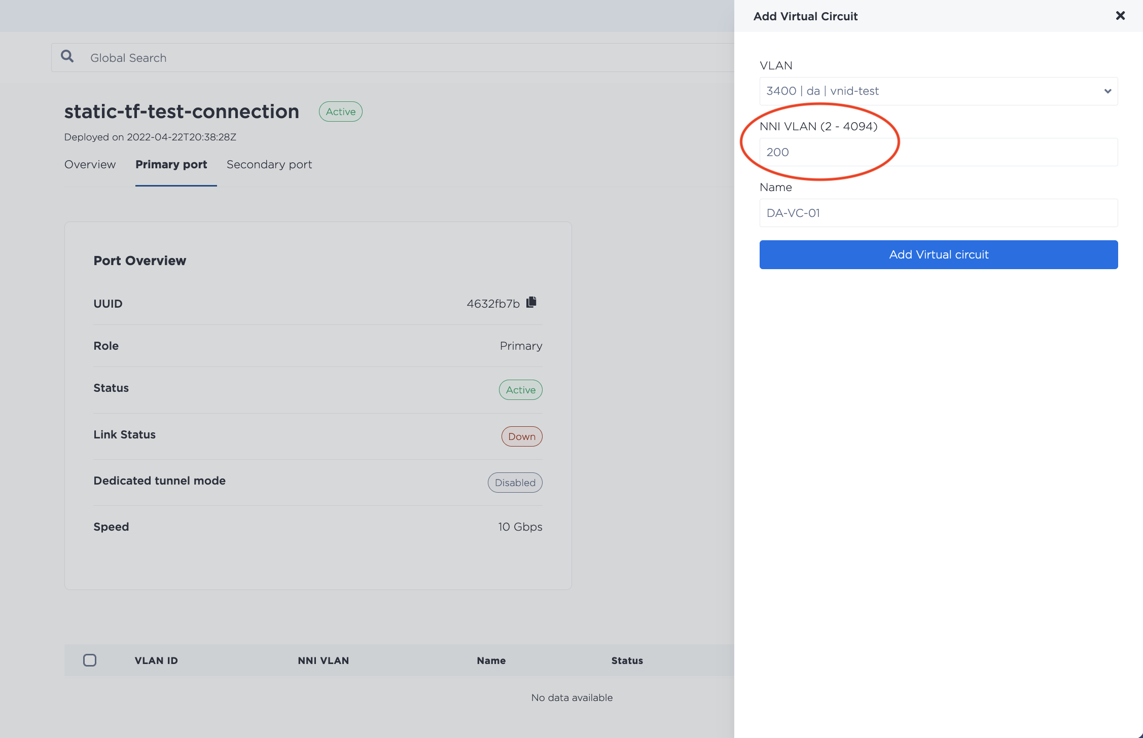

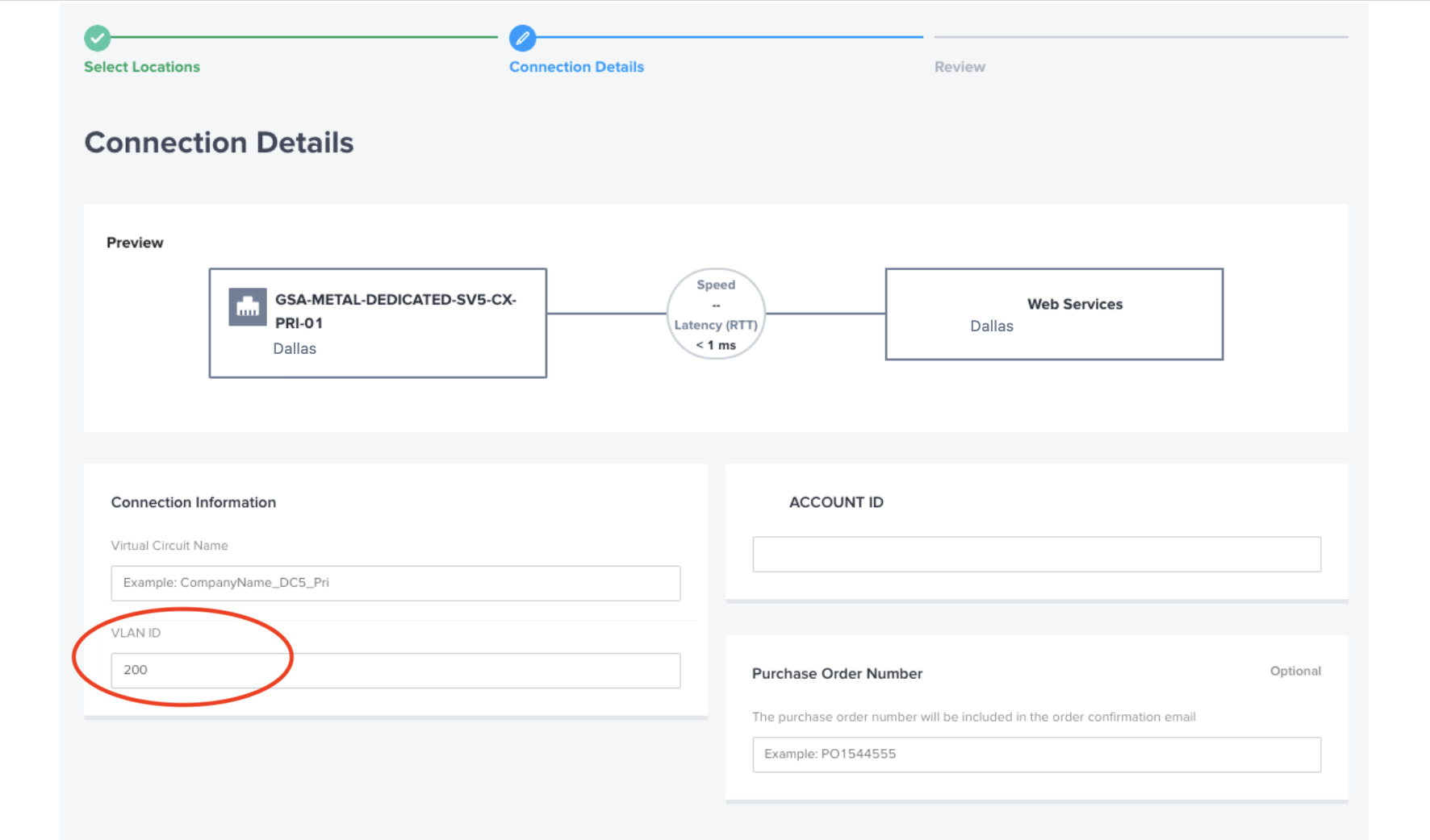

  • The VLAN identifier on the Equinix Metal side and the Fabric side need to match. It also needs to be an integer between 2 and 3999, and unique on the Equinix Metal side.
For example, if you assign 200 as the NNI VLAN on the Equinix Metal side of the connection:
Creating a Virtual Circuit and Associating a VLAN
Then, when you set up the virtual connection from the port in Equinix Fabric, assign 200 as the VLAN ID.
