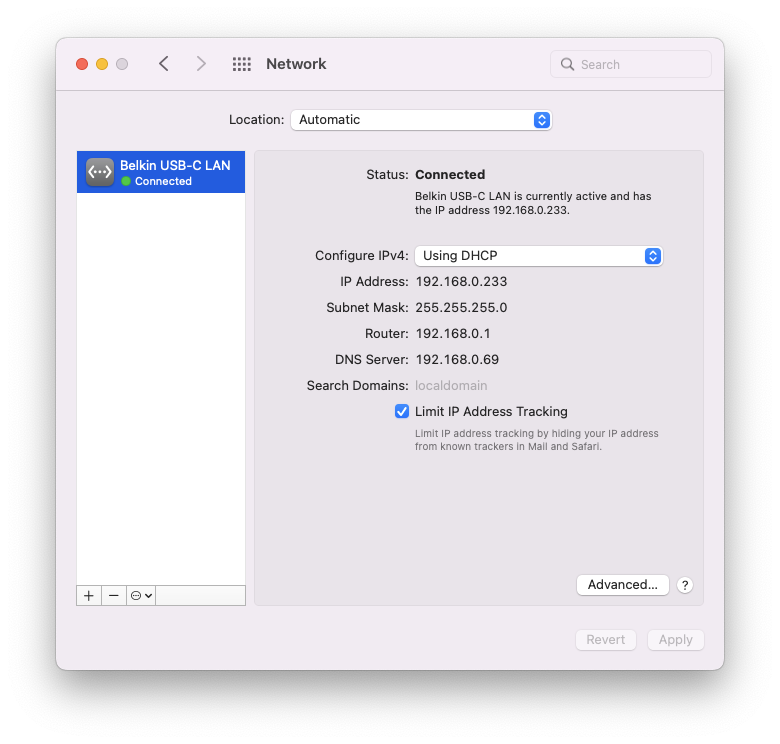

Open your System Preferences and click on “Network”. You will see a list of existing networking devices to your left.
Example Network Panel in MacOS

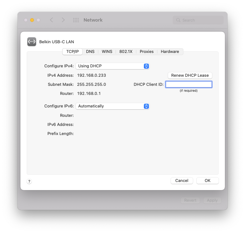

Select the currently active one (i.e. the one with a green dot below it) and click on “Advanced”. Select “TCP/IP”. Here, you can see what IPv4 and IPv6 addresses are currently assigned to your client.
Example IPv4 and IPv6 Address Assignments
