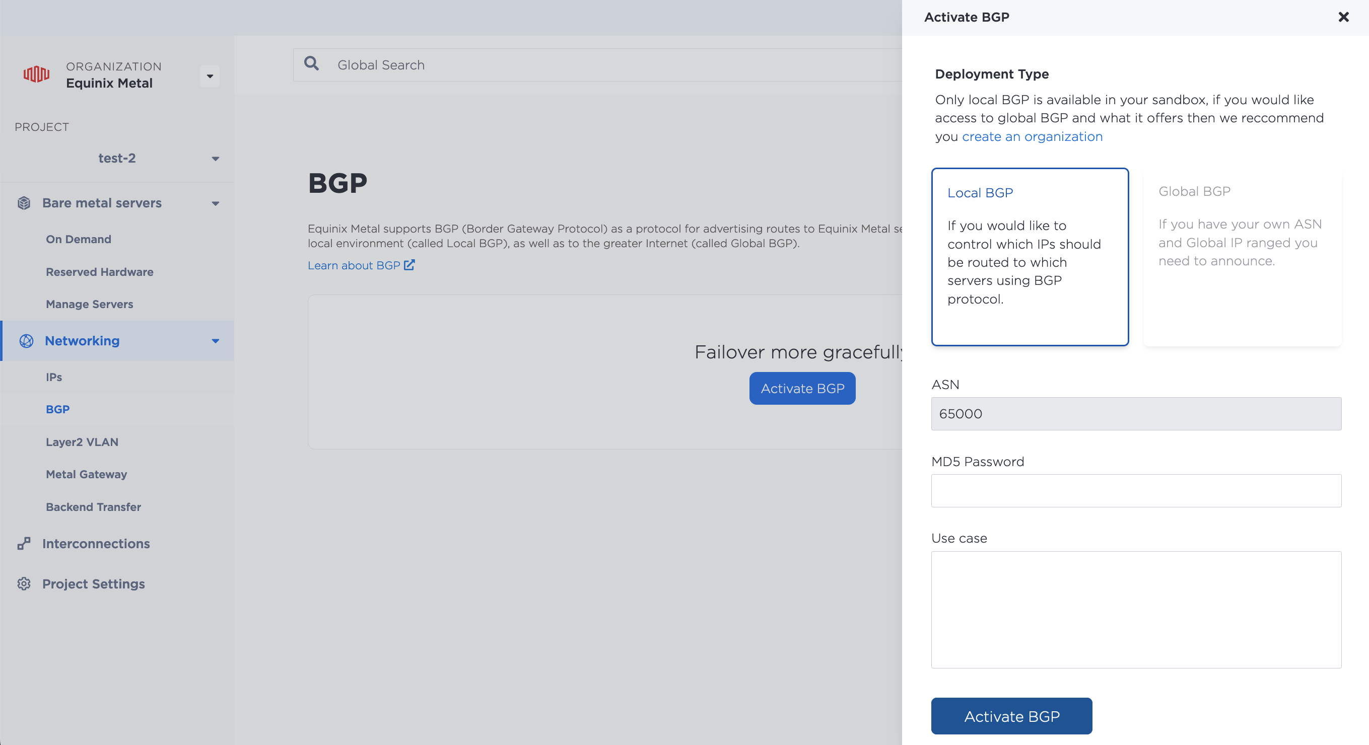

In the console, navigate to the Projects Networks section and select BGP. Click Activate BGP, which brings up the Activate BGP pane.
Select Local BGP. The field for ASN is automatically set to 65000. If you want to enable and require authentication between neighbors, enter a password in the MD5 Password field.
The Use Case field is not required for enabling Local BGP.

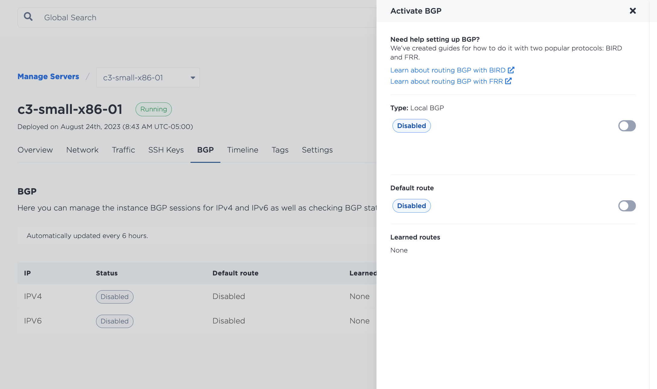

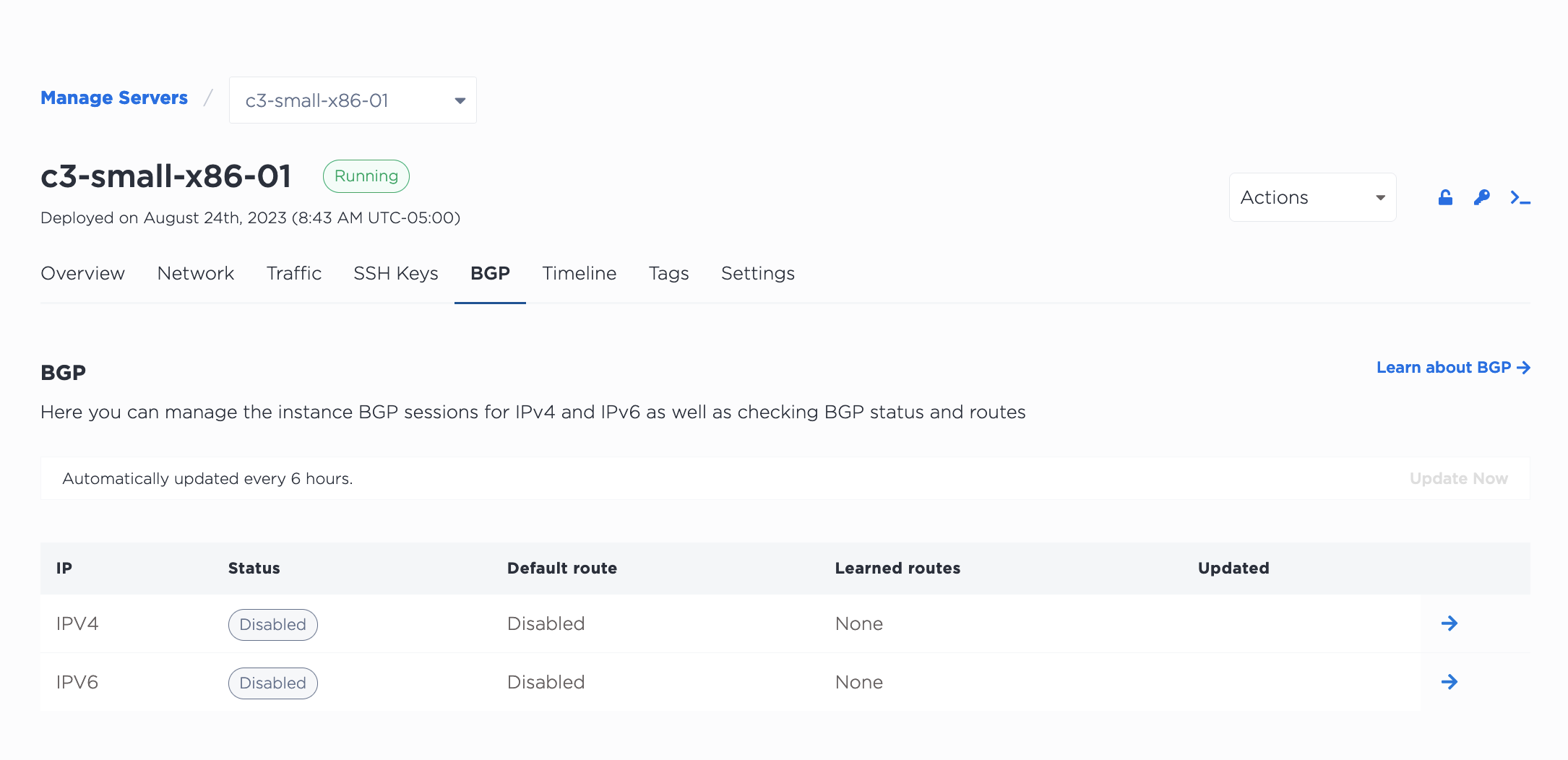

After enabling Local BGP for your Project, the server's BGP page will have options for managing and tracking Local BGP sessions for both IPv4 and IPv6 addresses.
Click Manage to open the Activate BGP panel. To enable BGP and initiate a BGP session, toggle Enable BGP. Use the Default Route toggle to set this as the default route. Note: the Default Route toggle may not appear until after enabling the BGP session.

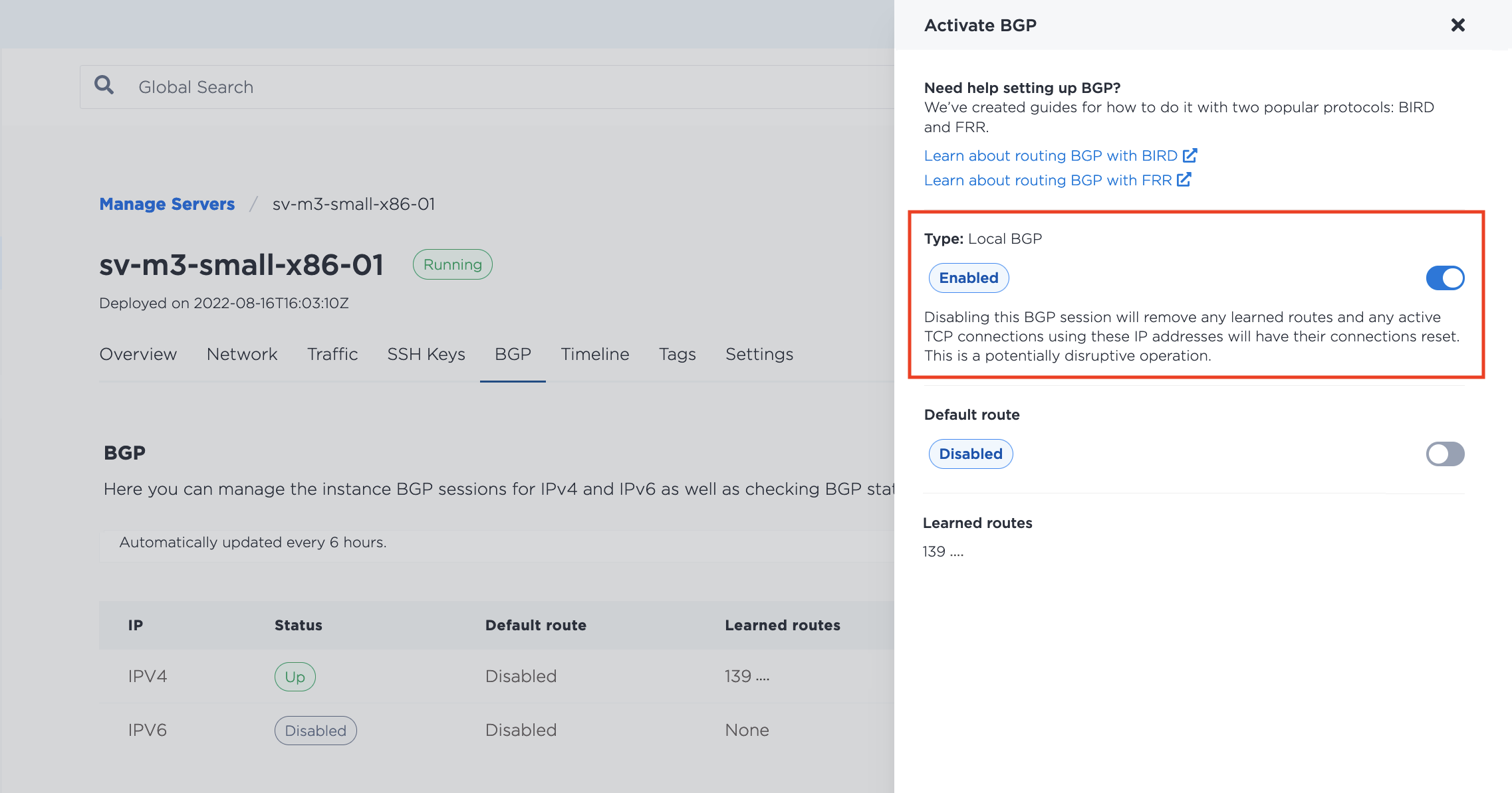

You can disable a BGP session on Equinix Metal to stop announcing the IP address and publishing your routes. This will remove learned routes, reset any open connections, and is potentially a disruptive action. Use care before disabling the session.
Disabling BGP does not remove any of the BGP configuration on the server; if you need to, you can re-enable the session, and go back to publishing routes without changing the server's configuration. If you do re-enable, it may take 5-10 minutes for the session to be established.

On the server's BGP page, click the arrow to bring up the options for which BGP session you would like to disable. In the Activate BGP pane, use the toggle disable BGP.
