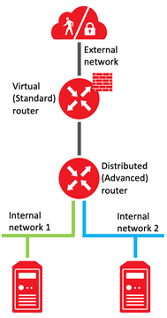

Edge Gateway​
The network interface between the Virtual Data Center (VDC) and external networks such as Internet and WAN has various configuration options, the exact choice depends on the desired functionality.
The following options are available:
  • Edge gateway shared internet
  • Edge gateway single
  • Edge gateway stretched
The configuration of the edges also defines the network options between multiple VDCs, e.g. distributed firewalling, and inter-site networking.
Edge Gateway Shared Internet​
When only using internet as a connectivity option with a maximum of five IP addresses per VDC, the Edge Gateway Shared Internet will be sufficient. The related Internet product is ECforMS and must be purchased separately.
When an IP block of eight or more IP addresses is needed, select Equinix Internet Access for the internet connection product. On the Edge Gateway Shared Internet, only ECforMS can be configured. Other options like WAN connectivity to colocation or Public Cloud is not available with this Edge option. When in a later stage WAN connectivity or a larger IP blocks are needed, an IP renumbering and migration to another edge type is necessary.
Edge Gateway Single​
This option is best suited when a VDC has connectivity via Equinix Internet Access for the internet and/or connectivity to a second VDC, cabinet, cloud provider or on-premise location. The Edge gateway is available in two configuration options:
  • Shared – This option offers the feature to connect multiple routers to the same internet or WAN connection using NAT.
  • Dedicated – A single Edge gateway connects the EBC networks to the internet and WAN without requiring NAT.
When route advertisement is needed where networks in the VDC are automatically available from the WAN connection, the option Dedicated is necessary. This maybe desirable, for example, if IP-space in the Public Cloud needs to be connected to the same IP-space in the VDC.
In all other cases the Shared option is suitable.

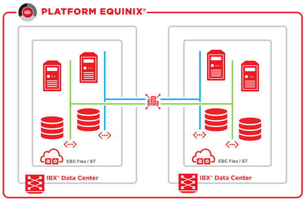

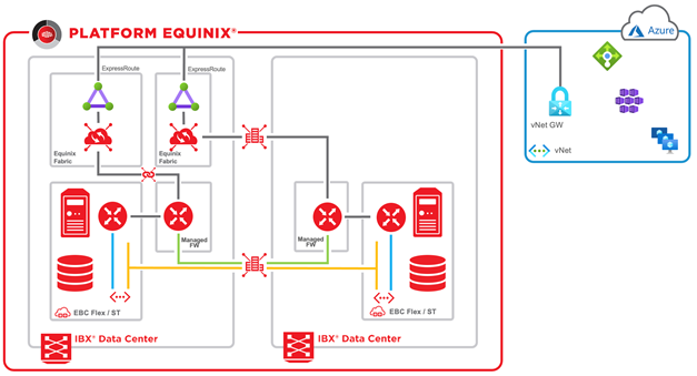

Edge Gateway Stretched​
This option is available to share networks between data centers in one VDC. There is one router available for the internet and/or WAN connectivity. This option supports the use of route advertisement so networks in the VDC are available from the WAN connectivity.
This option is obligatory in two scenarios:
  • EBC ST Premium where hosts are in two data centers in a stretched cluster configuration.
  • In a disaster recovery scenario with two VDCs and EBC Availability.

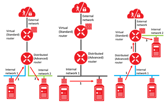

EBC Flex Network (deprecated service description)
The EBC platform offers various virtual network functionalities that you can configure through self-service on five Network Functions Virtualization (NFV) feature levels.
The table below provides an overview of these individual features.
NFV Feature Level VDCSelf-Service Feature DescriptionEquinix Virtual Routers RequiredCosts Per VM1
Basic (Minimal NFV self-service)
  • Virtual L2 networks
NN
Standard (Recommended)
  • Standard firewall
  • Routing (static, BGP)
  • NAT
  • DHCP
  • Load Balancing
  • VPN IPSec layer 3
Y2N
Advanced
  • Advanced Firewall (Policy-based security zones through micro-segmentation)
  • VPN (layer 2)
N
---Y
Enterprise
  • IPv6
N/AY
Enterprise Plus
  • Future functionality
YY
NFV Feature Level vAPPSelf-Service Feature DescriptionEquinix Virtual Routers RequiredCosts Per VM
vApp (serving intervApp network traffic)
  • Standard firewall
  • Routing (static)
  • NAT
  • DHCP
Y3N
Note:
  • For VMs that use NFV features, a surcharge applies, calculated on the number of GB vRAM in those VMs.
  • In the minimum configuration, 2 virtual routers in the size “Large” are created per VDC.
  • For each Inter vApp network, 1 virtual router in the size “Compact” is created.
The virtual routers supplied by Equinix contain NFV functionalities for all VMs within the VDC.

Deprecated - Virtual Routers NFVs​
To enable the full set of Network Function Virtualization (NFV) features, Equinix typically deploys the VDC in the Standard NFV feature level. The Standard set of features requires the EBC virtual router in at least the size, Large, which is sufficient in most cases.
EBC virtual routers (or, virtual routers) are available in 3 performance levels. Depending on feature and performance needs, the virtual router can be upgraded from Large to a Quad-Large or X-Large size. The Standard NFV feature level provides self-service functionality for your VDC, by managing internal and external traffic flows. Using the NFV features, the desired security policy for your organization can be implemented at network level.
Virtual routers support routing, load balancing, and VPN features in firewall services. A single virtual router supports routing up to 100 internal networks by applying the standard and advanced routing methods. Combined with external networks (for connections to carrier, or Equinix Fabric), a virtual router is capable of realizing most network configurations.
Standard Routing​
With standard routing, up to 8, (internal and / or external) networks can be attached to a single virtual router. Routing takes place within the virtual router itself. External networks can only be connected via the standard routing method.
Advanced Routing​
With advanced routing, up to 100 internal networks can be attached to a single network interface of a virtual router and is referred as Distributed Logical Routing (DLR). Because it is a logical router, changes to the routing table (for example, adding / removing an internal network) are automatically configured by the platform.
Traffic to and from advanced routed internal networks remain within the hypervisor layer and does not pass the virtual router, which impacts firewalls. Network traffic between standard routed networks always passes the virtual router.
The benefits of advanced (distributed) routed networks are mainly the improved scalability of routed internal networks. Secondly, advanced routed networks have a positive effect on bandwidth and latency. Advanced routing is available in NFV feature level Standard, and up to 8 internal and external networks can be attached to the same virtual router using the standard routing method.

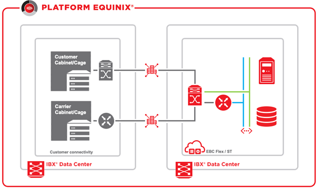

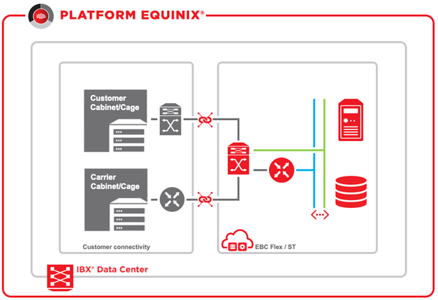

Colo/Carrier Connectivity​
For the EBC environment to be connected to a Colo (cabinet) or Carrier, EBC External network and Infrastructure Port are necessary. This way, up to 25 external networks (L2) per VDC can be routed within the local data center, to a remote (Equinix) data center, or an on-premises platform.
In many situations, routing (layer-3) functionality is needed. In these cases, Equinix can provide this via:
  • EBC Virtual Router
  • Managed Firewall
  • Managed Router
To avoid having overlapping VLAN numbers between customers, the VLAN number of each external network offered is translated into a VLAN number issued by Equinix. The translated VLAN number is used within EBC and its related services.
The following table shows which Equinix services are required for the use cases.
External Network OptionsEBC to Cabinet / Carrier in Same EQX DC
Type of connectivityDedicated connectivity
Included Equinix services2x Cross-Connect
Additional required Equinix services≥ 1x EBC External network 1x Infrastructure Port - redundant
Bandwidth1 / 10 Gb
RemarksCustomer VLANs are likely to be translated
External Network OptionsEBC to Cabinet / Carrier in Remote EQX DC
Included Equinix services4x Cross-Connect
Additional required Equinix services≥ 1x EBC External network 1x Dual-diverse Metro Connect1x Infrastructure Port – redundant
Bandwidth1 / 10 Gb

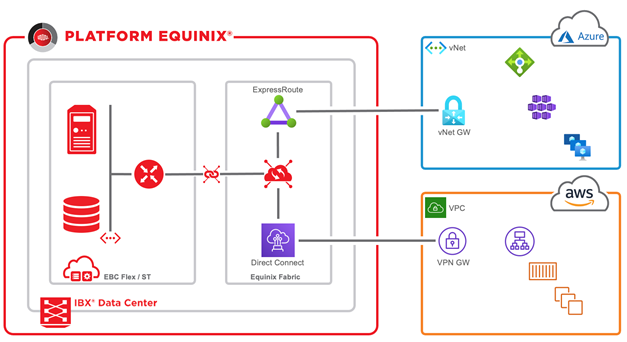

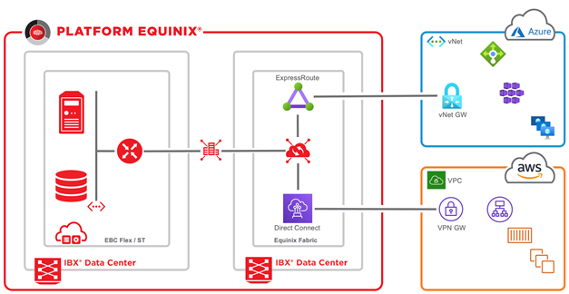

Equinix Fabric Connectivity​
To connect the EBC environment to Equinix Fabric, a combination of services is needed. These include Equinix Fabric ports, EBC External networks, and Infrastructure Ports. Most providers connected to Equinix Fabric require routed (layer-3) based connection. To support Fabric connections to the EBC environment, BGP based routers are required in general. Equinix can provide this type of router via:
  • Managed Firewall
  • Managed Router
Fabric ports can be local or in a different Equinix data center (metro) depending in which Equinix data center the VDC is deployed. If EBC is deployed in AM3, it's local. In ZW1 and EN1, connections are of the type metro, since Fabric equipment is located within the Amsterdam metro area.
Fabric connections are offered in a redundant way. Therefore, 2 Fabric ports (primary and secondary), and 2 virtual connections (one per port) are required. Fabric connections themselves can be of type local or remote, depending where the service provider is located in the Amsterdam region. See Equinix Fabric to learn more.
The following table shows which Equinix services are needed for these use-cases.

External Network OptionsDual EBC (AM3 + ZW1 / EN1) to Fabric
Type of connectivityDedicated verbinding
Included Equinix services8x Cross-Connect2x Path-protected Metro-Connect
Additional required Equinix services2x Fabric port2x Fabric metro port1x Dual-diverse Metro-Connect≥ 8x EBC External network 2x Infrastructure Port – redundant≥ 2x Fabric Connection (local or remote)
Bandwidth1 / 10 Gb
Remarks2 Fabric connections per provider are needed. For each connection one EBC External network is required. Connections in both DC’s are local redundant.

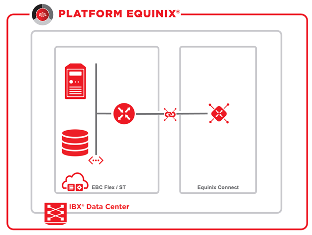

Equinix Connect Connectivity​
To directly connect the EBC environment to the Internet, a dedicated connection in the form of an Equinix Connect (EC) may be required. A dedicated EC is advised when requirements include:
  • A dedicated link with 1Gb or higher bandwidth
  • Anti-DDoS
  • Customer provided IP blocks (own ASN supported, not required)
  • Equinix supplied IP blocks of /29, /28 or /27
The EC connection is connected to the EBC environment by applying EBC External network and Infrastructure Port. This requires BGP based routers. Equinix can provide this via:
  • Managed Firewall
  • Managed Router
The following Equinix services are needed for these use-cases.
External Network OptionsEBC to EC in Same EQX DCc
Additional required Equinix services1x Equinix Connect port (multi-homed)≥ 2x EBC External network1x Infrastructure Port – redundant
Bandwidth1 / 10 Gb
Remarks—

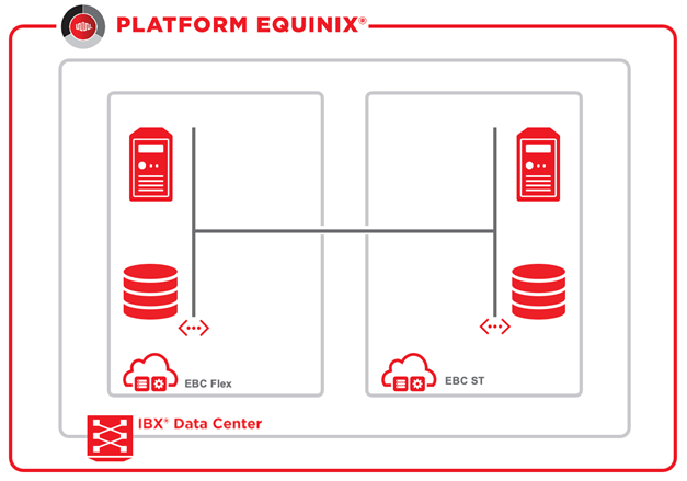

EBC Dual-Site​
When EBC services are consumed at 2 locations, Stretched Layer-2 Shared and Stretched Layer-2 Dedicated are available for realizing L-2 connectivity. Both are applicable for EBC and Equinix Managed Services products such as Managed Storage (file, block, object) and Application Platform (Kubernetes container platform).
The choice between the two is determined by the amount of bandwidth and number of external networks required.
External Network OptionsStretched Layer-2 SharedStretched Layer-2 Dedicated
Type of connectivityShared connectivityDedicated connectivity
Included Equinix services2x EBC External network4x Cross-Connect2x EBC External network
Required Equinix services≥ 1 Stretched Layer-2 Shared1x Dual-Diverse Metro-Connect2x Infrastructure Port (primary)2x Infrastructure Port (secondary)
BandwidthTo 100 Mb / 1 GbTo 1 Gb / 10 Gb
Max. # Stretched Layer-2 connections per VDC2525
Stretched Layer-2 Shared​
This is the best choice when less than 10 External Networks are needed between 2 EBC locations, and a maximum bandwidth of 1 Gb is sufficient.
Stretched Layer-2 Dedicated​
This option is the best choice if more than 10 External Networks are required, and/or 1 Gb or more bandwidth is needed.
