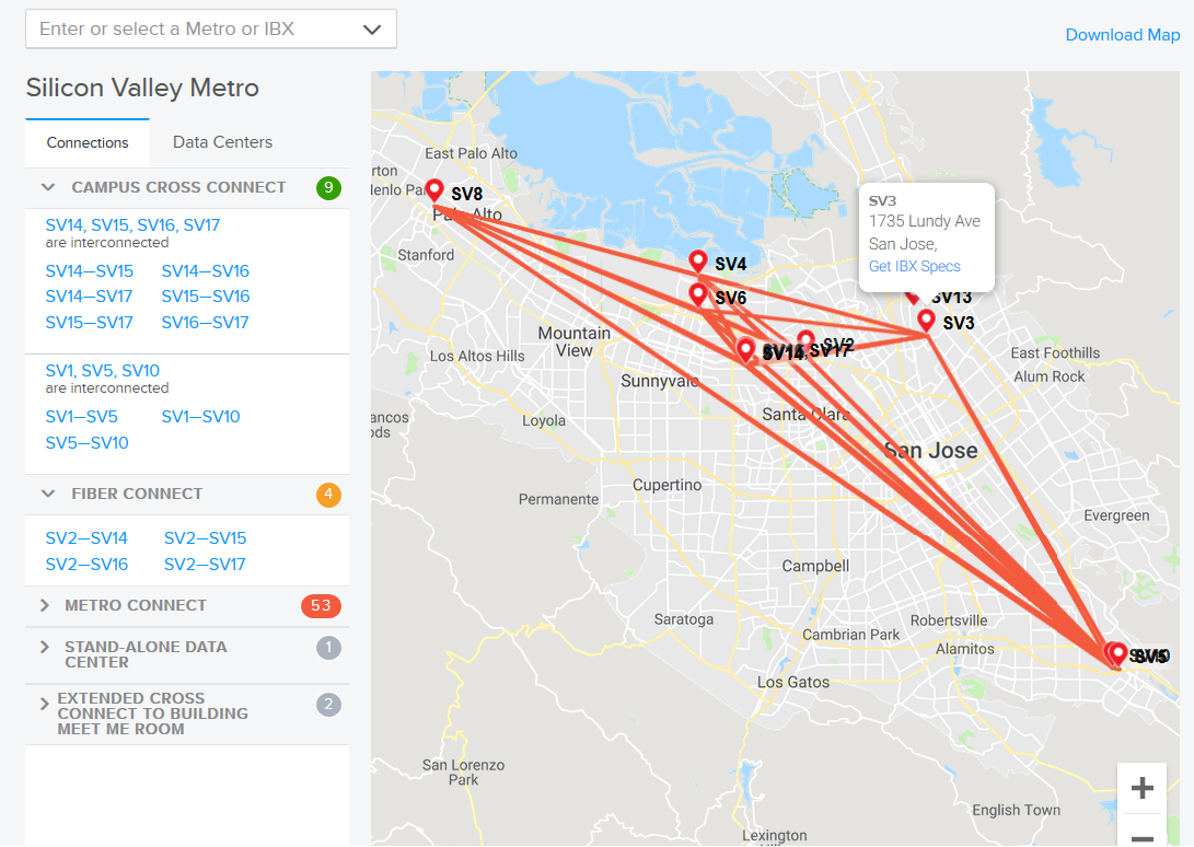

How can I use the Equinix Explorer app for Metro Connect information?
The Equinix Explorer app is available from the Equinix Marketplace Dashboard. Click the Locations & Connectivity card to launch the app.
This app provides an interactive global map to show how our IBX data centers are interconnected, including paths for Campus Cross Connects, Fiber Connect, Extended Cross Connects, and Metro Connect. Equinix Explorer also enables users to view and download IBX specification sheets.
