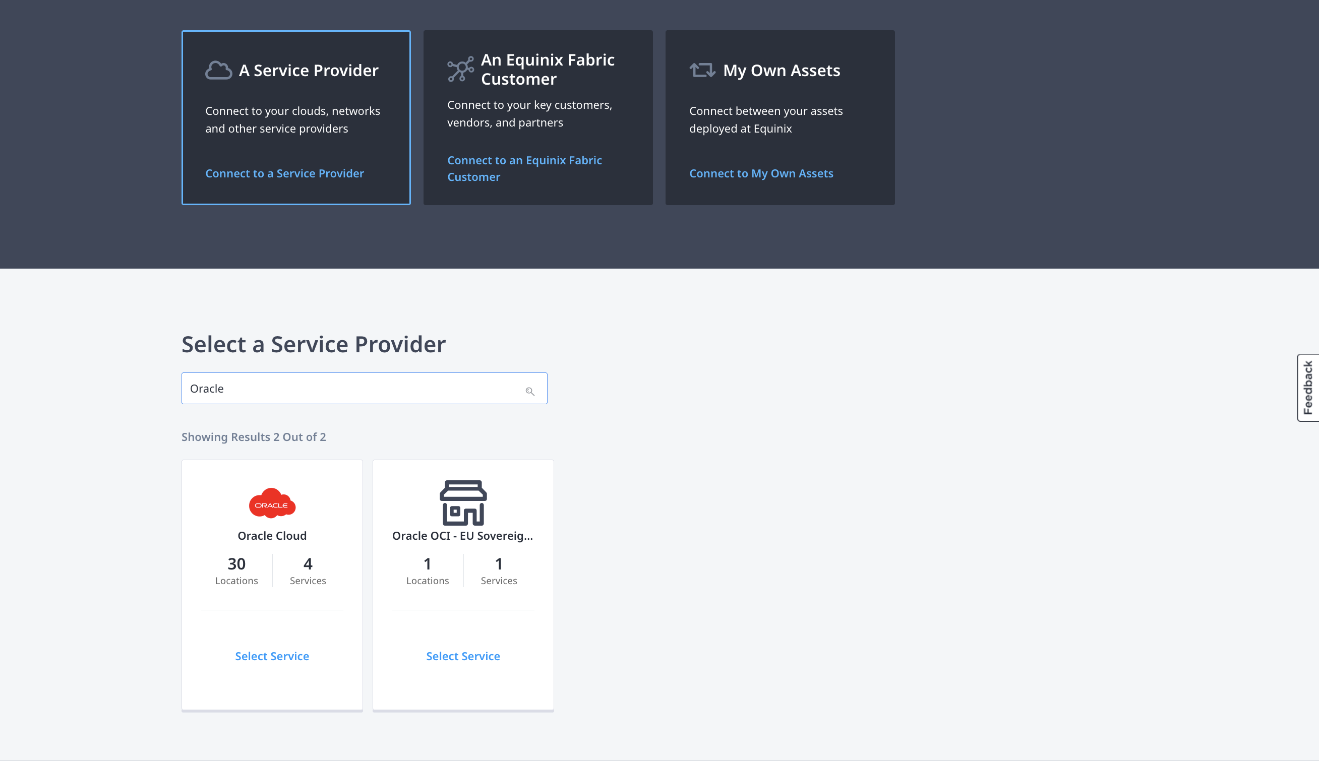

  3. From the Connections menu, select Create Connection.

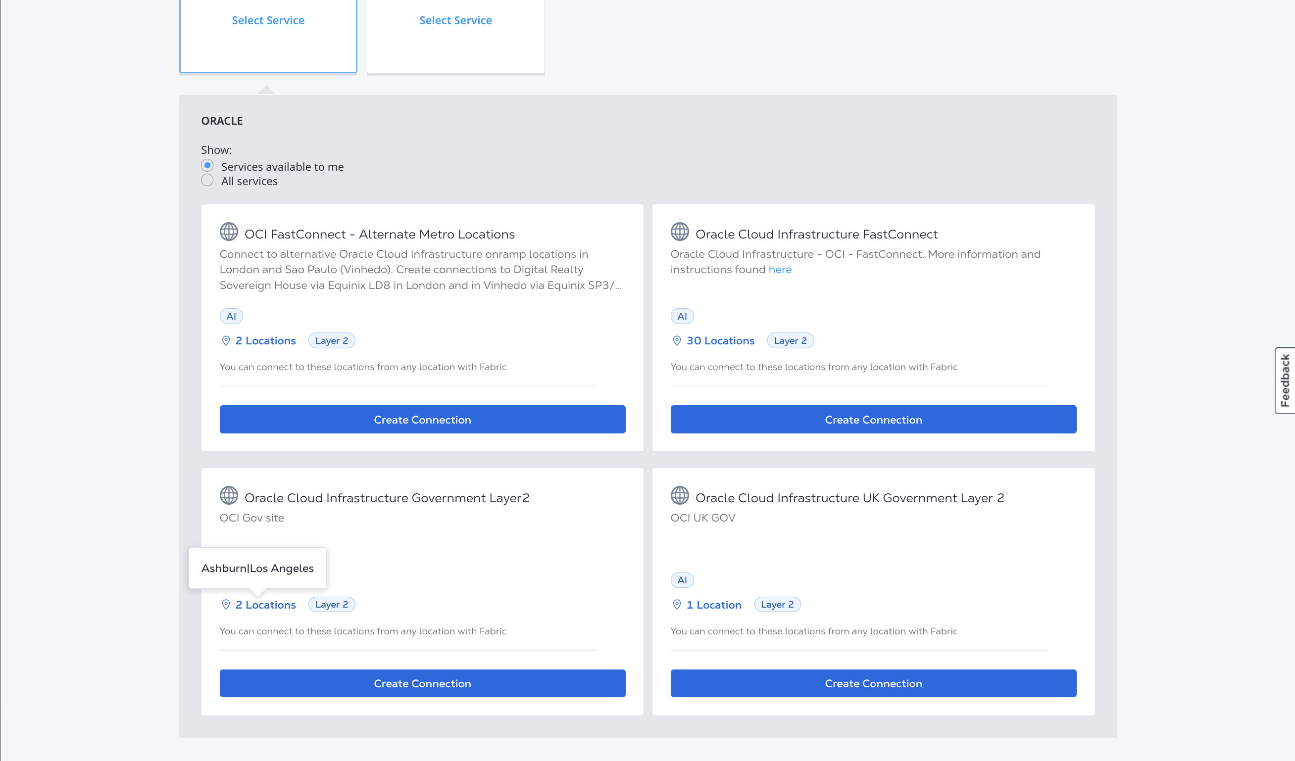

  4. In the A Service Provider card, click Connect to a Service Provider.
  5. Search for Oracle.
  6. On the Oracle Cloud card, click Select Service, then click Create Connection.

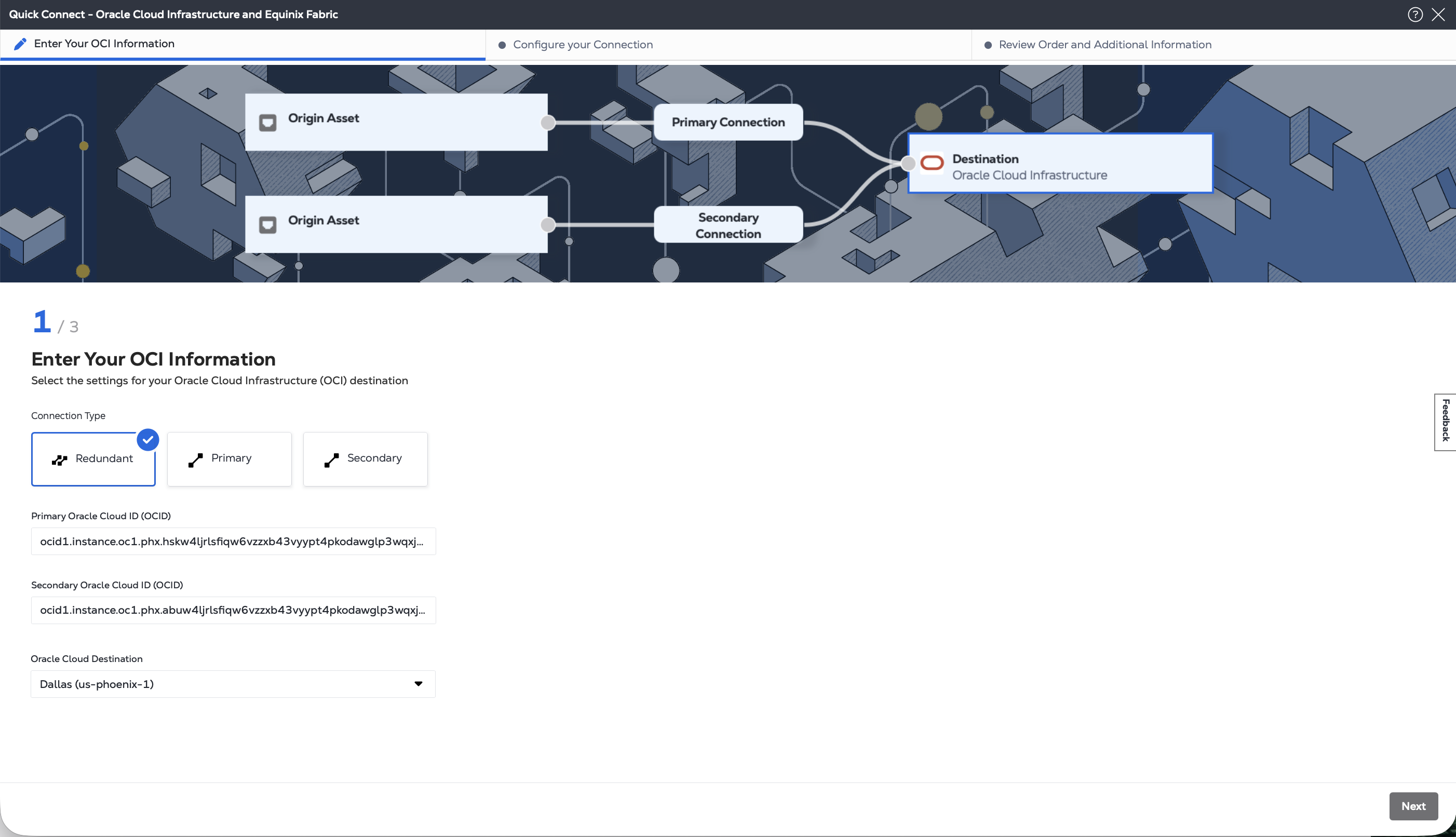

  7. Select connection type:
  • Redundant - Create a redundant pair of connections.
  • Primary - Create a single, primary connection.
  • Secondary - Create a single, secondary connection.
  1. Enter primary and secondary Oracle Cloud ID.
  2. From the Oracle Destination drop-down list, select the region and metro where your FastConnect circuits and your assets are located. Equinix Fabric Metros that have on-ramps to OCI Regions might be located in different cities. These are still considered to be local connections in Fabric.

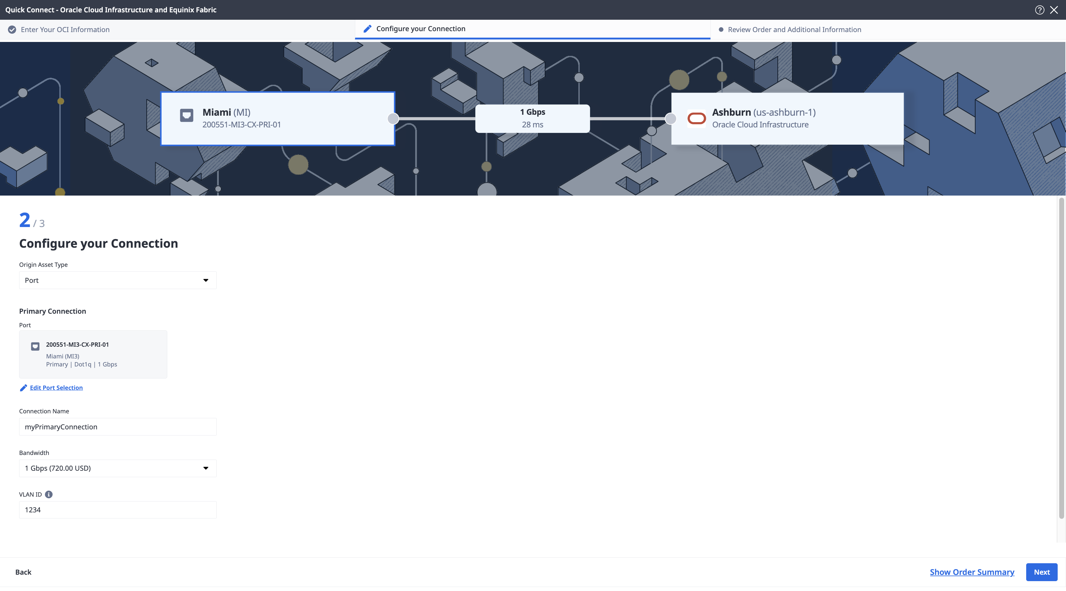

Connecting from a Port
  1. From the Origin Asset Type drop-down list, select Port.

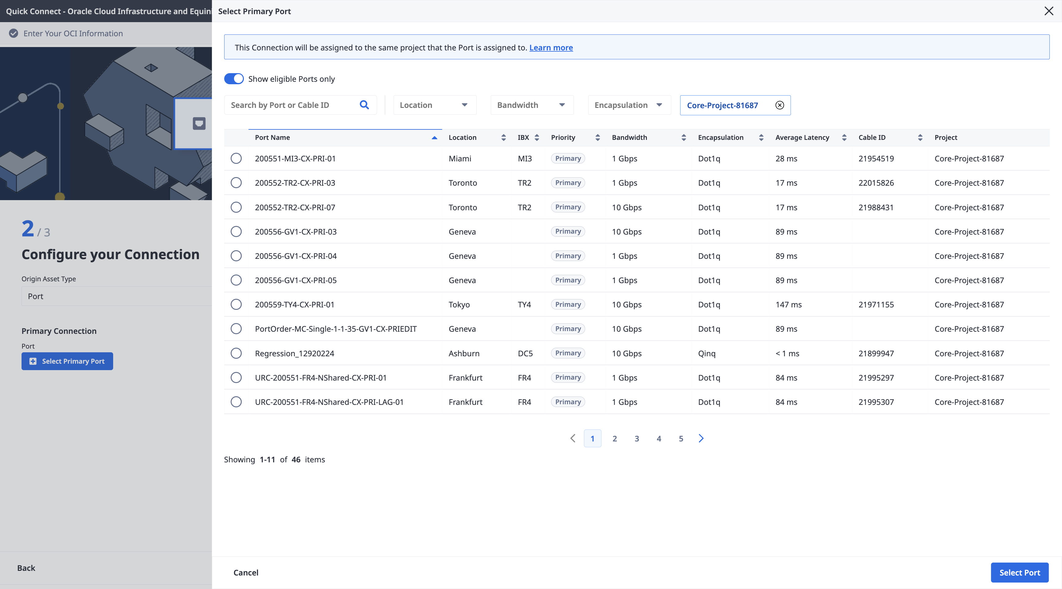

  2. In the Primary Connection section:
    • Click + Select Primary Port, then select your primary connection port and click Select Port. Only primary ports are available for selection.
    • Enter the primary connection name.
    • Select a bandwidth.
    • Enter a VLAN ID (applicable to Dot1q ports) or a Customer VLAN Tag (C-tag) and a Service VLAN Tag (S-tag) (applicable to Qinq ports).
  3. In the Secondary Connection section:
    • Click + Select Secondary Port, then select your secondary connection port and click Select Port. Only secondary ports are available for selection.
    • Enter the secondary connection name.
  4. Click Next.

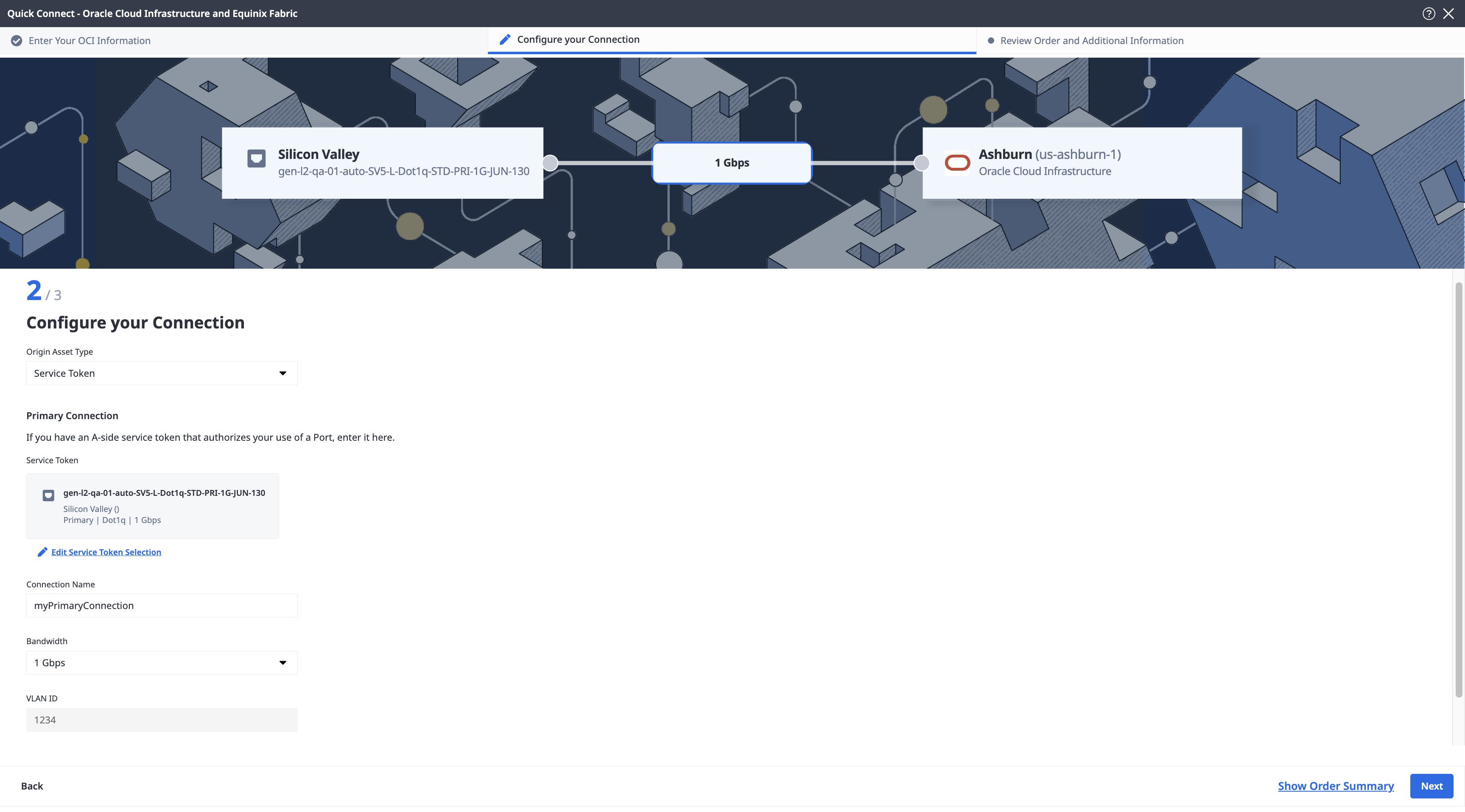

Connecting Using a Service Token
  1. From the Origin Asset Type drop-down list, select Service Token.

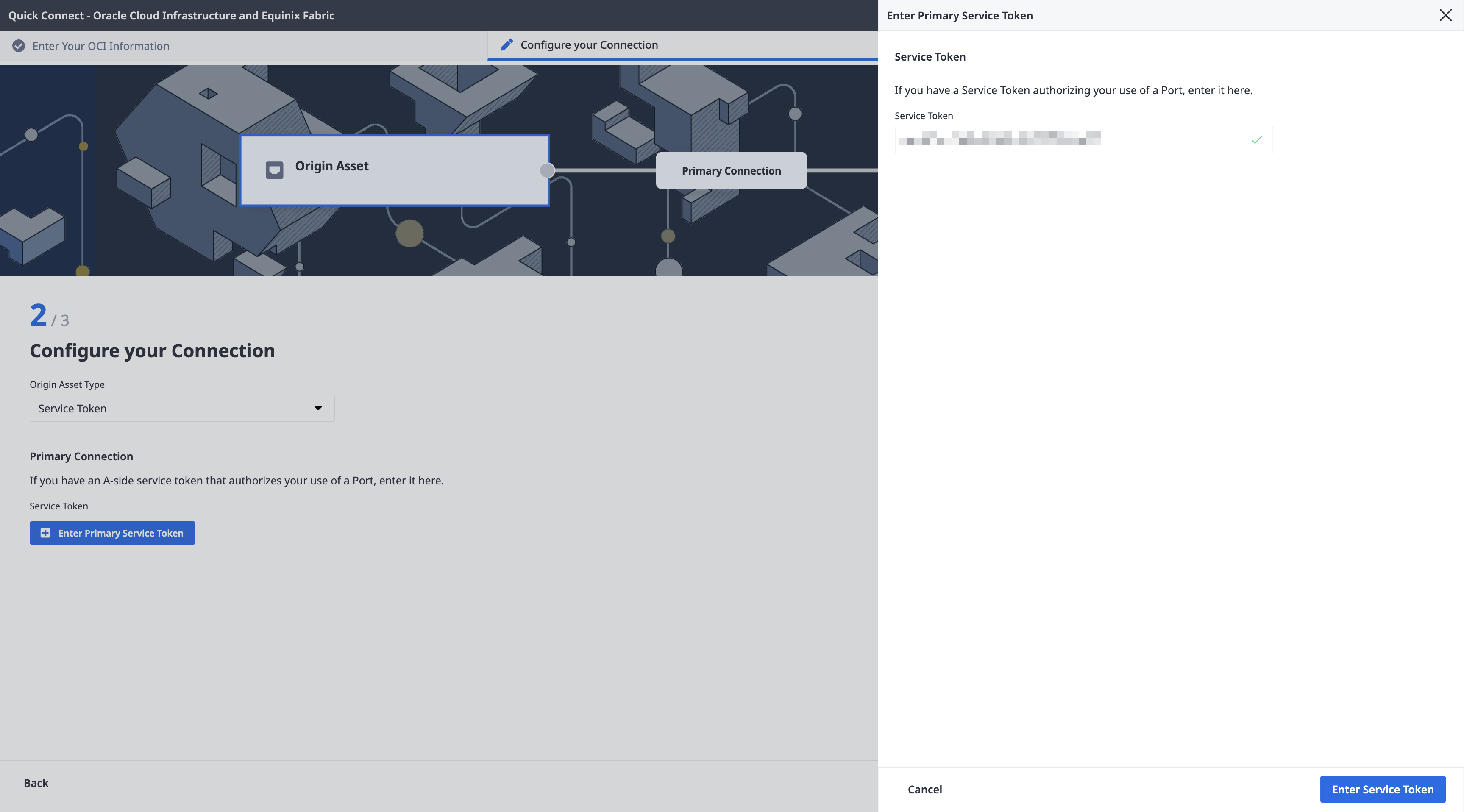

    • Click + Enter Primary Service Token, provide the service token, then click Enter Service Token.
    • Click + Enter Secondary Service Token, provide the service token, then click Enter Service Token.
  4. Click Next.

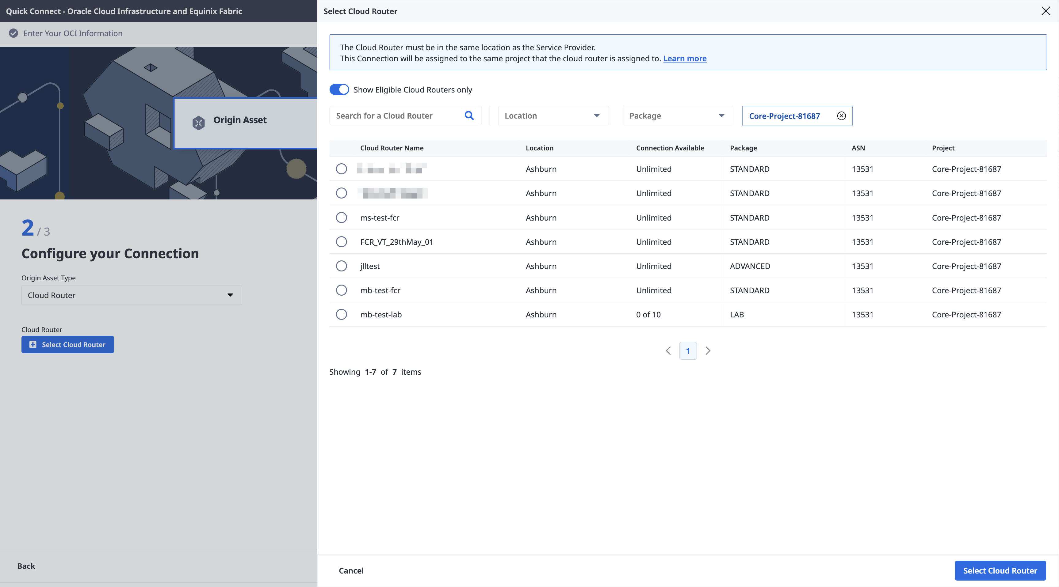

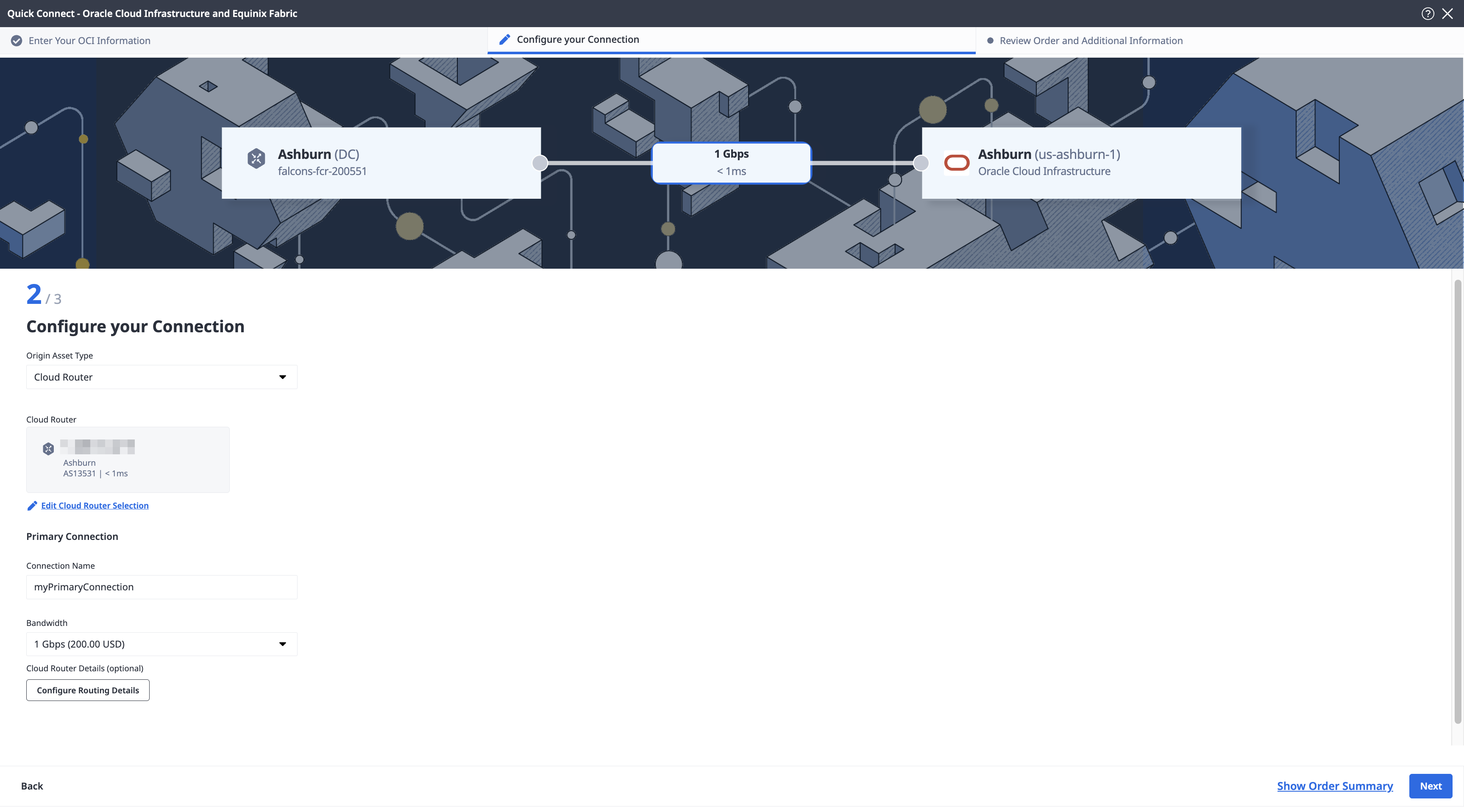

Connecting from a Cloud Router
  1. From the Origin Asset Type drop-down list, select Cloud Router.
  2. Click + Select Cloud Router, select a cloud router instance, then click Select Cloud Router.
  3. In the Primary Connection section:
    • Select a bandwidth. The bandwidth value you select will also apply to the secondary connection. Even though FastConnect OCID keys can only be created with speeds of 1 Gbps or greater, Equinix Fabric allows you to create the Fabric connection with any of the standard bandwidth tiers that are available on Fabric. If the bandwidth speed for the connection is lower than the speed of the OCID key, Fabric will rate-limit traffic to the connection speed.
  4. If you are creating a Redundant Connection, enter your secondary connection name in the Secondary Connection section. The bandwidth value you selected for the primary connection is also applied to the secondary connection.

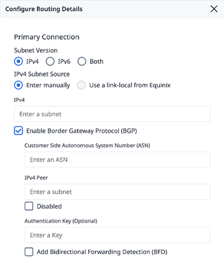

  5. (Optional) You can configure Border Gateway Protocol (BGP) routing details, or wait to configure BGP after the connection creation process is complete. Select Configure Routing Details and provide the required information. See Configure Routing Details for additional guidance.
  6. Click Next.
  7. On the Review Order and Additional Information page, review the information in the Connection Configuration sections.
  8. Use the Notifications field to provide the email addresses of the recipients to be notified about the connection's status. You can add up to 12 email addresses.
  9. (Optional) Enter or add order information in the Purchase Order section.
  10. Provide a customer reference identifier that will help you identify this order on your invoice.
  11. Click Show Order Summary to see order details and connection pricing information.
When you are ready, click Create Connection.

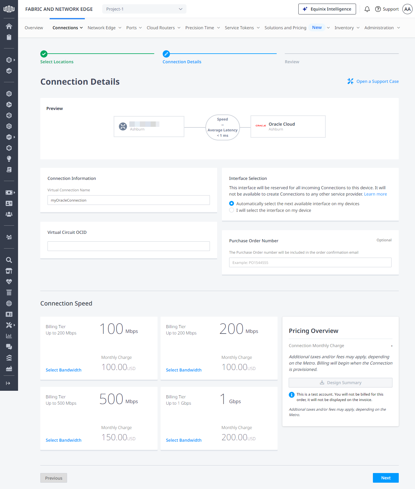

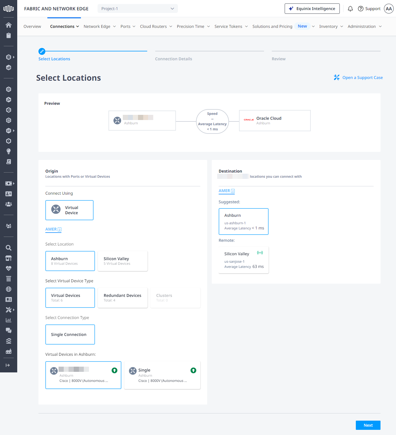

Connecting from a Virtual Device
  1. Locate the Oracle Cloud card, click Select Service, then click Create Connection (Network Edge Device).
  2. In the Origin section, click Virtual Device. If the Virtual Device option is disabled, there are no virtual devices available in the selected project. Choose a different project, that has virtual devices assigned to it, or create a new virtual device in this project.
  3. Select a Metro.
  4. Choose virtual device type, select connection type, then select a virtual device instance.
  5. In the Destination section select a metro where you want to terminate your connection, then click Next.
  6. Enter a connection name.
  7. Enter a virtual circuit identifier.
  8. Select network interface on your virtual device.
  9. Enter a purchase order number.
  10. Select connection speed, then click Next.
  11. On the Review Order and Additional Information page, review the information in the Connection Configuration sections.
  12. Use the Notifications field to provide the email addresses of the recipients to be notified about the connection's status. You can add up to 12 email addresses.
  13. (Optional) Enter or add order information in the Purchase Order section.
  14. Provide a customer reference identifier that will help you identify this order on your invoice.
  15. Click Show Order Summary to see order details and connection pricing information.
To complete your connection, you need to update the routing configuration. Note that Oracle’s ASN is 31898 which is needed when setting up the BGP peering session.
  • If you are connecting from a cloud router, configure the routing in the Customer Portal or API. Note that these configuration steps can be completed during the connection ordering process. If configured previously, you can skip this step.
  • If you are connecting from a virtual device, configure the routing on the virtual device according to the VNF's instructions and configuration settings.
  • If you are connecting from a port, configure the routing on your customer-provided equipment that is providing routing for your port.
If you created a redundant connection to Oracle Cloud, repeat the configuration on both connections.
To complete the configuration of the end-to-end connection, make the corresponding routing changes in Oracle Cloud.
