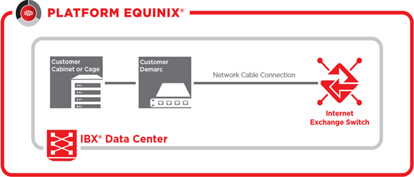

Internet Exchange
This is an efficient configuration where you are located in the same data center as the IX switch.

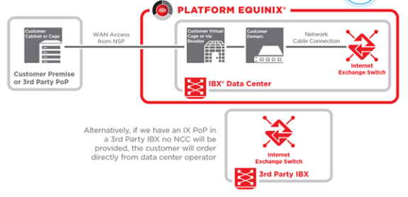

Internet Exchange Remote Port
This configuration allows you to connect remotely from your premise or a network service provider to your virtual cabinet or cage in an Equinix IBX.

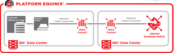

Internet Exchange Metro Port
This configuration allows you to connect to the IX switch through a Metro Connect or Metro Connect circuits.

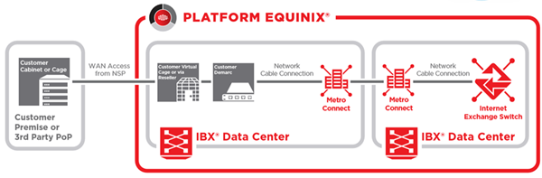

Internet Exchange Metro Remote Port
This configuration allows you to reach the IX switch located in another IBX. To reach that switch, an additional metro connect circuit is required between the two Equinix IBXs.

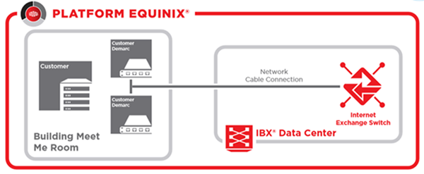

Internet Exchange Extended Port
This configuration is used to connect from the third party premise through a BMMR to an IBX within the building.

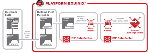

Internet Exchange Extended Metro Remote Port
This configuration uses a BMMR, Metro Connect circuit, and remote location options to reach the IXswitch.
