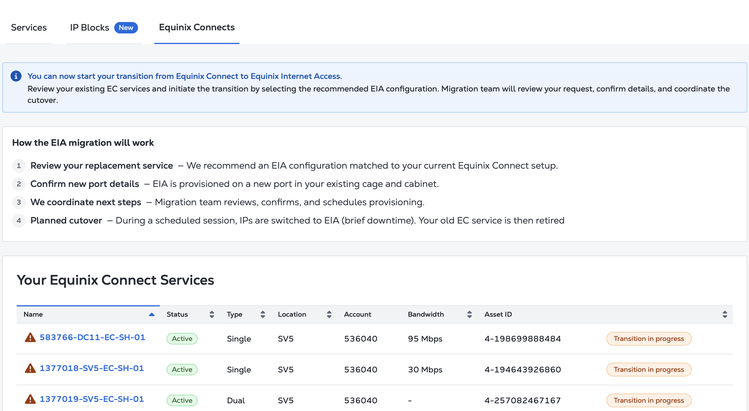

Migrating from Equinix Connect to Internet Access
Selected beta customers can now start their migration from Equinix Connect to Internet Access in the Customer Portal. Submit a migration request for a recommended Internet Access configuration based on your current Equinix Connect setup. You can review and adjust your migration request before submitting.
Submitting creates the migration request for Equinix review. It does not immediately move live traffic, disconnect the existing Equinix Connect service, or perform the cut-over. Your current Equinix Connect service remains active while Equinix reviews, provisions, and coordinates the transition.

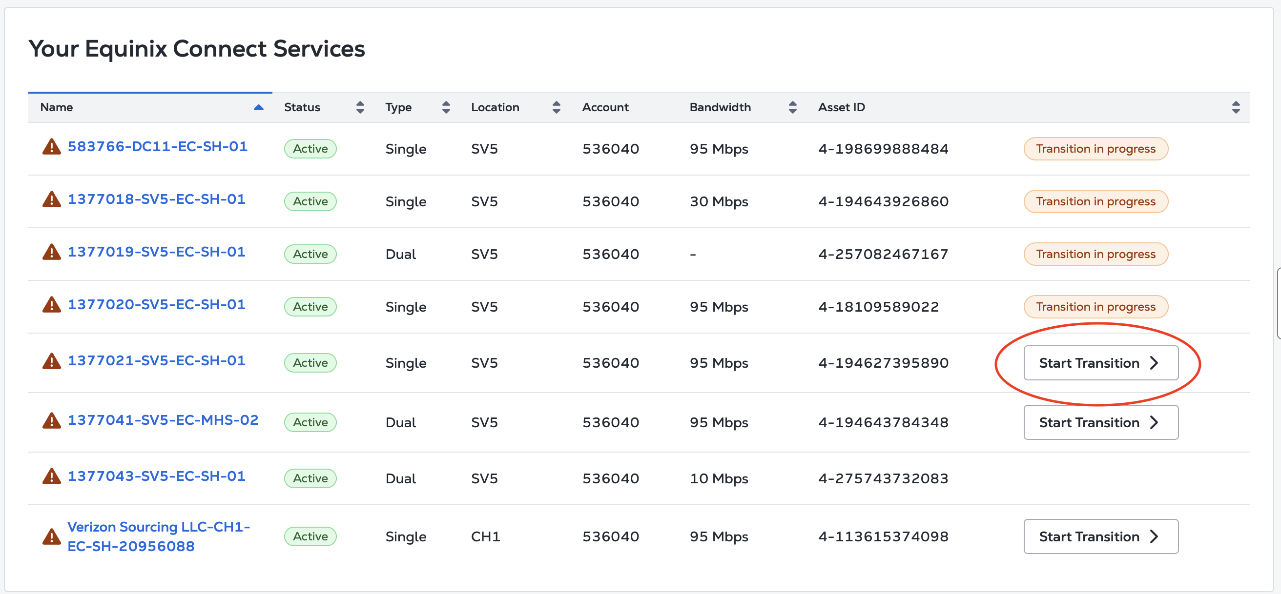

Choose the Service to Migrate
Sign in to the Customer Portal and navigate to Internet Access.
Click Equinix Connect. The table lists your current Equinix Connect services.
Validate the service name, location, bandwidth, and UUID before starting the transition to ensure you are working on the correct service. When you identify the Equinix Connect service you want to migrate, click Start Transition.

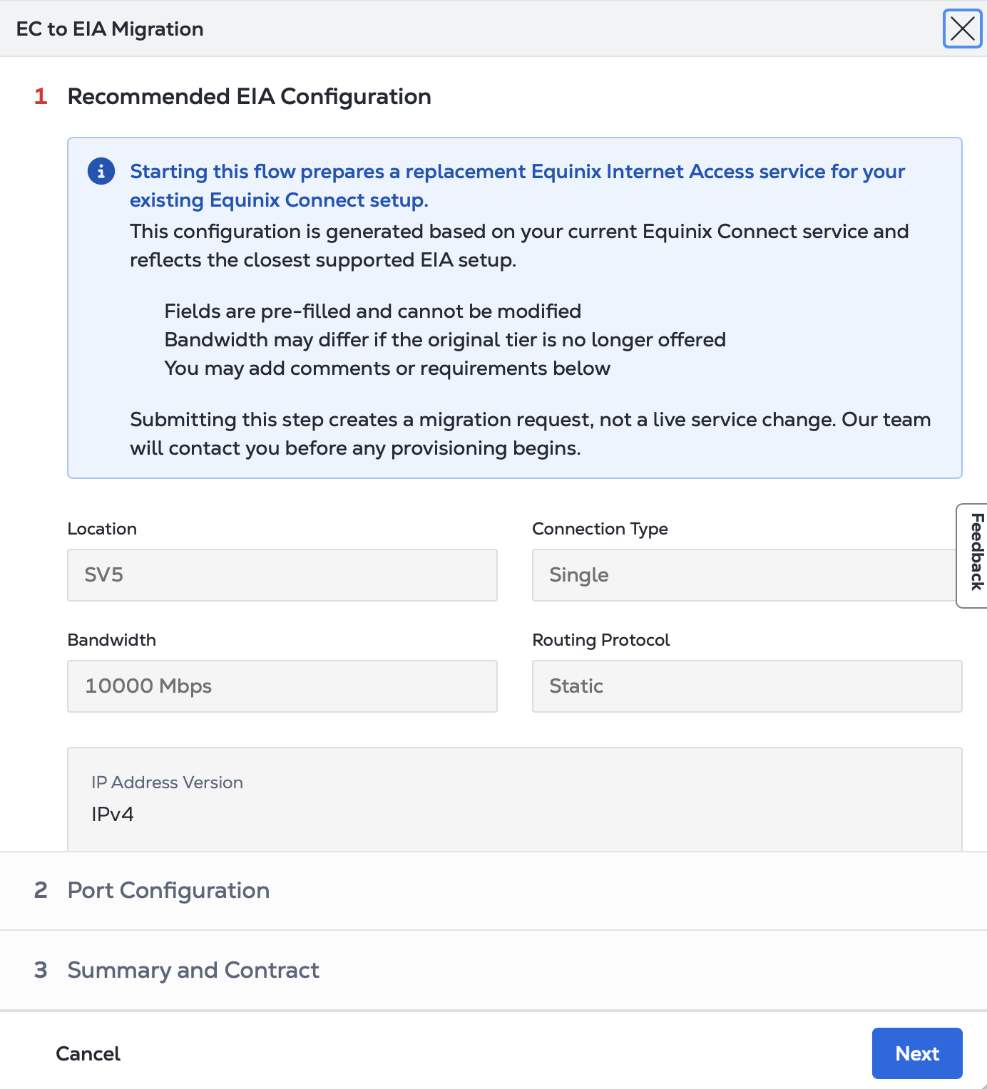

Review the Internet Access Configuration
The portal generates a configuration based on your current Equinix Connect setup and maps it to the closest supported Internet Access configuration. Some information is pre-filled and may not be editable because it is derived from the existing service and the supported Internet Access product model.
Review the following fields carefully:
- Location - Where the replacement Internet Access service will be delivered.
- Connection Type - Whether the replacement service is Single or Dual.
- Bandwidth - The recommended Internet Access bandwidth tier. If the bandwidth changes, for example from 95 Mbps to 100 Mbps, this usually means the Equinix Connect bandwidth tier is no longer offered and has been mapped to the nearest supported Internet Access tier.
- Routing Protocol - The routing model, such as Static or BGP.
- IP Address Version - Either IPv4 and/or IPv6.
- Subnets - The customer IP subnets associated with the service.
If the configuration is acceptable, click Next.

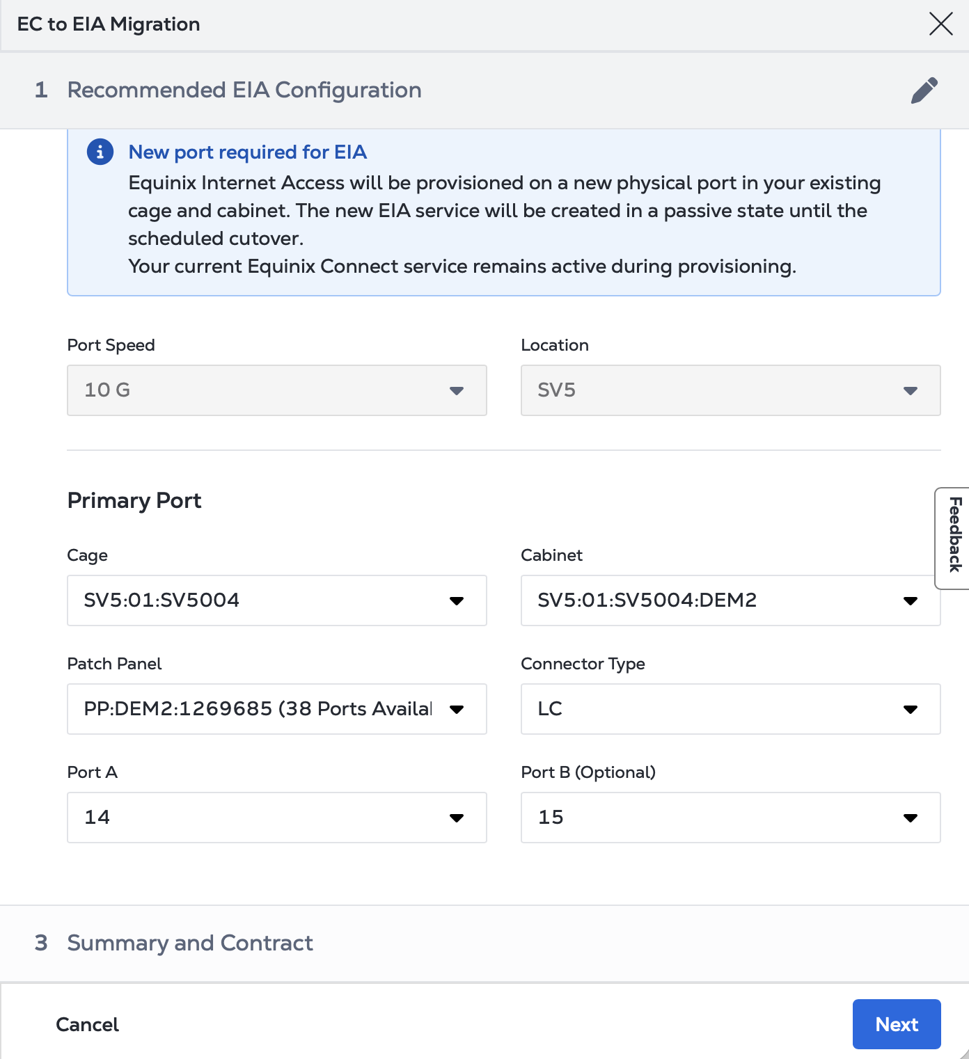

Confirm the Port Configuration
Provisioning Internet Access requires a new physical port. Equinix prepares the replacement Internet Access service on a new physical connection in your existing cage and cabinet rather than modifying the active Equinix Connect service in place.
Complete or confirm the port details:
- Port Speed - Select the physical port speed for the new Internet Access service.
- Location - Confirm the Equinix location where the service will be delivered.
- Cage - Select the cage where the new connection should be provisioned.
- Cabinet - Select the cabinet where the new connection should terminate.
- Patch Panel - Select the patch panel, if required.
- Connector Type - Select the applicable physical connector type.
- Port A / Port B - Select the port details. For redundant or dual designs, more than one port may be required.
Accurate physical port information allows Equinix to deliver the new Internet Access service to the correct location in your environment. Incorrect cage, cabinet, patch panel, connector, or port information can delay provisioning.
Click Next.

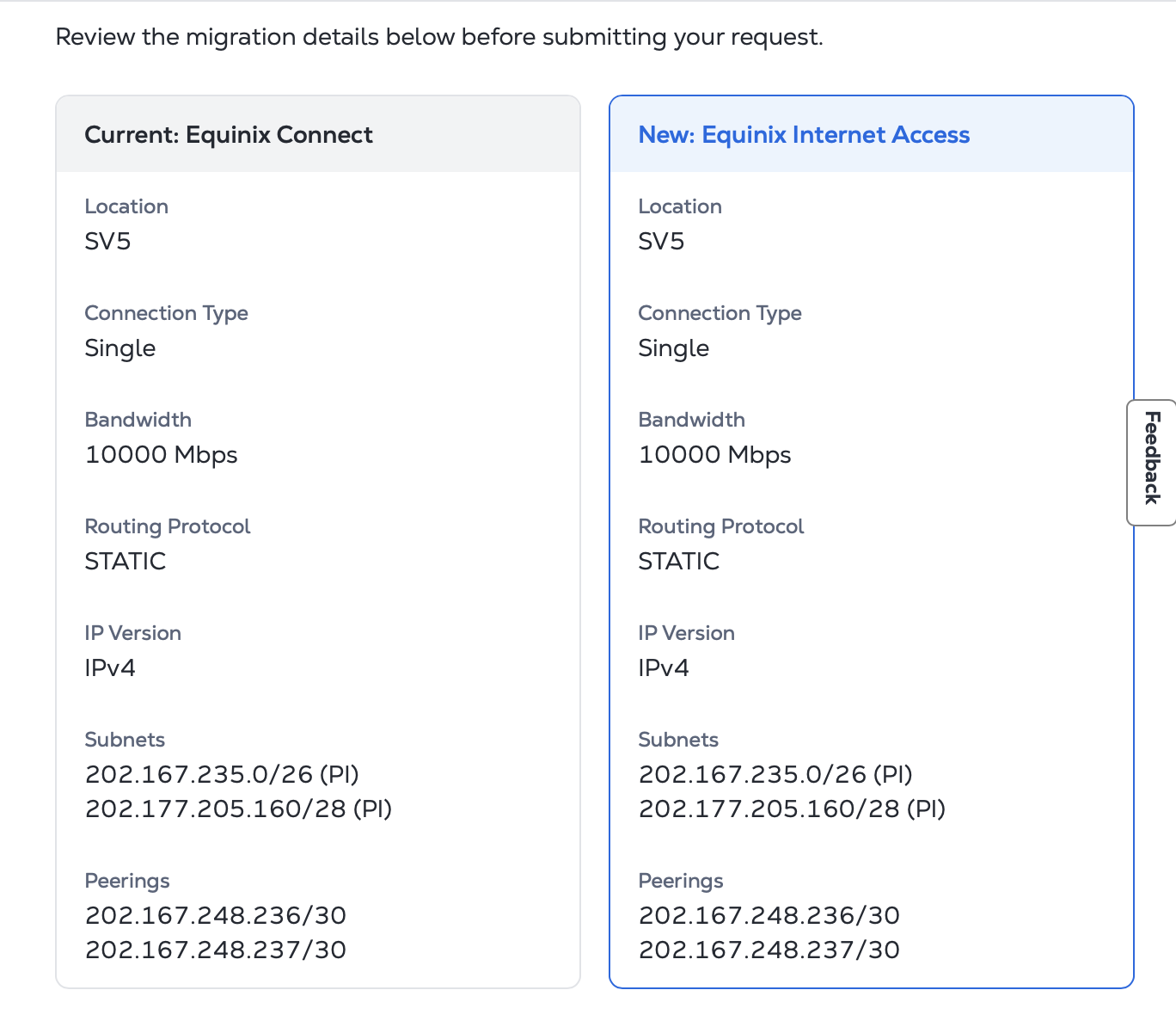

Review the following information before submitting your request:
Review the migration details. The portal presents a side-by-side comparison of the current Equinix Connect service and the new Internet Access service. Updated items are highlighted in the summary. For example, if bandwidth is updated to a supported Internet Access tier, the new bandwidth value may be highlighted with a message indicating that the bandwidth has been updated to the new configuration.
Review the Notification contacts. Your account is assigned as the primary technical contact. If another person in your organization should receive updates or coordinate the technical migration, use Assign a different technical contact drop-down to add a contact.
Use the Additional Notes field to add any details, requirements, or constraints to your migration request.
After reviewing the summary, contract information, notifications, and technical contact, click Submit Migration Request.

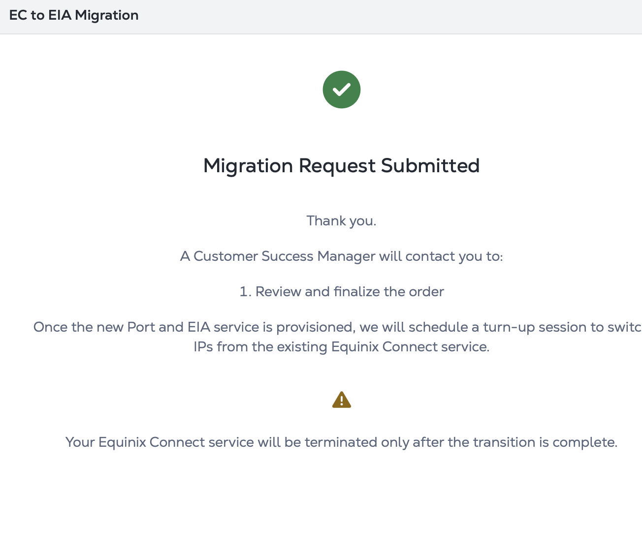

Submitting the request sends the migration request to the Equinix Migration Team for review. It does not immediately migrate or interrupt the service. Equinix will review the submitted information, confirm details if required, and coordinate the next steps with your organization.
Next Steps
After submission, the expected process is:
Equinix reviews the submitted migration request and validates the recommended Internet Access configuration and physical port details. If clarification is required, Equinix contacts the provided technical contact.
Equinix provisions the new Internet Access service, typically in a passive state. The existing Equinix Connect service typically remains active while the replacement Internet Access service is being provisioned. This approach allows Equinix and the customer to prepare the target service before the planned cut-over.
Your technical contact and Equinix agree on a planned cut-over window. During the scheduled cut-over, production traffic is moved from Equinix Connect to Internet Access. Traffic and IP usage are switched to Internet Access.
After successful validation, the legacy Equinix Connect service is retired.
