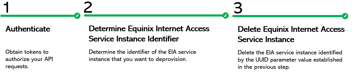

Prerequisites​
  1. Authenticate - Submit your user credentials, Client ID, and Client Secret for OAuth2 authentication. Refer to API Authentication for instructions on how to call the OAuth API to validate and authenticate your credentials.
  2. Use the Search Internet Access Services endpoint to determine the ID of a service instance that you want to deprovision.
Deleting an Internet Access Service Instance​
To delete an Internet Access service instance, send a DELETE request to the internetAccess/v2/services/{id} endpoint.
