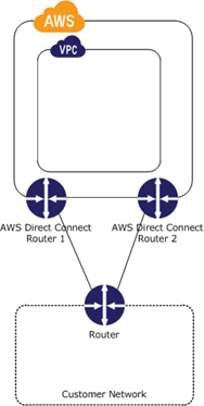

Connection Redundancy Options
Equinix and Amazon Web Services (AWS) offers customers the ability to achieve highly resilient network connections between Amazon Virtual Private Cloud (Amazon VPC) and their on-premises infrastructure.
To configure redundancy, a second Direct Connect link must be created by repeating the same steps described above. Redundancy should be created over a second port into the Equinix Fabric.
To achieve high availability with AWS Direct Connect, each Virtual Private Gateway (VGW) should be configured with connections to multiple Direct Connect locations.
For more information on configuration, see AWS Direct Connect Resiliency Recommendations.

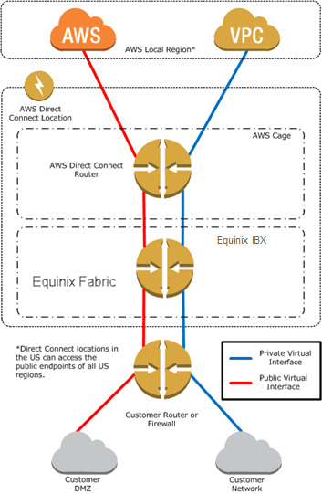

Establish a direct, layer 2 connection between your IBX colocated assets and your Amazon Web Services (AWS) resources using Equinix Fabric and AWS Direct Connect.
Equinix Fabric enables you to connect from your a-side:
  • Fabric Port
  • Network Edge Device
  • Fabric Cloud Router
  • Service Token
To your z-side AWS VPC through AWS Direct Connect.
Options for creating the connection include:
Configuring the Connection
Virtual Interface (VIF) is the mechanism for configuring VLAN's and routing (BGP) between the customer edge device and the AWS device.
There are two kinds of VIFs: Public and Private.
For more information, see AWS DX Virtual Interfaces.
After you create and accept the connection, the last step is to configure the routing between Equinix and AWS.
