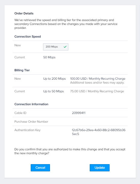

  5. In the Overview tab, click Change next to the bandwidth information.
    remarque
    The notification icon next to the speed indicates that the speed in the Azure portal and the speed in the Equinix Customer portal are out of sync.
  6. Click Update to confirm the connection bandwidth change.
remarque
Traffic continues to flow at the previous lower speed when the bandwidth upgrade is being configured until the upgrade on both the A-side (Equinix) and Z-side (Azure) of the circuit is successfully completed.
