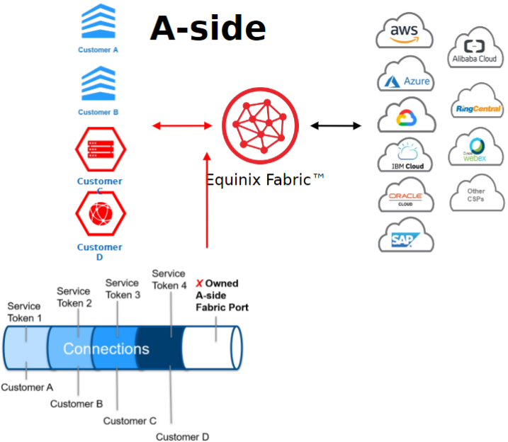

A-Side Service Tokens
If you want a customer to connect to a service provider on Equinix Fabric using your port, create an A-side service token.
A-side tokens authorizes use of your Equinix Fabric port by another entity (typically your customer) to connect to cloud providers, network providers, or any other Equinix Fabric participant. The owner of the port, not the customer, is billed for the provisioned virtual connection. A-side service tokens are redeemed during the Create Connection process.
A-side tokens give control of the virtual connection to your customers, allowing them to connect to any available service provider on Fabric from your port. It enables aggregated use of your A-side Fabric port and eliminates the need for you, the provider or reseller, to understand or be aware of unique requirements per provider.
