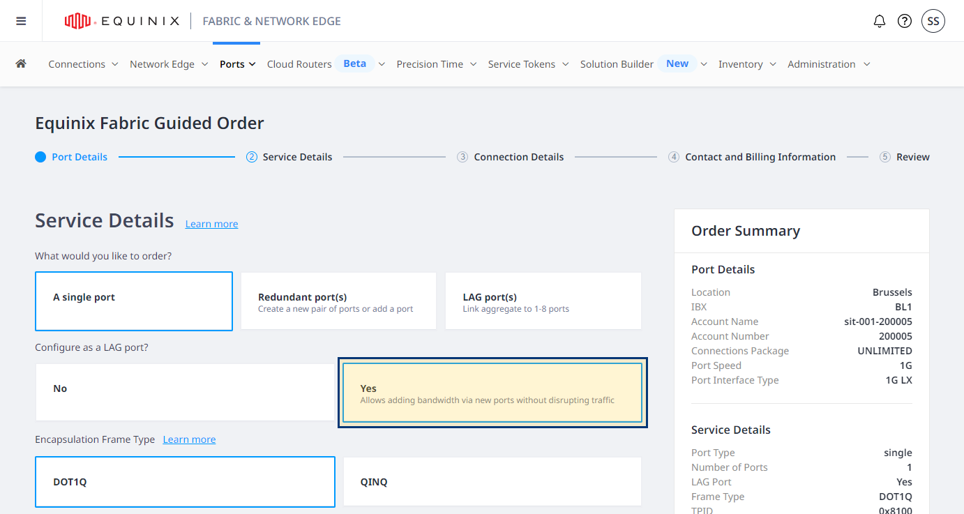

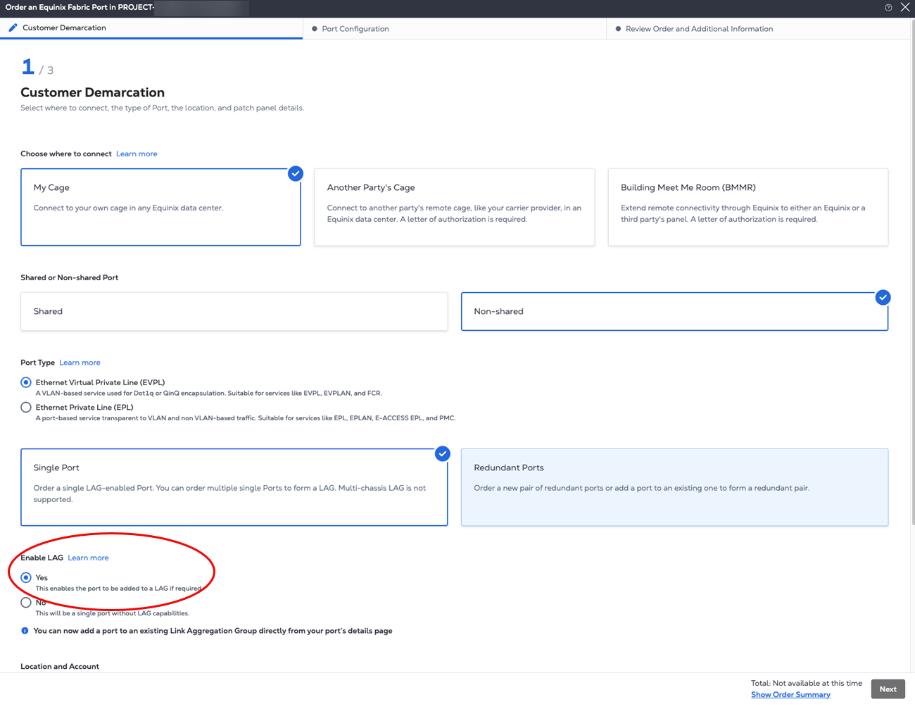

Upgrade from a Non-LAG to a LAG Port​
To upgrade from a non-LAG port to a LAG port:
  1. Sign in to the Customer Portal.
  2. Order a new Fabric port with the LAG option enabled.
  3. Migrate your virtual connections from the old port to the new port:
  4. Delete the old port or open a Support Case with a request to have it deprovisioned.
