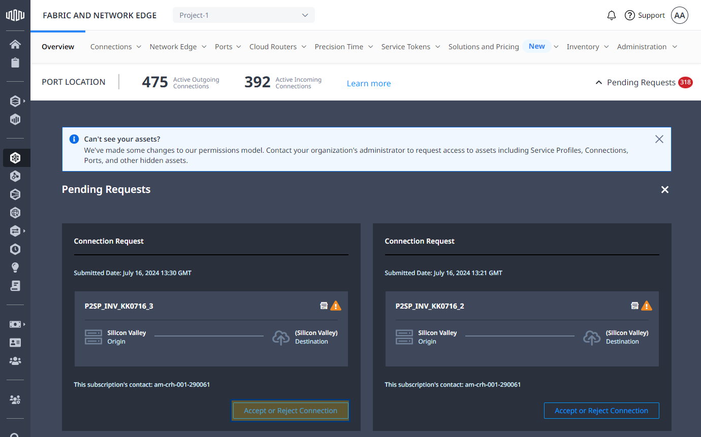

  3. On the Overview page, click Pending Requests.

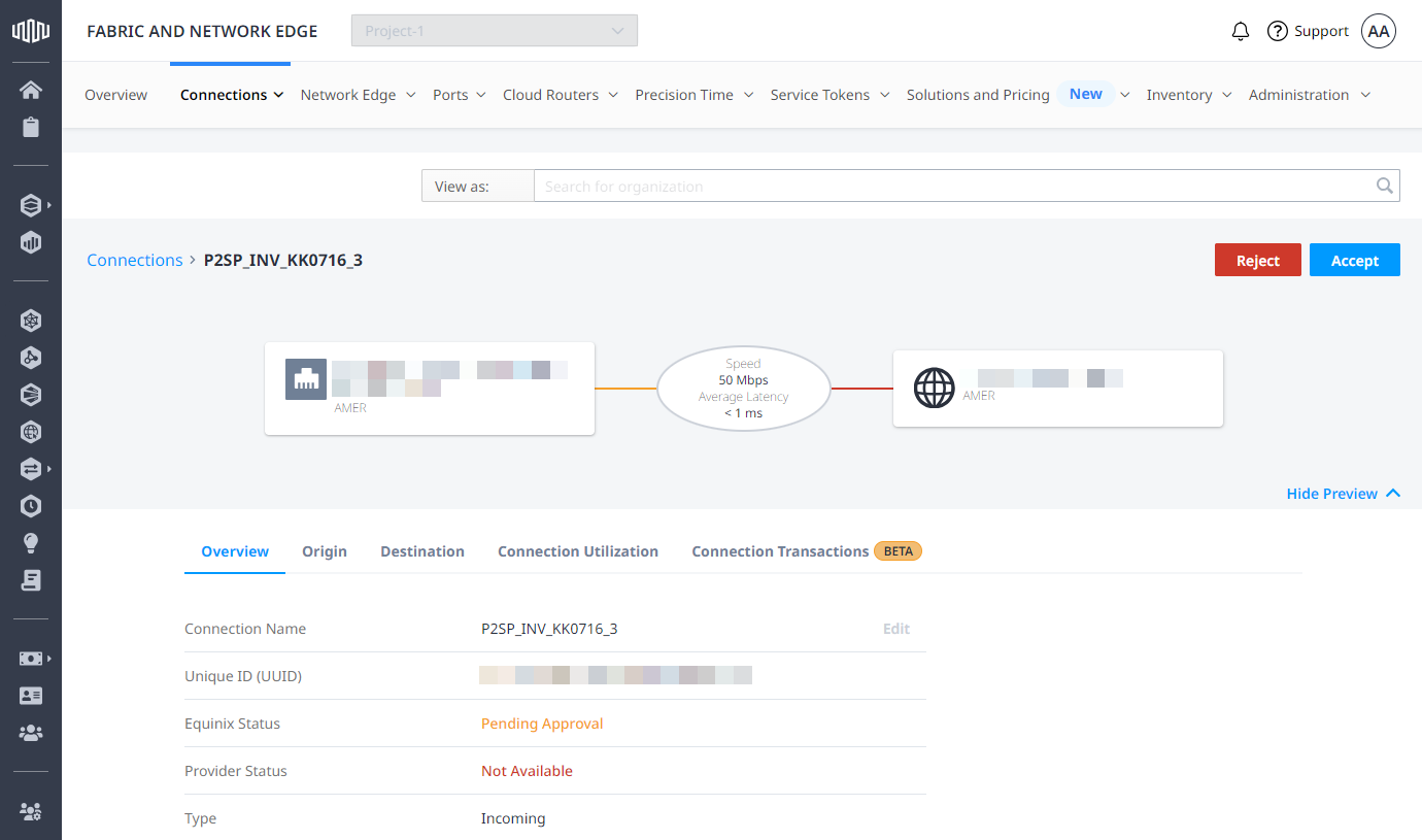

  4. Locate the connection request you want to manage and click Accept or Reject Connection.

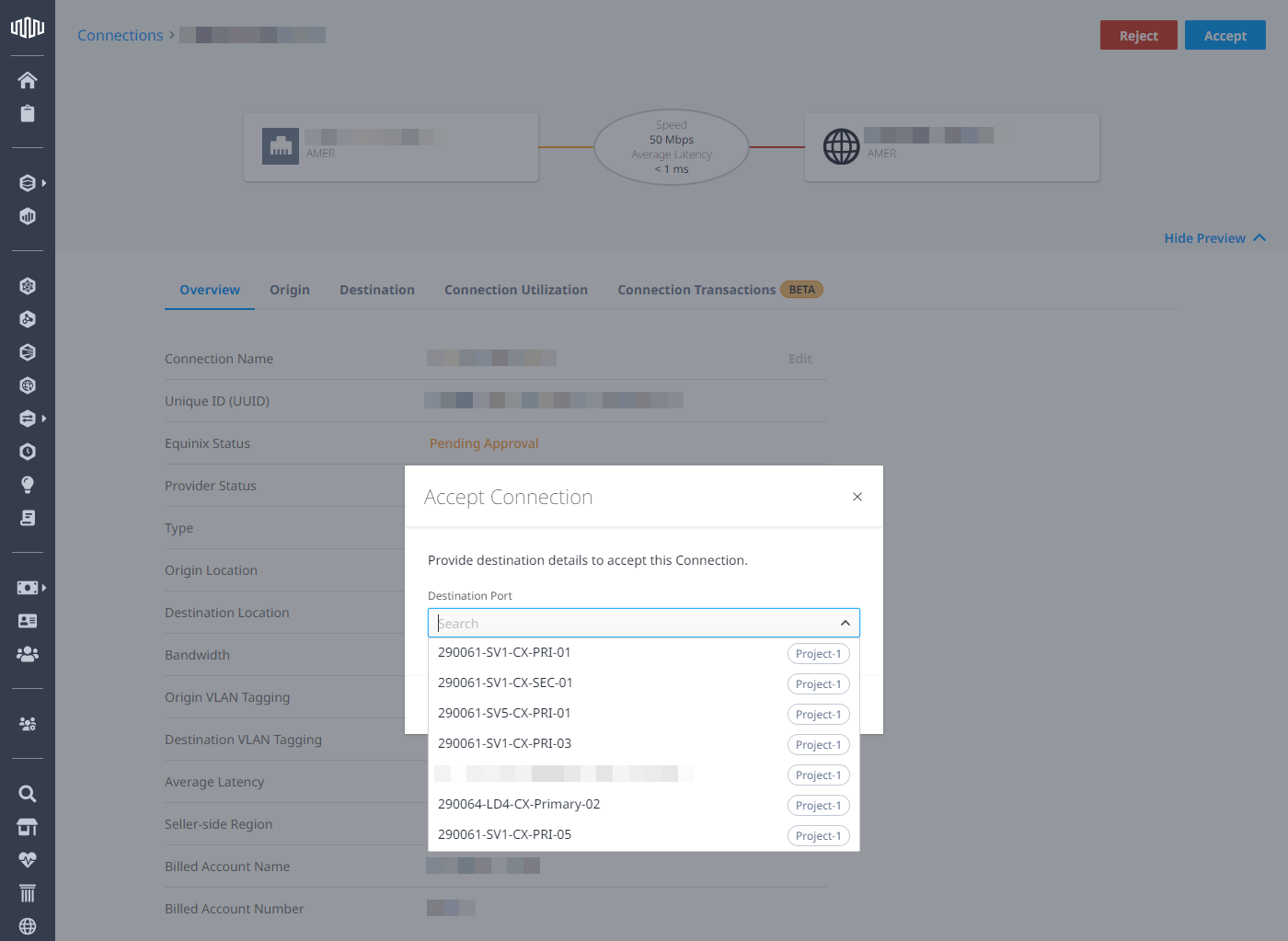

  5. Click Accept.
  6. From the Destination Port drop-down list, select the port you want to terminate this connection at, then click Submit.
    Destination ports list contains ports, assigned to different projects, that you've been given access to. If you select a port in a different project, the connection will be associated with the project that the port has been assigned to.
  7. Click Confirm.

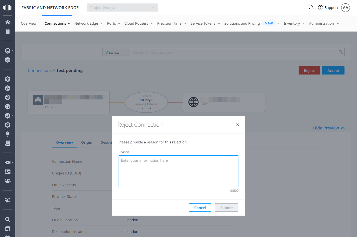

Reject Connection Request
To reject a connection request:
  2. Use the Project Selector dropdown box at the top of the screen and select the project to view pending connection requests associated with project-specific assets. For more information on projects, see Equinix Identity and Access Management: Projects.
    tip
    You can also filter out pending connection requests in the Connections Inventory.
  5. Click Reject.
  6. Enter the reason why you reject this connection request, then click Submit.
