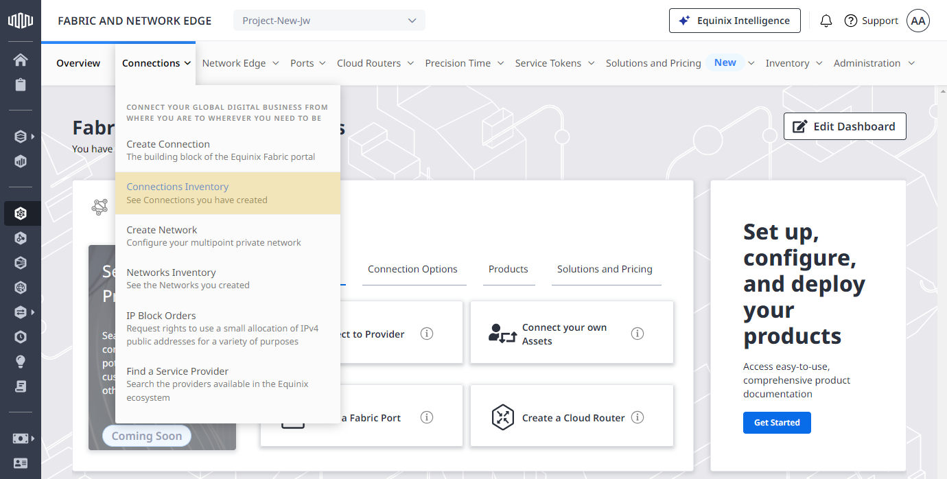

  2. From the Connections menu, select Connections Inventory.

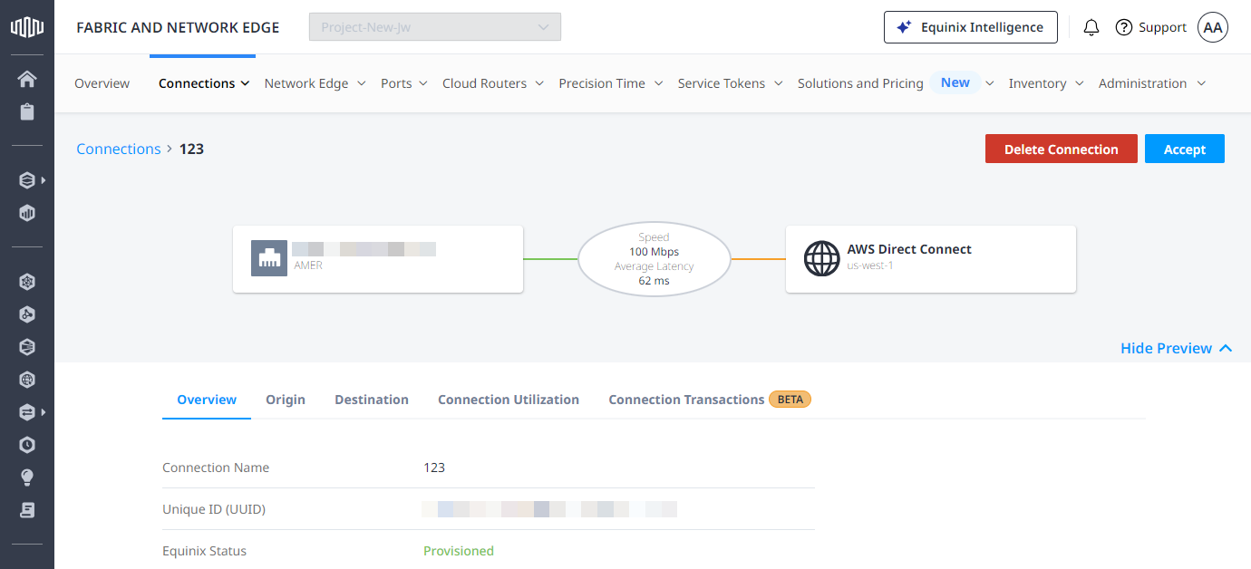

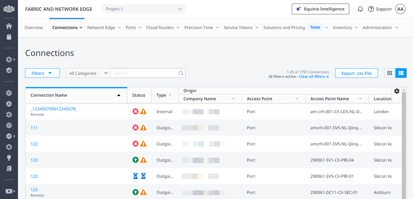

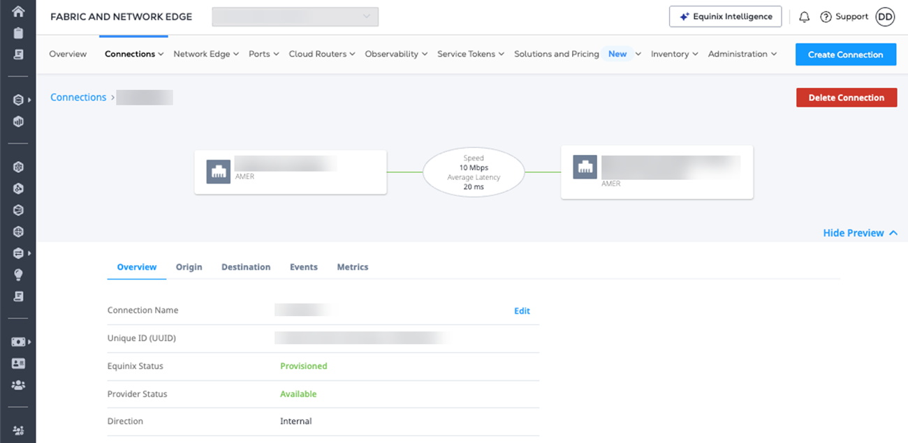

  3. Locate and click the connection you want to delete.
  4. Click Delete Connection.

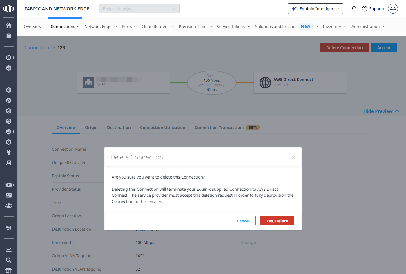

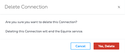

  5. Click Yes, Delete to confirm.
A message will display at the top of the page indicating the connection was successfully deleted. You will also receive an email confirming the deletion.
