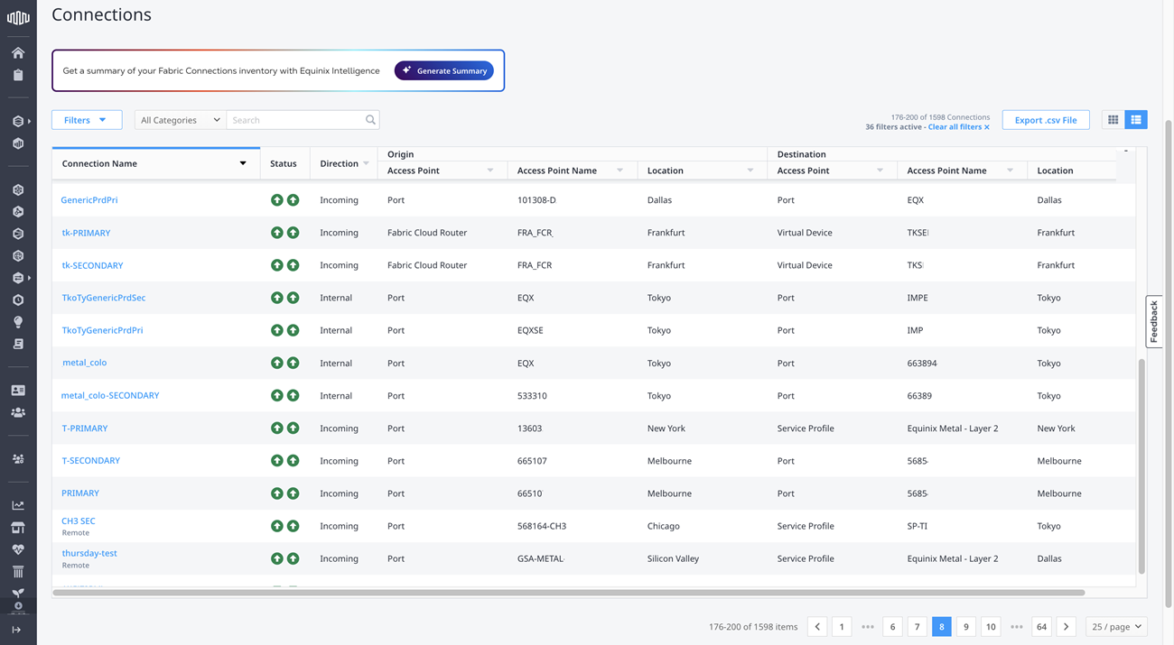

  2. From the Connections menu, select Connections Inventory.

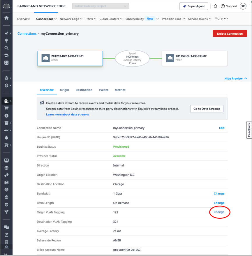

  3. Locate and click the connection you want to edit.
  4. Click Change next to the origin VLAN.

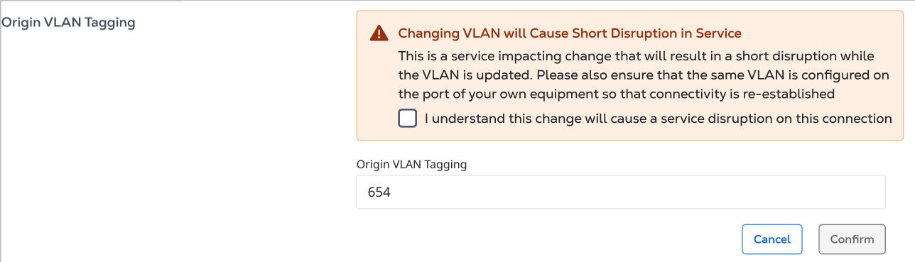

  5. Enter the new value for the VLAN and select I understand this change will Cause Short Disruption in Service.
    Confirmation
  6. Click Confirm.
