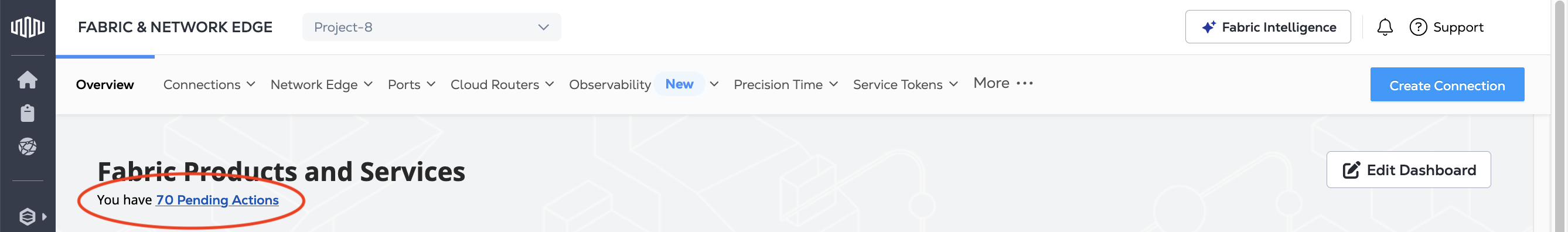

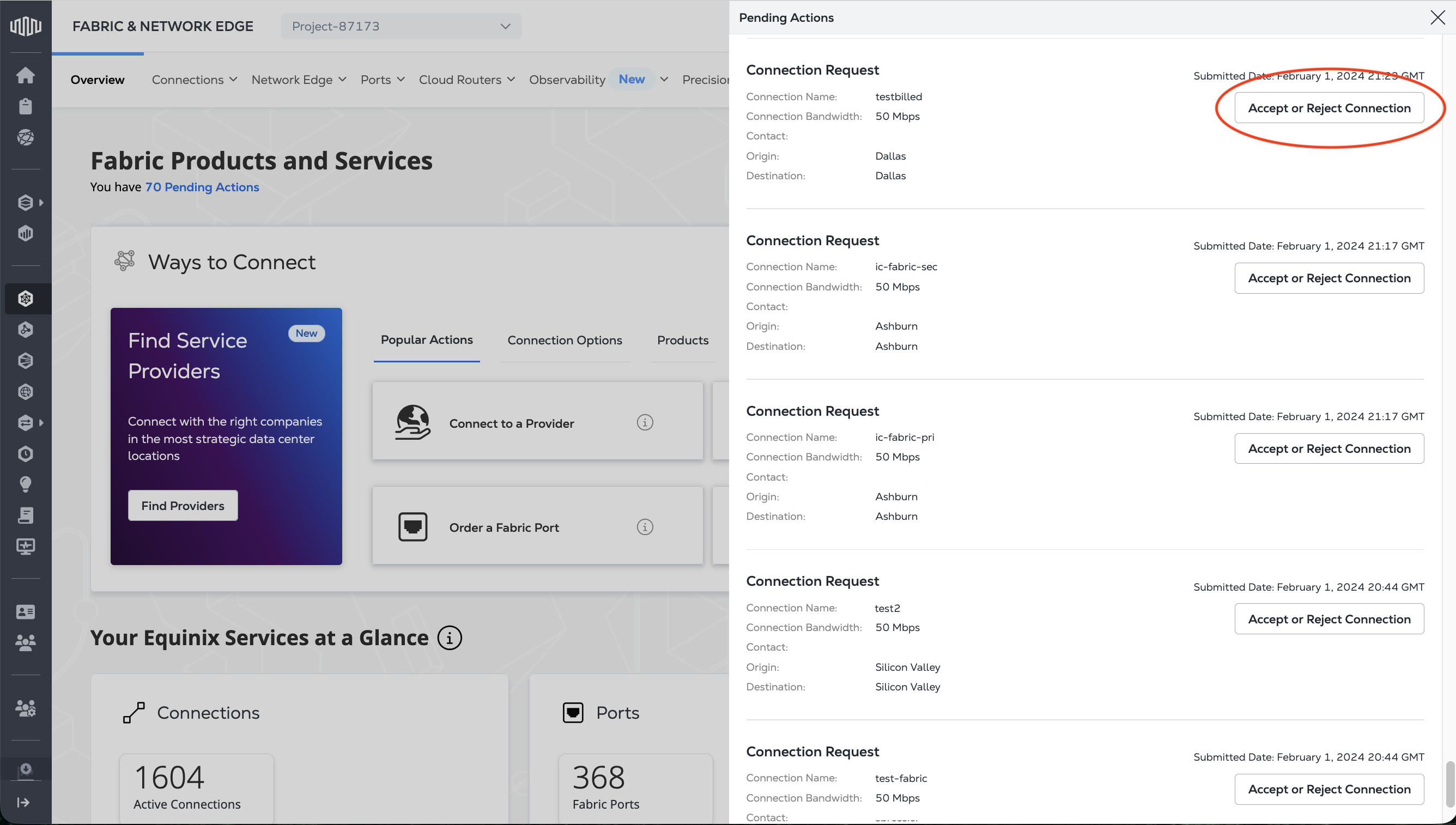

Sign in to the Customer Portal and go to Fabric.
Use the Project Selector drop-down to select the project to view pending connection requests associated with a specific project. For more information on projects, see Managing Projects.

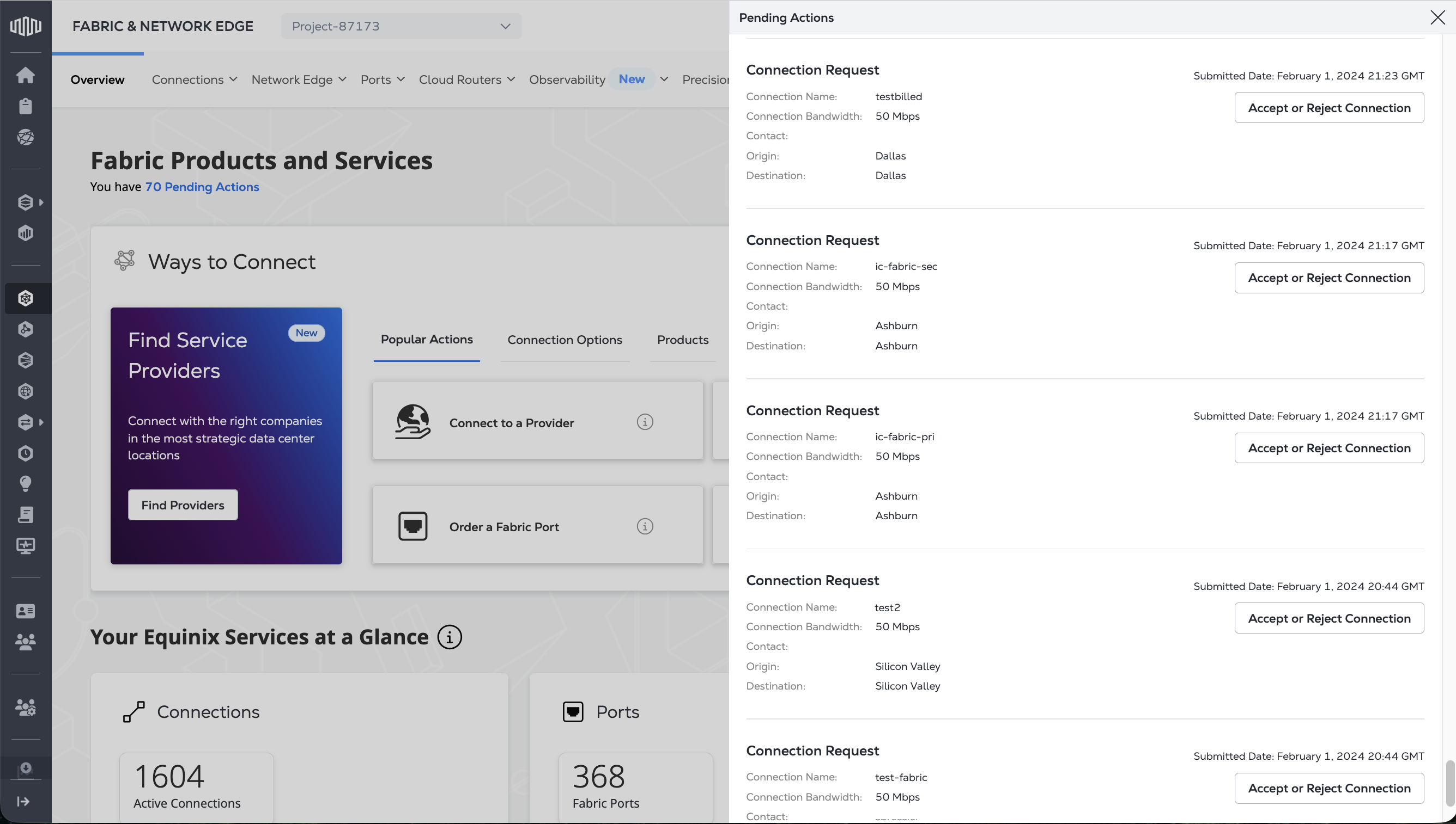

On the Overview page, click Pending Requests.
The Pending Actions panel displays connections that need approval.
You can also filter out pending connection requests in the Connections Inventory.

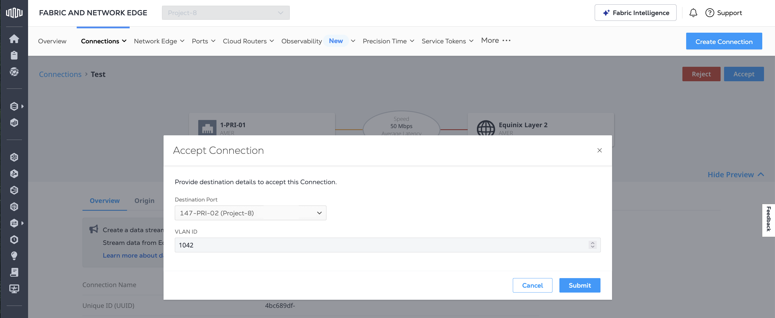

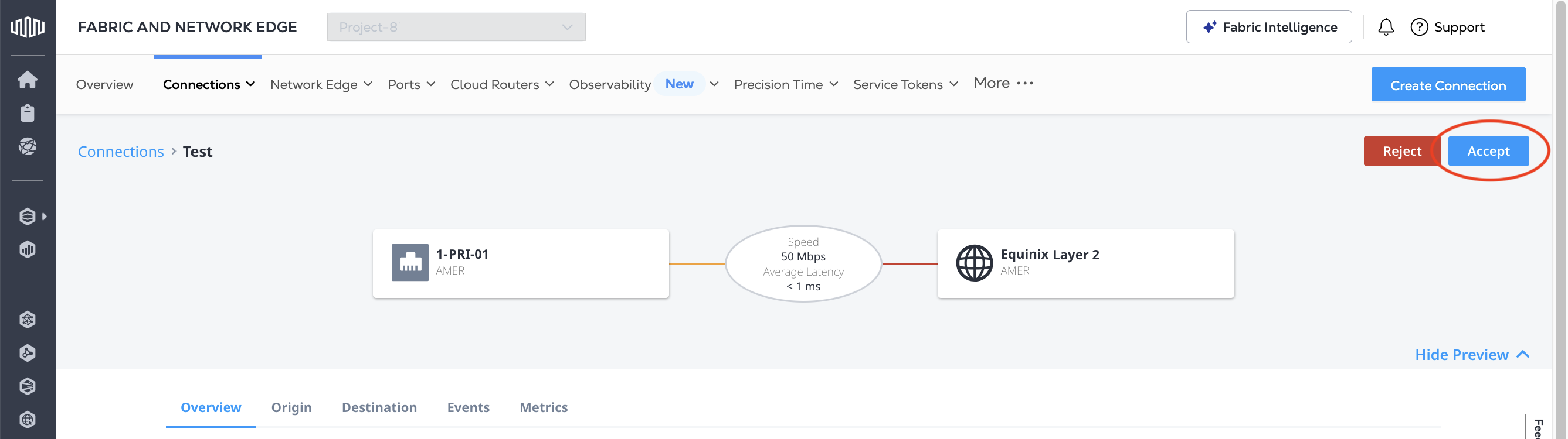

Locate the connection request you want to manage and click Accept or Reject Connection.
Click Accept.
From the Destination Port drop-down list, select the port you want to terminate this connection at, then click Submit.
noteDestination ports list contains all eligible ports including ports assigned to different projects. If you select a port in a different project, the connection will be associated with the project that the port is assigned to.
Click Confirm.

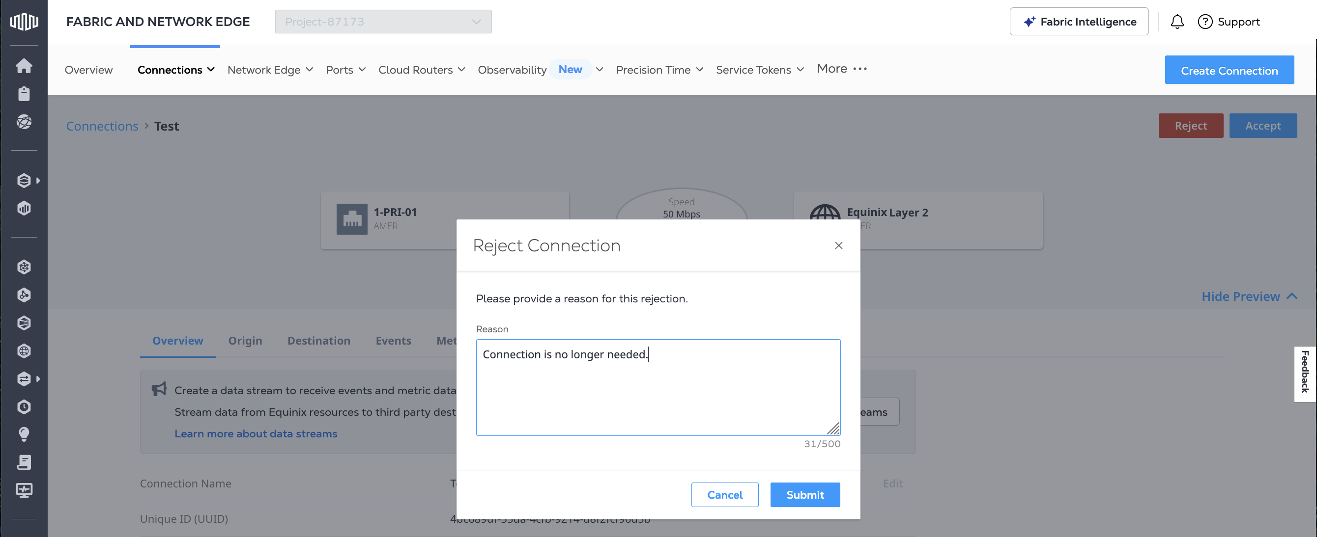

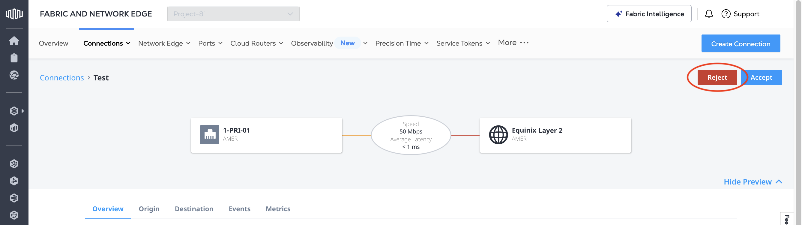

Click Reject.
Enter the reason why you reject this connection request, then click Submit.
