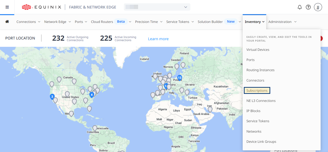

To access your Subscriptions, from the Inventory menu, select Subscriptions.
Inventory menu open with Subscriptions highlighted

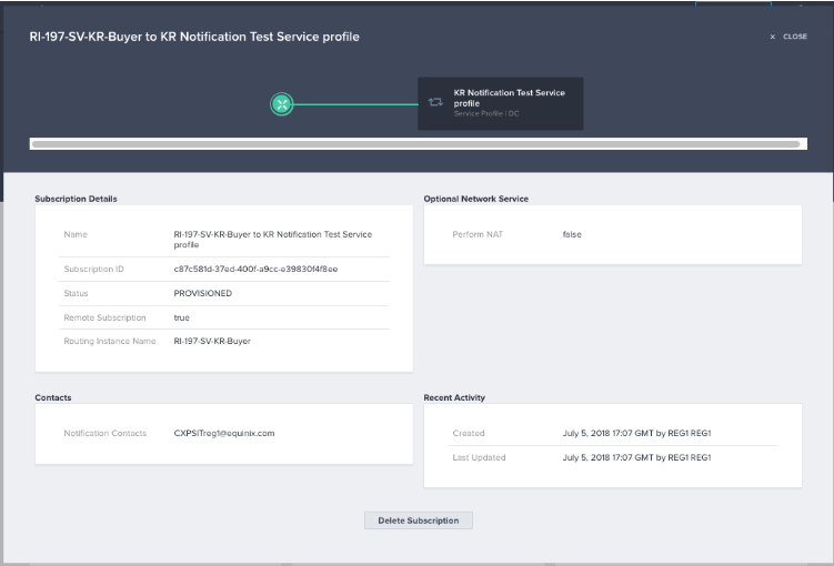

From the subscription card collection, click the subscription card you want to view in greater detail. The details window shows additional information about the subscription, as well as the RI and the service profile it's set up for.
Subscription details window showing subscription details, contacts, recent activity, and Delete Subscription
Delete a Subscription​
From the subscription details window, click Delete Subscription button at the bottom of the window. A messages asks you to confirm this action. Once you confirm, a notification appears indicating that your request is successful. The status on the Subscription card goes to Being Deprovisioned. As a result, you can no longer use this subscription.
