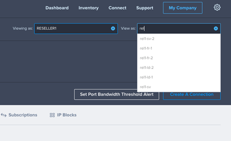

Accessing End-customer Projects​
In the Equinix Fabric Portal, the Reseller Admin can view the ports shared with the end-customer and connections created by the end-customer by simply switching to the end-customer project using the project switcher. In addition, a reseller can view, order and manage the connections for the end-customer by switching into the end-customer project. Admin and reseller users can view the Inventory and My Company pages of end-customer organizations under their preview.
By simply switching between reseller & sub-account projects, reseller admins can get an overview of all the assets that belong to the reseller vs what belongs to the sub-customer.
Organization / Project Switcher​
Located on the title section of the portal, the project switcher enables navigation between organizations or projects. The drop down lets users select the organization/projects that have access to & lets users view Equinix Fabric from the same lens and perspective as the organization/project selected. In the project switcher, users can also click on Search for Customer to display a list of sub accounts. You can also type the first letters of the name to narrow the search results. Sub accounts where the user does not have access may appear in the list but can't be selected.
