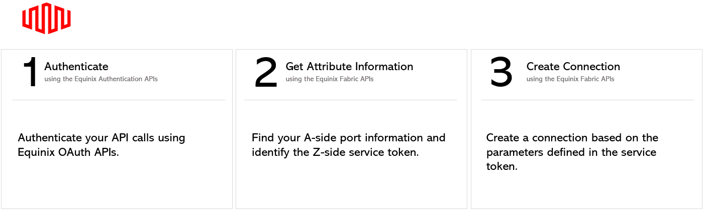

Prerequisites​
  1. Authenticate - Submit your user credentials, Client ID, and Client Secret for OAuth2 authentication. Refer to API Authentication for instructions on how to call the OAuth API to validate and authenticate your credentials.
  2. Determine your a-side port information. Get your relevant port information using the Get All Ports endpoint.
  3. Obtain the z-side service token details from the provider. This information is required to invoke the create connection API.
