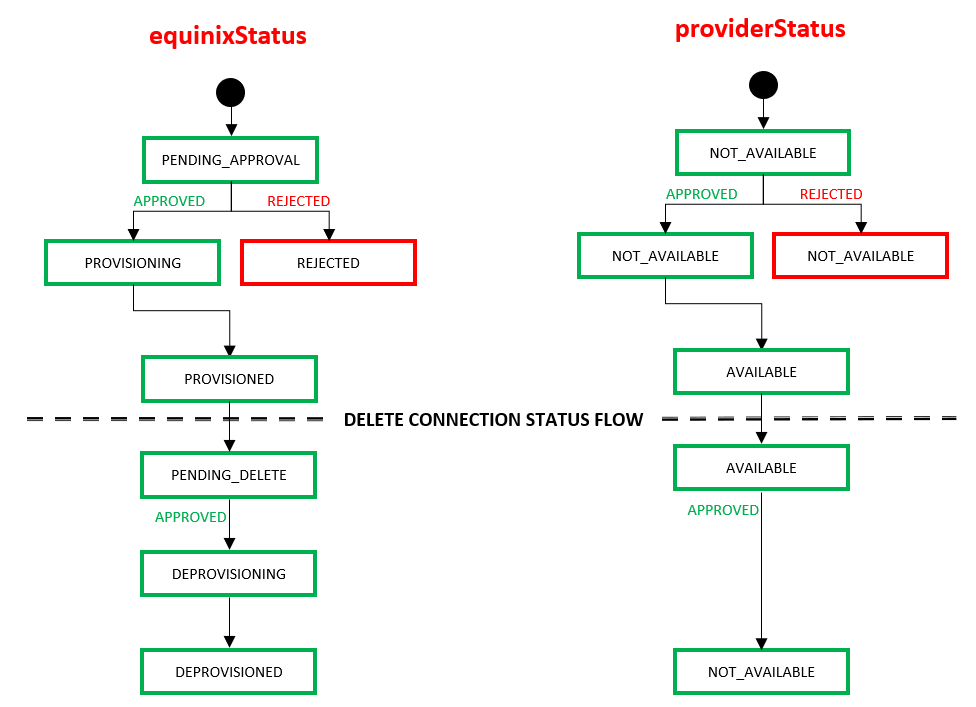

Monitoring the Connection​
Use the Get Specified Connection endpoint to monitor connection status.
equinixStatus parameter valuesproviderStatus parameter valuesDescription
PENDING_APPROVALNOT_AVAILABLEConnection request awaiting approval.
PROVISIONING or REJECTEDNOT_AVAILABLEConnection establishment in progress or the seller has rejected the connection.
PROVISIONEDAVAILABLEConnection established.
