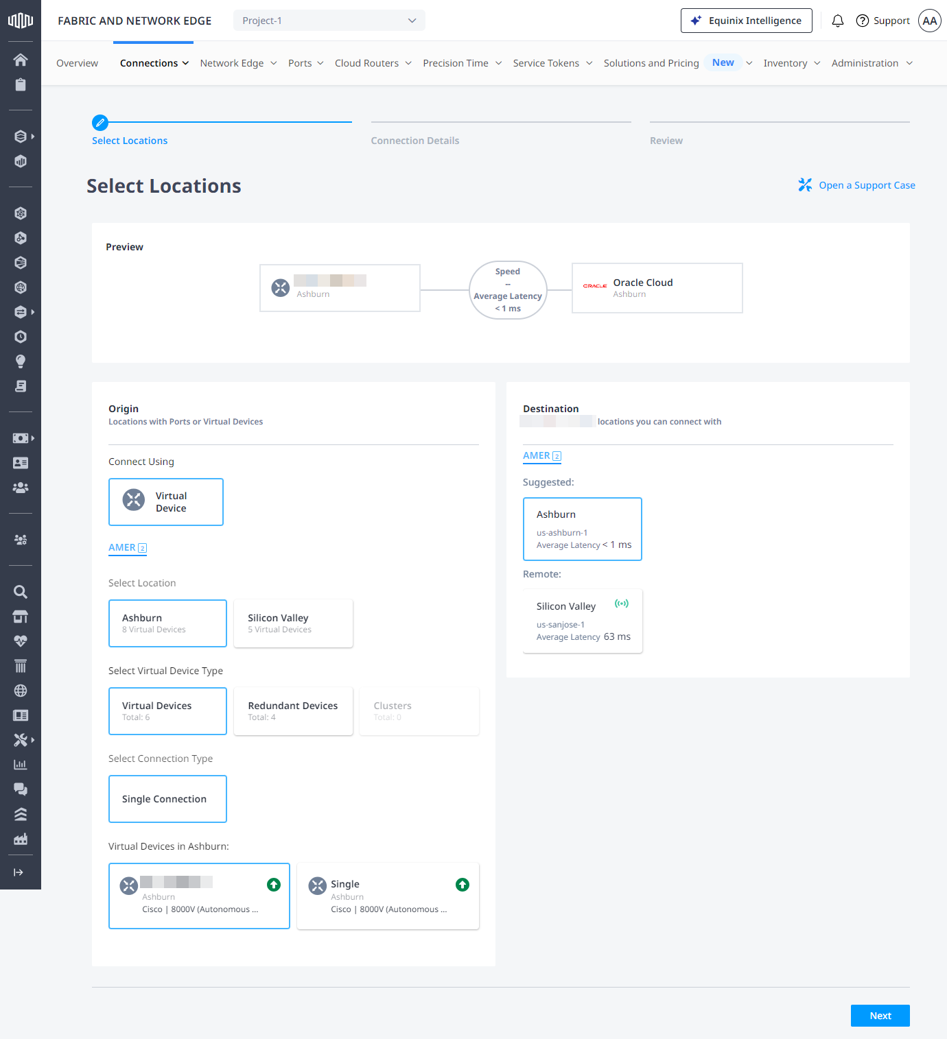

Select Locations
In the Origin section:
  1. Click Virtual Device. If the Virtual Device option is disabled, there are no virtual devices available in the selected project. Choose a different project, that has virtual devices assigned to it, or create a new virtual device in this project.
  2. Select a Metro.
  3. Choose virtual device type, select connection type, then select a virtual device instance.
In the Destination section select a metro where you want to terminate your connection, then click Next.

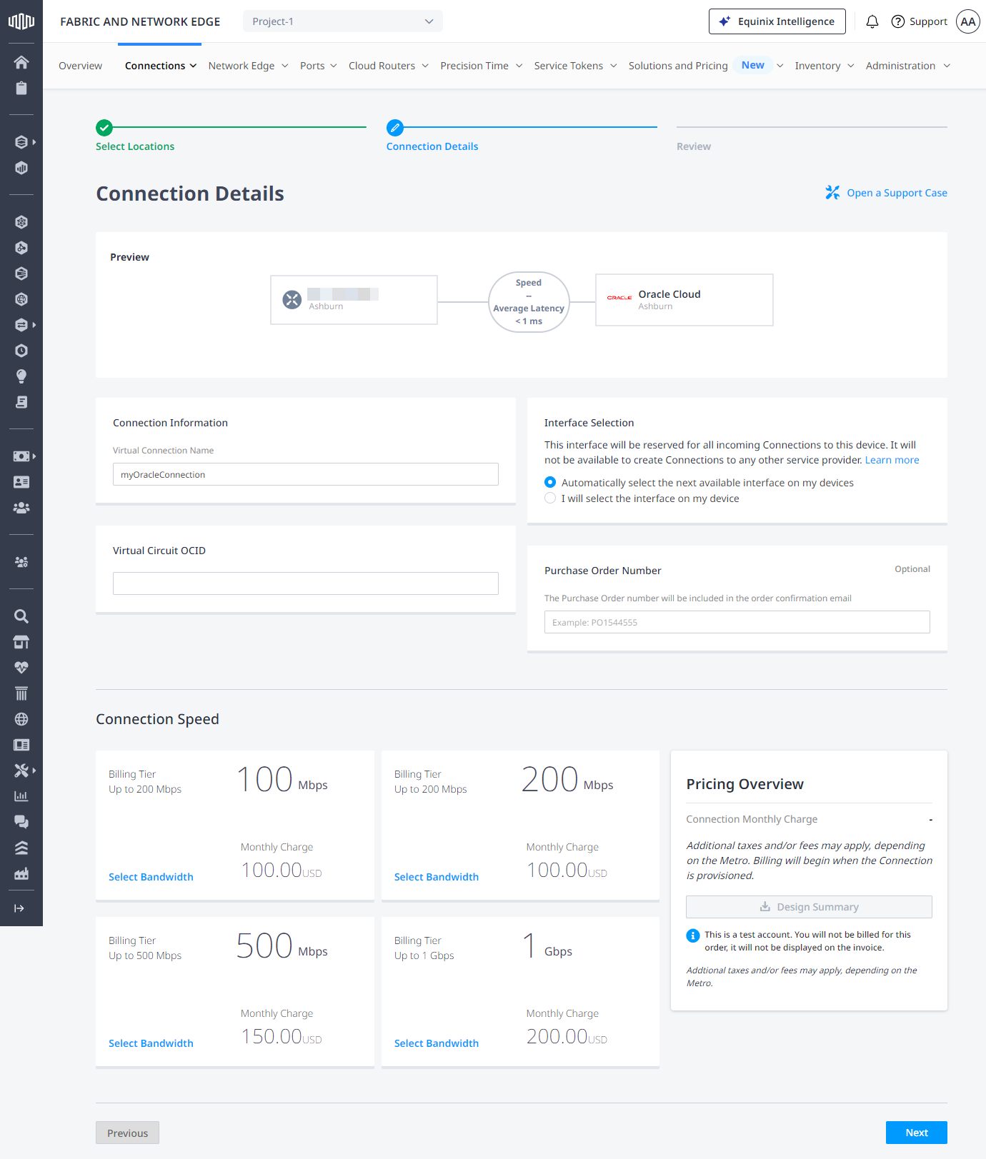

Connection Details
  1. Enter a connection name.
  2. Enter a virtual circuit identifier.
  3. Select network interface on your virtual device.
  4. Enter a purchase order number.
  5. Select connection speed, then click Next.
