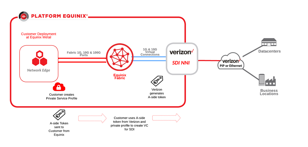

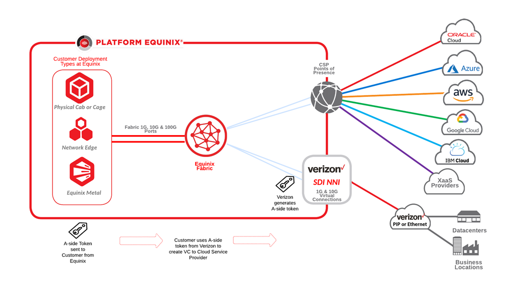

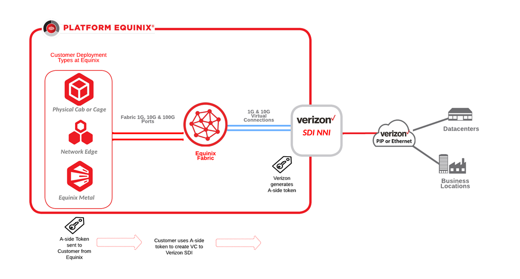

Two methods of access to the Verizon network are available:
  • Verizon-ordered access – Initiated through the Verizon portal, these are Equinix Fabric virtual connections that originate from the Verizon access points (Fabric ports) towards a CSP, a Customer Cage, Equinix Metal or Network Edge. These connections are created by obtaining an A-side token from Verizon that is emailed to the customer’s email address, then redeemed by the customer in the Equinix Customer portal, allowing the customer to create a connection to almost any Equinix Fabric provider or other destination.

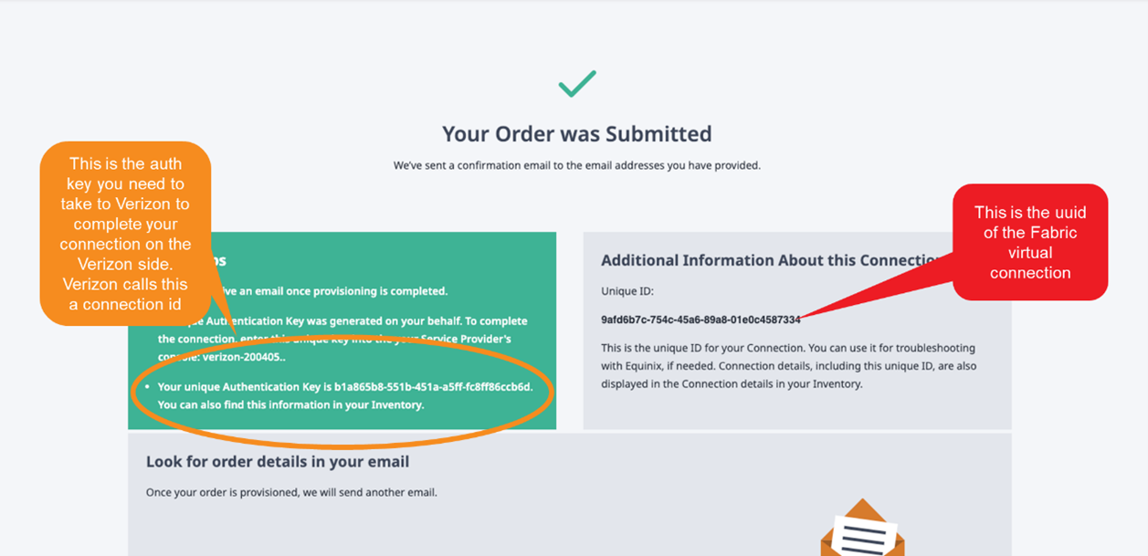

  • Customer-ordered access – Use the Equinix Customer portal to create a connection to a Verizon SDI service profile that describes any of the available Verizon network services to which you want to connect over Fabric.
    Customer-ordered access requires a Verizon authentication key when completing the connect request in the Customer portal. This authentication key is needed to complete the connection in the Verizon portal. The same authentication key can be used to create multiple connections over the same SDI. If you need to use a new or different authentication key, you must order a new SDI service instance from Verizon. The authentication key is shown in the success page as below:

  • A-side service token authorizing you to use Verizon SDI port as the connection origin access point.
    tip
    To get an A-side token, work with your Verizon sales representative. Once ready, you will receive an email from Equinix with the A-side token information.

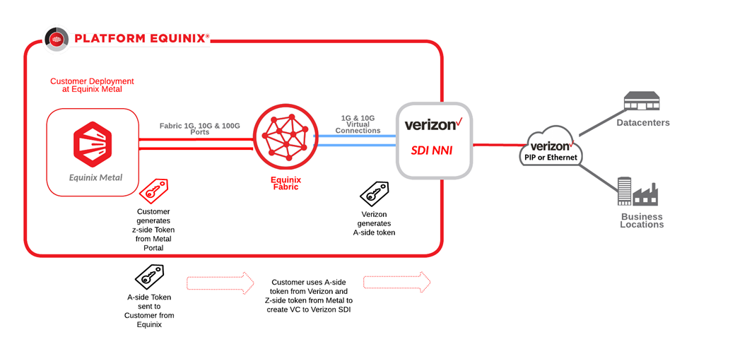

Connect from Verizon SDI to Equinix Metal
To connect from Verizon SDI to Equinix Metal:
  1. Log in to Equinix Metal Console and request a Metal billed Fabric virtual connection to procure a Z-side service token authorizing you to connect to Equinix Metal instance as a destination.
    info
    Since you are using a Verizon A-side token, you will not be directly billed for this connection.

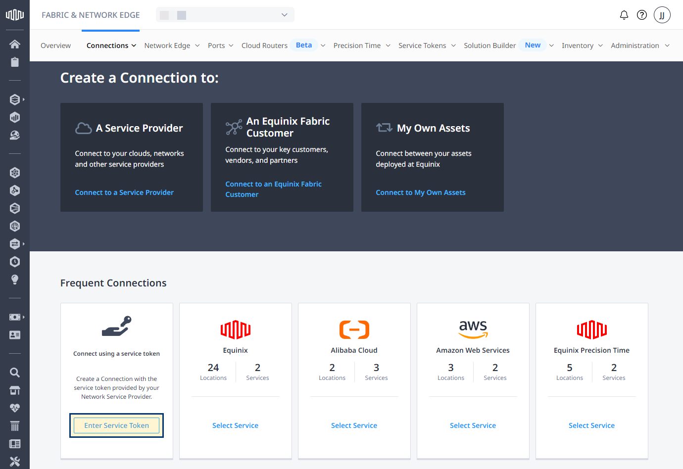

  2. Log in to Equinix Fabric.
  3. From the Connections menu, select Create Connection.

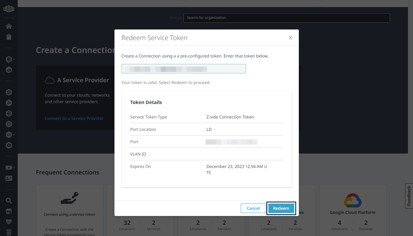

  4. In the Frequent Connections section, click Enter Service Token.
  5. Enter your Metal-provided Z-side token identifier and click Validate.
  6. Verify token details and click Redeem to proceed with creating the connection.

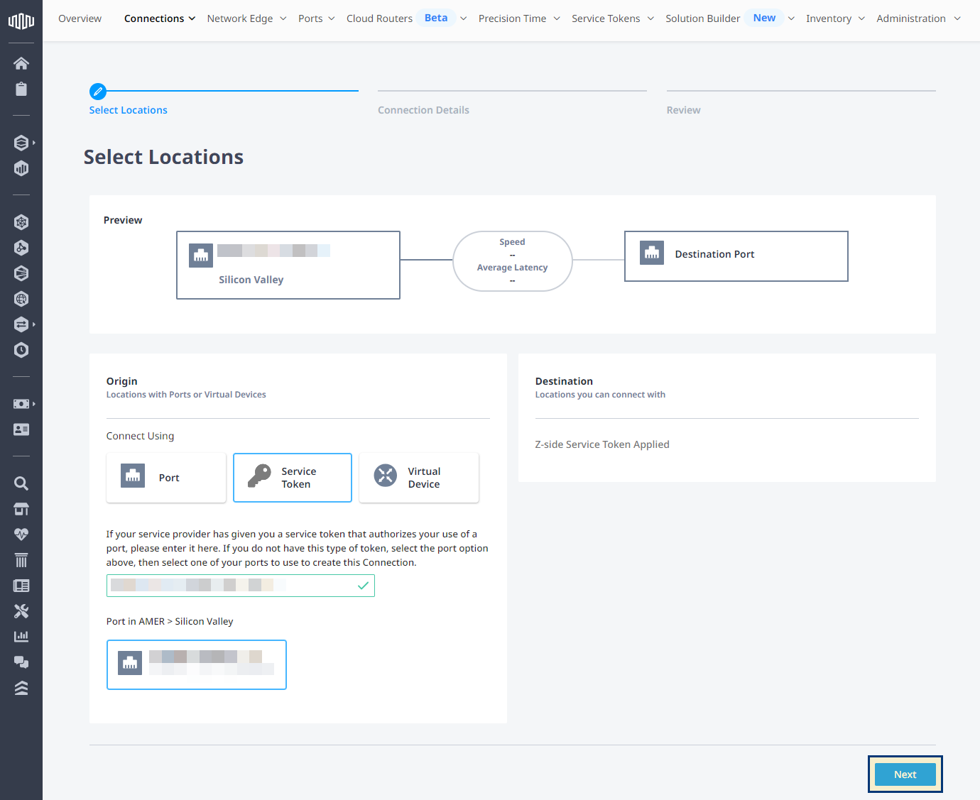

  7. In the Connect Using section, click Service Token.
  8. Enter Verizon-provided A-side service token, verify port details and click Next.

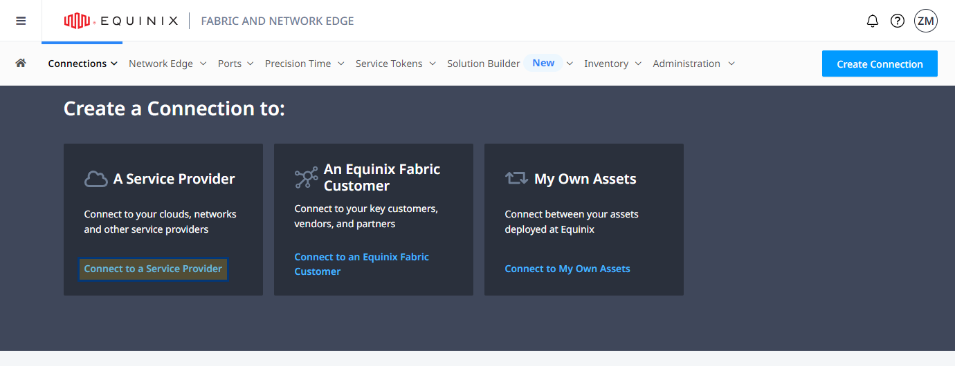

  2. From the Connections menu, select Create Connection.
  3. In the Create a Connection to section click Connect to a Service Provider.

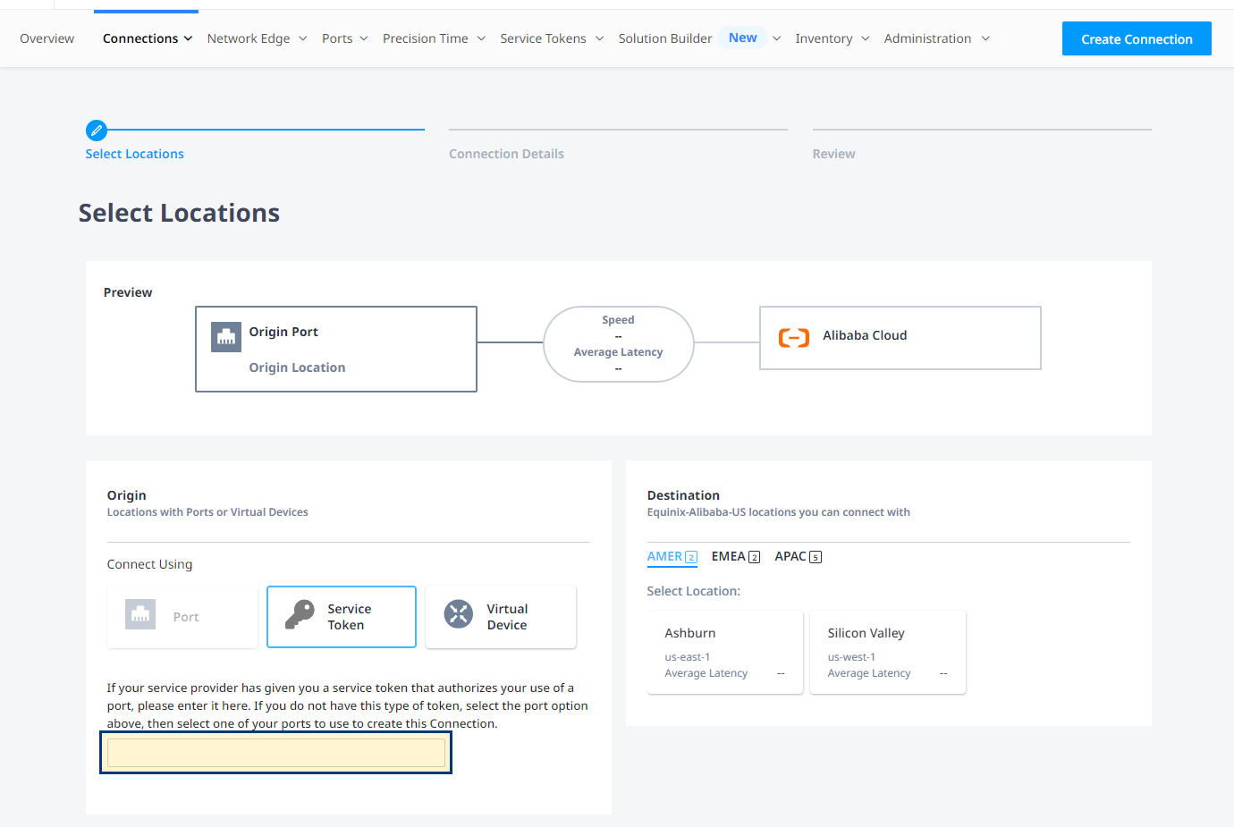

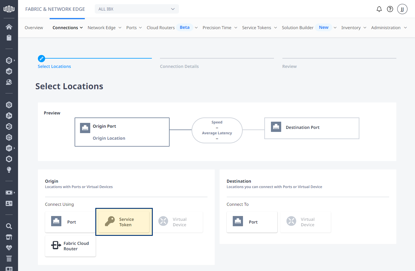

  6. In the Origin section, select Service Token and enter your Verizon provided A-side service token.

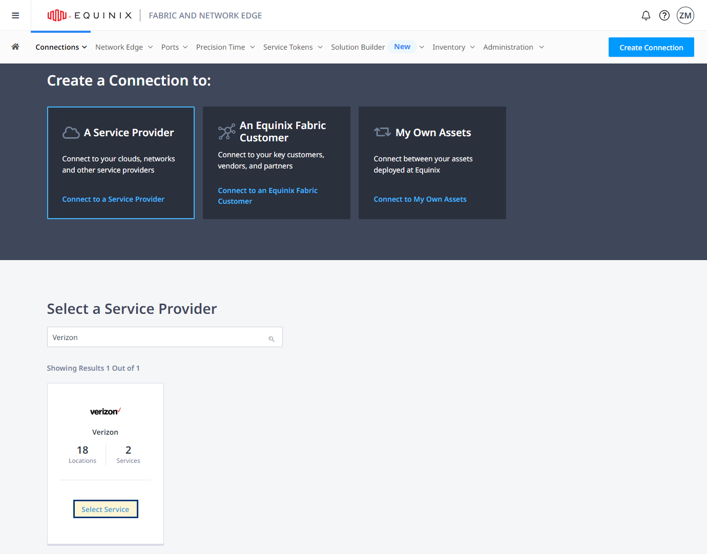

  3. On the A Service Provider card, click Connect to a Service Provider.
  4. Enter Verizon in the search field.

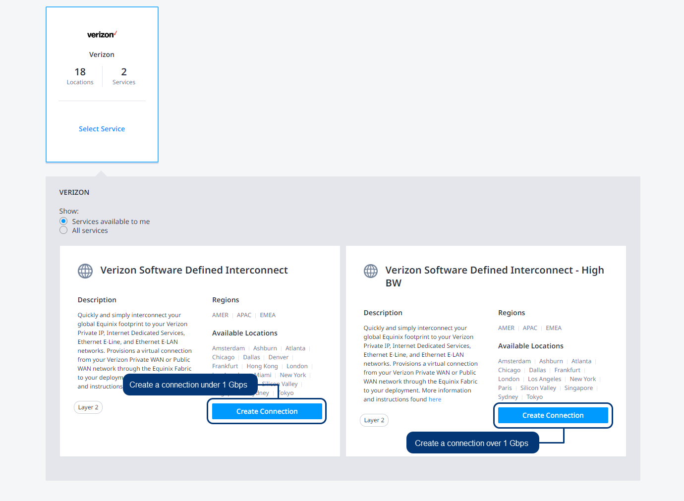

  5. On the Verizon card, click Select.
  6. Choose service profile and click Create Connection.
    tip
    Choose Verizon Software Defined Interconnect - High BW service profile for connection speeds over 1 Gbps. Otherwise, select Verizon Software Defined Interconnect.

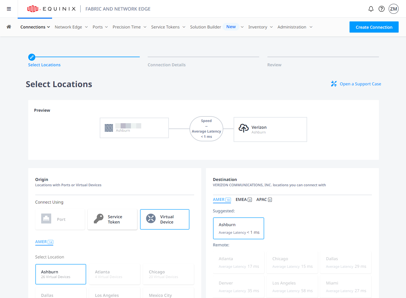

  7. In the Connect Using section, select how you want to connect to Verizon SDI.
    • Port – Select if you want to connect using a port.
    • Virtual Device – Select if you want to connect using a Network Edge virtual device.
  8. Select a location and choose your port or Network Edge virtual device instance.

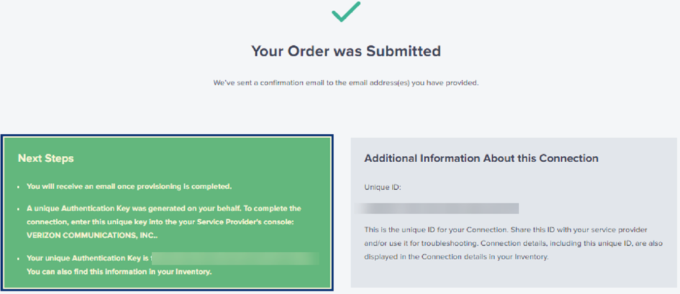

  17. Share the Authentication Key displayed on the order confirmation page with your Verizon sales representative.
    Once Verizon has accepted your connection, your Equinix Fabric connection will automatically be provisioned and you will receive an email notification about connection's status change.

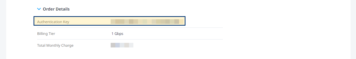

Authentication Keys
The confirmation message provides your Authentication Key. This Authentication Key can be used again for additional connections from a Fabric port, or you can choose to create a new Authentication Key for each subsequent connection.
The Authentication Key is also available on the connection's details page in the Order Details section.
To access connection details page:
  1. From the Connections menu, select Connections Inventory.
  2. Locate your Verizon SDI connection and click it.
  3. Click Order Details to expand the section.
