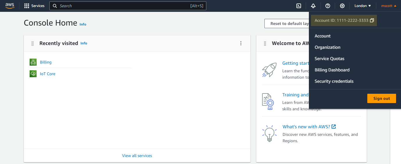

  7. Enter your AWS account identifier and click Next.
    tip
    To retrieve your AWS account identifier, log in to the AWS Management Console and click your username in the top-right corner. When you paste your account ID, make sure to remove dash characters.

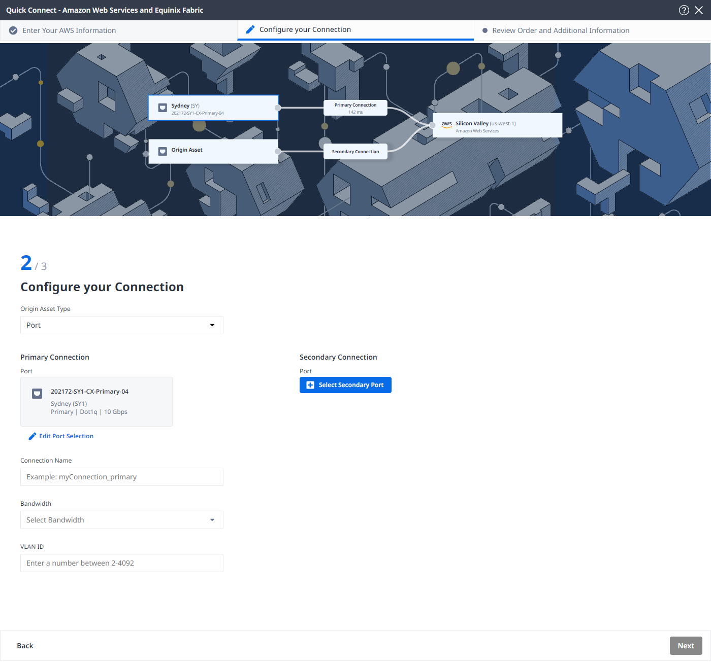

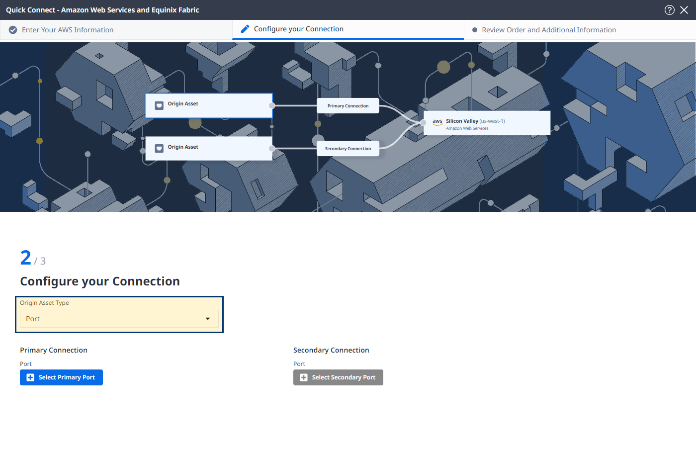

Port
From the Origin Asset Type drop-down list, select Port.
  1. In the Primary Connection section:
    • Click + Select Primary Port, then select your primary connection port and click Select Port.
      Only primary ports are available for selection.
    • Enter the primary connection name.
    • Select a bandwidth.
    • If you are using Dot1q ports, enter a VLAN ID. If you are using Qinq ports, enter aCustomer VLAN Tag (C-tag) and a Service VLAN Tag (S-tag).
  2. In the Secondary Connection section:
    • Click + Select Secondary Port, then select your secondary connection port and click Select Port.
    Only secondary ports are available for selection.
    • Enter the secondary connection name.
  3. Click Next.

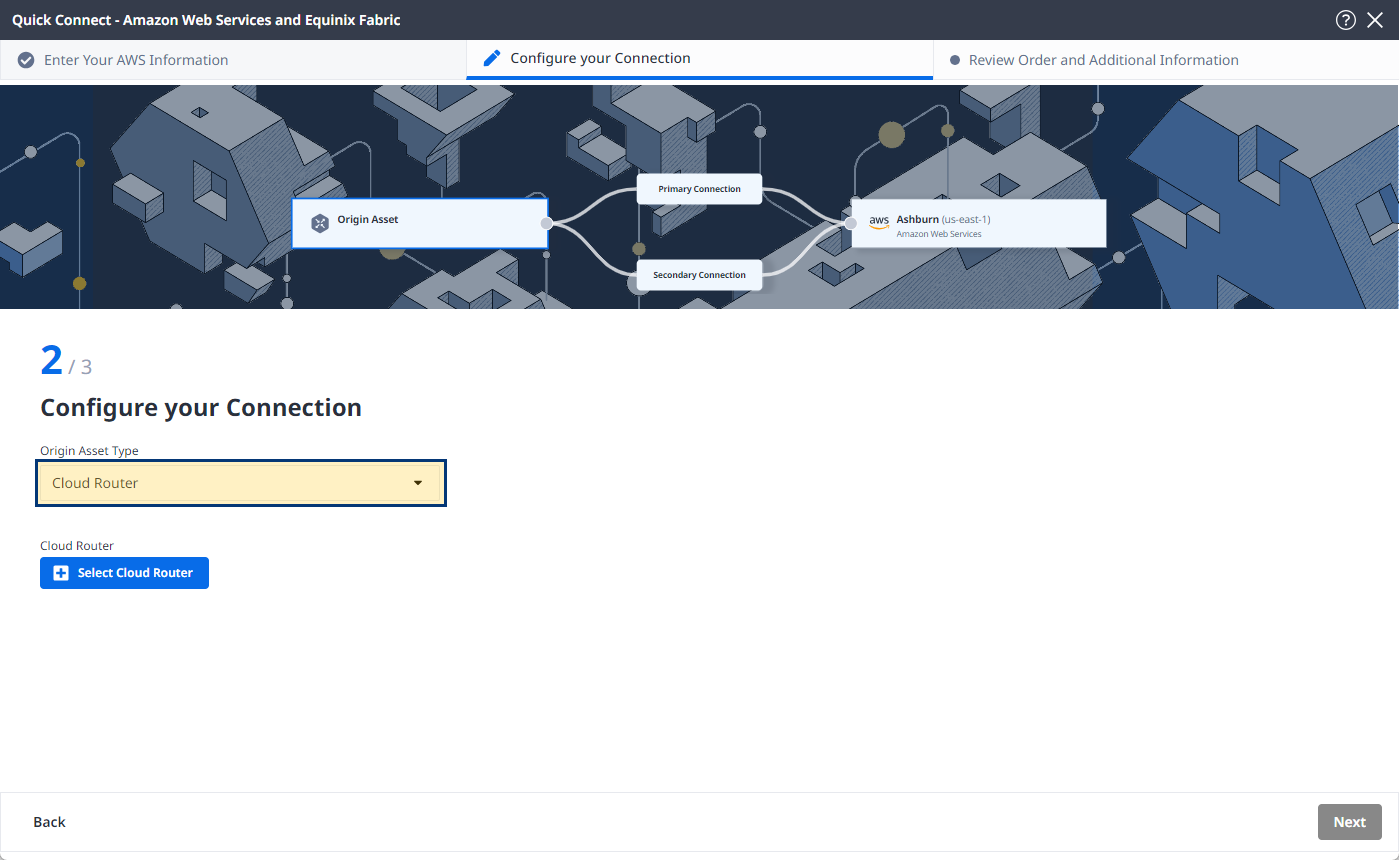

Cloud Router
From the Origin Asset Type drop-down list, select Cloud Router.
  1. Click + Select Cloud Router, select a cloud router instance, then click Select Cloud Router.
  2. In the Primary Connection section:
    The bandwidth value you select will also apply to the secondary connection.
  3. In the Secondary Connection section, enter your secondary connection name.
  4. Click Next.

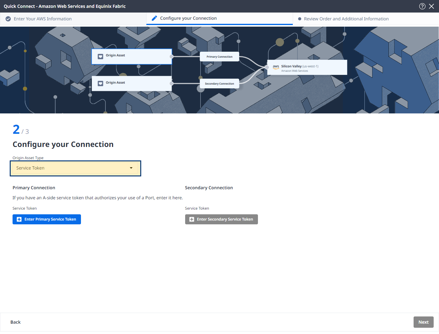

Service Token
From the Origin Asset Type drop-down list, select Service Token.
    • Click + Enter Primary Service Token, provide the service token, then click Enter Service Token.
    • Click + Enter Secondary Service Token, provide the service token, then click Enter Service Token.
  3. Click Next.

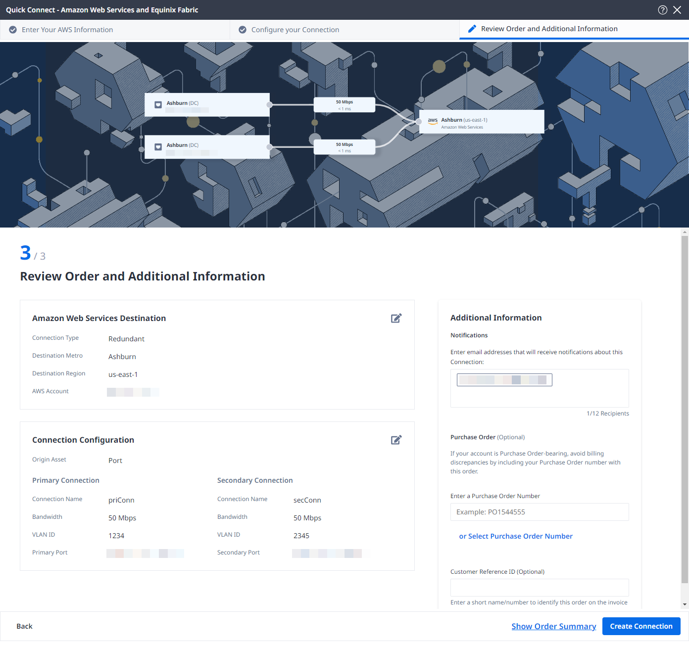

Review and Submit
On the Review Order and Additional Information page:
  1. Review the information in the AWS Web Services Destination and Connection Configuration sections.
  2. Use the Notifications field to provide the email addresses of the recipients to be notified about the connection's status. You can add up to 12 email addresses.
  3. (Optional) Enter or add order information in the Purchase Order section.
    • Click Select Purchase Order Number.
    • Click Select an Existing Purchase Order.
    1. Select purchase order number you want to apply to your order, then click Done.
  4. Provide customer reference identifier, that will help you identify this order on your invoice.
  5. Click Show Order Summary to see order details and connection pricing information.
When you are ready, click Create Connection.
