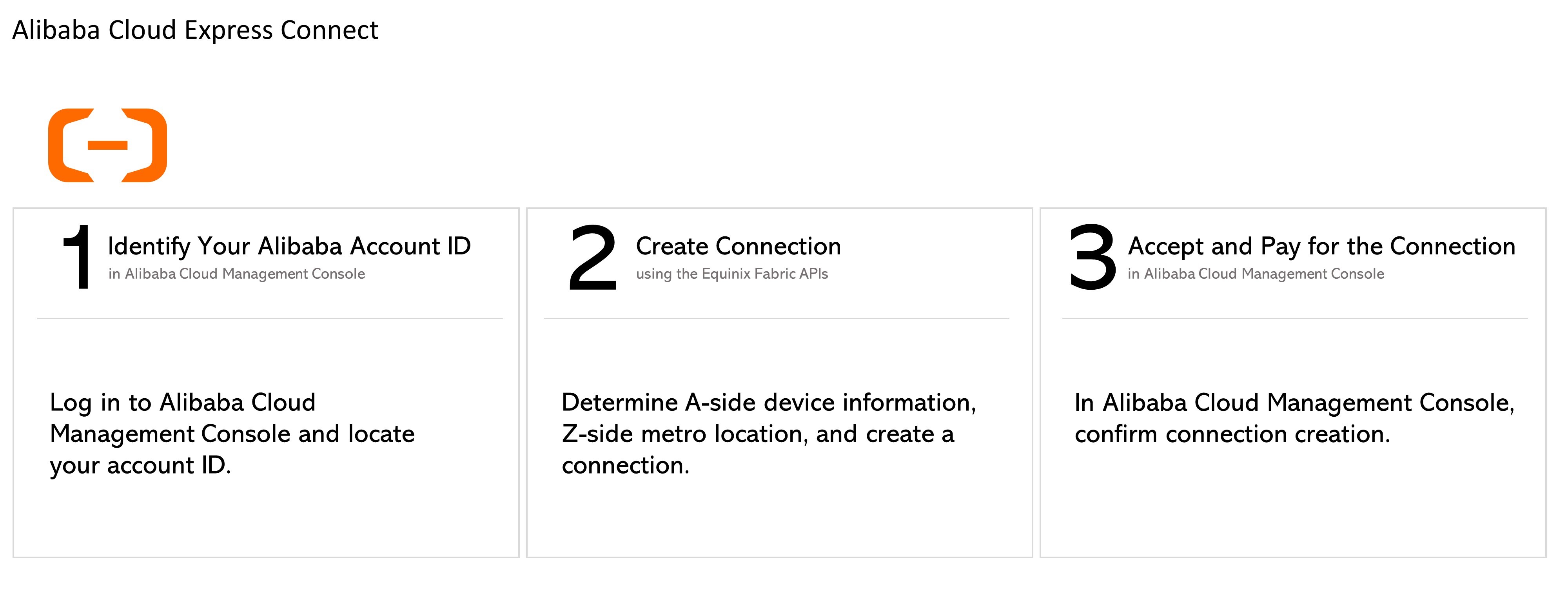

API - Connect to Alibaba
Establish a direct, layer 2 connection to Alibaba Cloud.
Identify Your Alibaba Account ID
Log in to Alibaba Express Connect Management Console and locate your Account ID.

Monitoring the Connection Status
Send a GET request to the fabric/v4/connections/{connectionId} endpoint to monitor connection status.
equinixStatus attribute valuesproviderStatus attribute valuesAlibaba Cloud statusDescription
PROVISIONINGNOT_AVAILABLE-Connection request has not been sent to Alibaba yet.
PROVISIONEDPENDING_APPROVALPending creationThe connection awaits for approval.
PROVISIONEDPROVISIONING / PROVISIONEDCreate in progressConnection establishment in progress.
PROVISIONEDPROVISIONEDActiveConnection established.
Accept and Pay for the Connection
  1. Log in to Alibaba Express Connect Management Console.
  2. From the left manu, select Physical Connections.
  3. Identify the newly created instance and click Accept and Pay.
  4. Create a Virtual Border Router (VBR) instance and associate it with the connection.
For more information, refer to Billing - Pricing | Alibaba Cloud Documentation Center.
