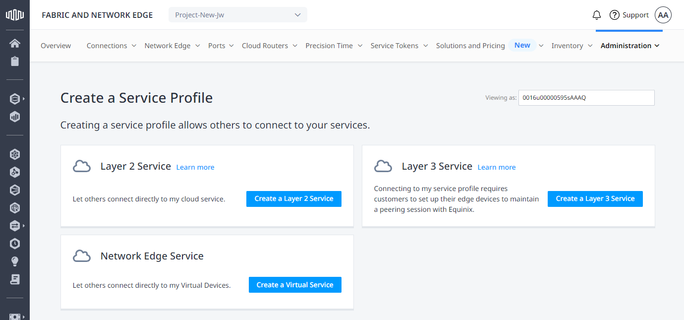

  2. Click Administration and select Create a Service Profile.
  3. In the Layer 2 Service card, select Create a Layer 2 Service.

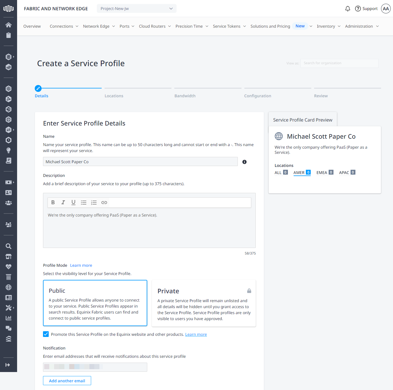

  4. Enter the Service Profile Details.
    • Name – Enter a name for your service profile. This name should be easily recognizable by your customers and should be a combination of your company and the service being offered (for example, Akamai DDoS Mitigation Services). When customers are searching for your service profile, they may likely search for your company name and the service to which they wish to connect. Try to include both in the name.
    • Description – Enter a description of your service (limit 375 characters). The text editor allows you to format your text and add hyperlinks to your description. Hyperlinks to a page that describes your service are helpful. To add a hyperlink, highlight the text, click the hyperlink icon, and enter the URL.
    • Profile Mode – Specify whether your profile will be Public or Private. (Private is selected by default.) For more information about Private and Public Service Profiles, see Service Profile Visibility Settings. If the service profile is Private, add one or more email addresses to grant permission to connect to this service profile.
    • Notification – Enter the email address(es) of anyone who should receive notifications about this service profile. Notifications can include threshold or port down notifications as well as connection requests to your service profile that require approval.

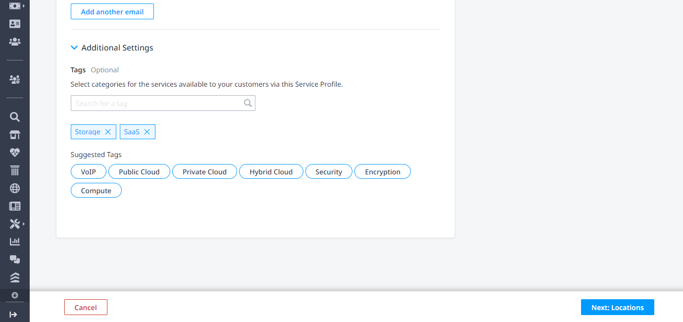

  5. In the Additional Settings section, add tags to your service profile. Either click on the suggested tags listed, or click in the Tag field and select from the list of pre-defined tags. Tags are used to offer better search options to customers looking for a particular service type offered on Equinix Fabric.

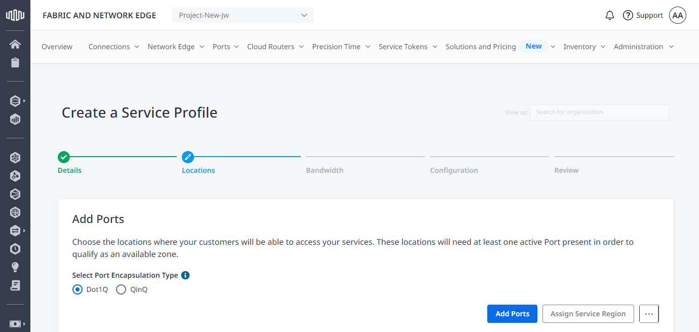

  6. Click Next: Locations.

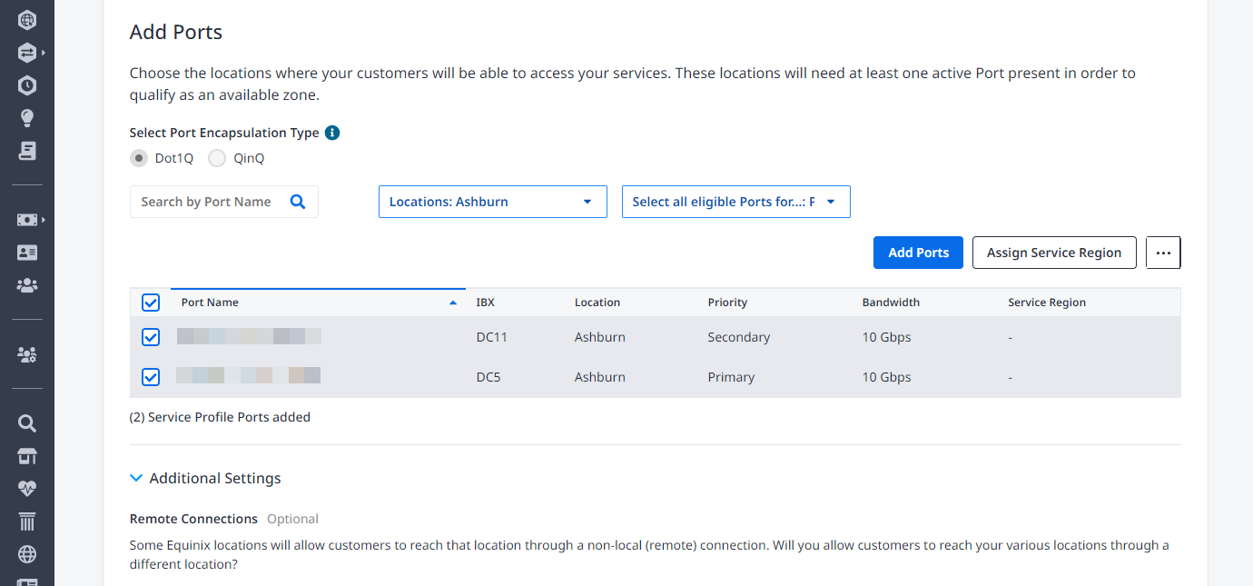

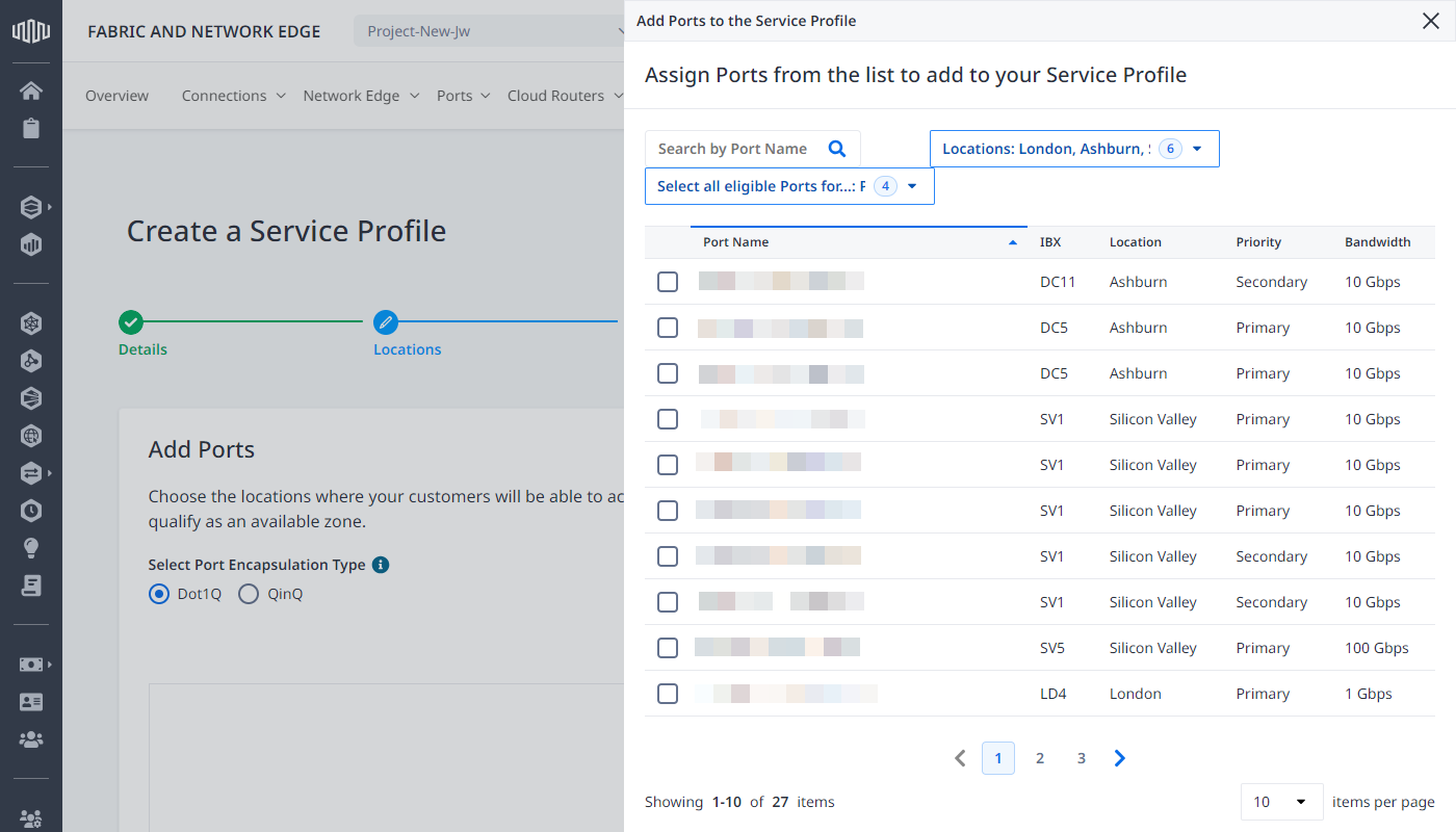

  7. In the Add Ports section, specify one or more locations where your customers will access your services. Each location must include at least one active port.
    • Select a Port Encapsulation Type of either Dot1Q or QinQ.
    • Click Add Ports. The Add Ports to the Service Profile form is displayed on the right side of the page.
    • Select one or more ports from the Port Names list. To filter the list by metro location, use the Locations drop-down list.
      tip
      You will need to add 100GE ports to your Service Profile if you plan to offer bandwidth options over 10 Gbps.
    • Click Add Ports. The ports that you selected are listed on the Add Ports page.

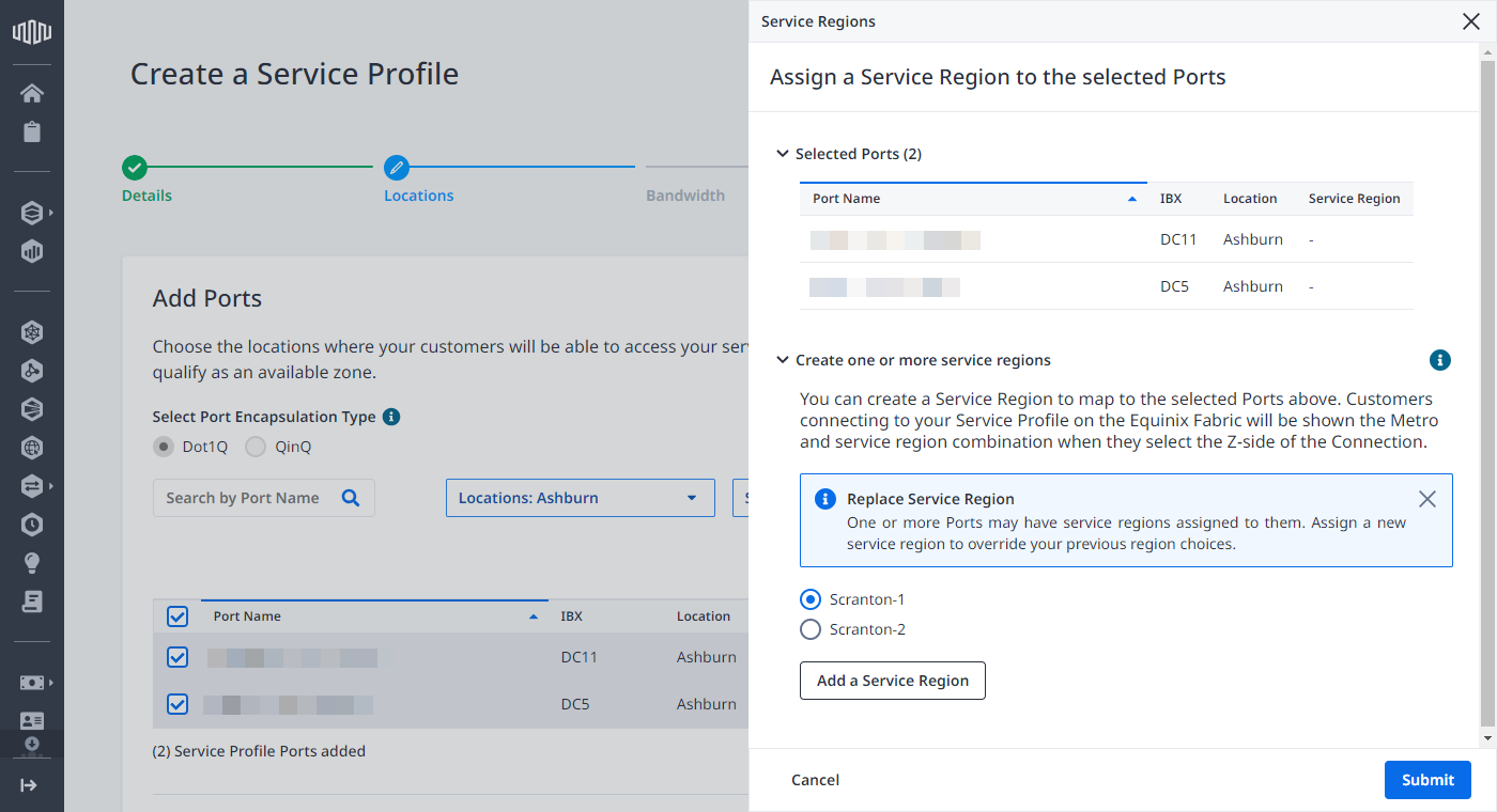

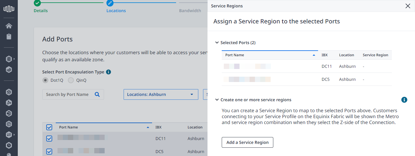

  8. To assign a new service region, select one or more ports from the Port Name list. Click Assign Service Region.
    The Assign a Service Region to the selected Ports form is displayed on the right side of the page.
    1. Click Selected Port(s) to expand the list of ports that you selected. Once you create a service region, these ports are added to that region.
    2. Click Add a Service Region, enter a name, and click Add. The new service region is listed. To add additional service regions, repeat this step.
    3. Click the service region that you want to assign to your selected ports, then click Submit.
      The list of ports in the center of the Add Ports form shows the assigned service region.
    Repeat this step to create additional service regions, and to assign or re-assign ports to them.

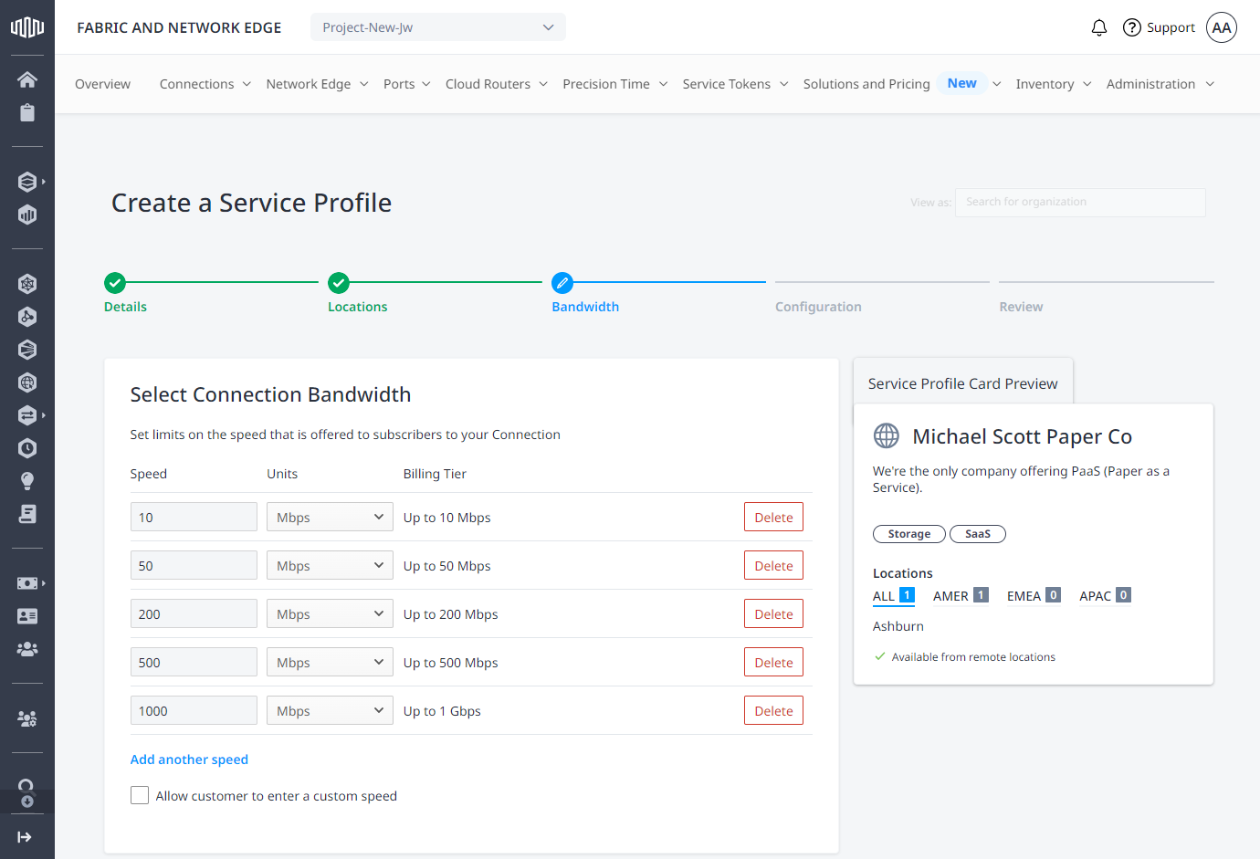

  10. Click Next: Bandwidth.
  11. Select as many bandwidth options as you want to make available to customers connecting to your services. You can also enter custom bandwidths.
    Maximum supported bandwidth is 50 Gbps.

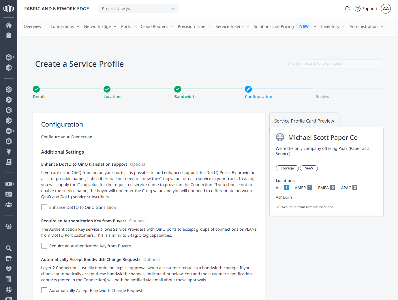

  13. Select any Additional Settings.
    • Enhance Dot1q to QinQ translation support (Optional) – Select to add enhanced support for subscribers with Dot1q ports if you are using QinQ framing on your ports. By providing a list of possible names, subscribers don't need a C-Tag value for each service in your trunk. Instead, you need to supply a C-Tag value for the requested service name to provision the connection. If you choose to disable the service name, the buyer does not enter the C-Tag value, and you don't need to differentiate between QinQ and Dot1q service subscribers.
    • Require an Authentication Key from Buyers (Optional) – Select if you have QinQ ports and want to accept groups of connections or VLANs from Dot1q port customers. This is like S-Tag and C-Tag capabilities. If enabled, each connection (by the same user) to your service profile will be assigned an authentication key that can be reused for subsequent connections to that same profile. All connections must have the same bandwidth and only the first connection will be chargeable.
    • Automatically Accept Bandwidth Change Requests (Optional) – Select to automatically accept bandwidth modifications to your service profile without the need to approve manually. The default option is set to no auto approval.

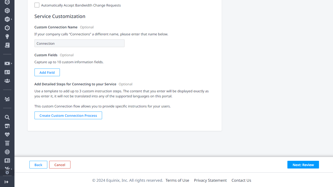

  14. Enter the Service Customization details.
    • Custom Name for Connection – If your company uses another name for “connection,” enter it and this custom name will be provided when customers are creating a connection request to your service.
    • Custom Fields – Add up to 10 custom information fields. These are metadata fields that can be mandatory or optional and will be included in the notification email when a connection request is made to your service profile. Add any additional information you want to collect from your customers ,such as BGP information or account IDs.
    • Add Detailed Steps for Connecting to Your Service – Add up to three custom instruction steps.
      • Click Create Custom Connection Process. Three default steps will display
      • Click Edit to edit the steps.
      • Click Save.

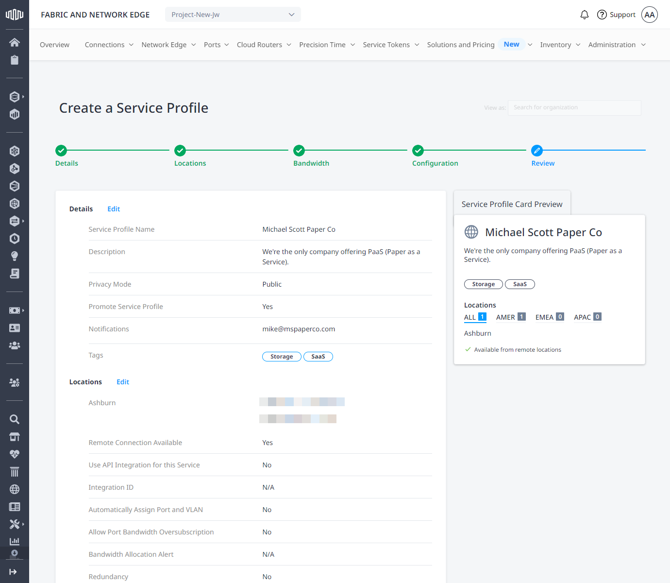

  15. Click Next: Review. The Review page displays, showing you how your service profile will appear in the Equinix Customer portal.
  16. Review the details and click Create Service Profile.
