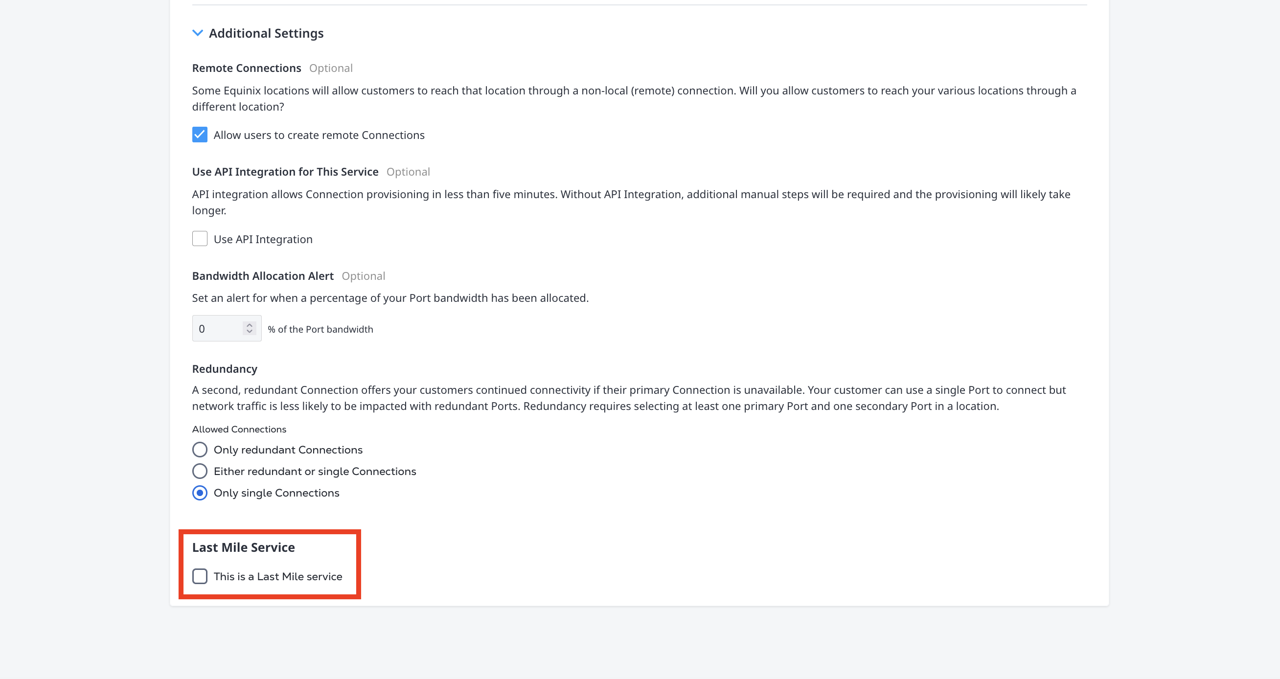

Additional Location and Port Settings​
  • Remote Connections – Select this option to allow users to create inter-metro connections to your services. There is no additional charge to the service provider when inter-metro connections are created to your service. The initiator of the connection will be charged.
  • Use API Integration for This Service – Select this option only if you have worked with our development teams to integrate with your APIs. If you selected this option and you are eligible, enter the Integration ID and select Auto-assign Port and VLAN (if desired).
  • Bandwidth Allocation Alert – Enter a bandwidth percentage to trigger an alert when the committed (sold) connection bandwidth reaches the percentage specified. For example, if you have a 10G port and you enter 80%, you will start to get bandwidth notifications when you have sold 8G total bandwidth of virtual connections to your port.
  • Redundancy – Select which redundancy options customers have when creating connections to your Service Profile. Redundancy requires selecting at least one primary Port and one secondary Port in a location.
    • Only Redundant Connections – If you select this option, Equinix Fabric enforces redundancy and requires all customers to create redundant connections to your service.
    • Either Redundant or Single Connections – When customers create a connection to your Service Profile have the option to create a single connection or a redundant connection.
    • Only Single Connections – Customers are only be able to create a single connection to your Service Profile. A single connection can either be a primary or secondary connection.
Additional Settings with remote connections, API integration, bandwidth alert and redundancy options

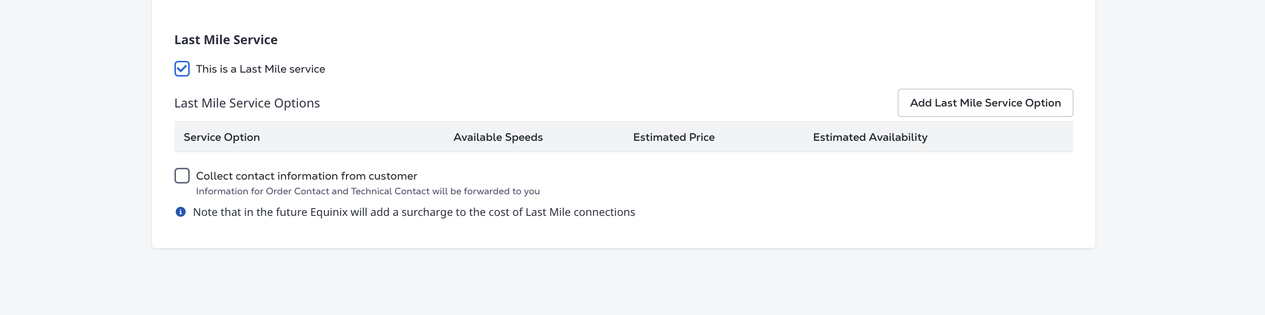

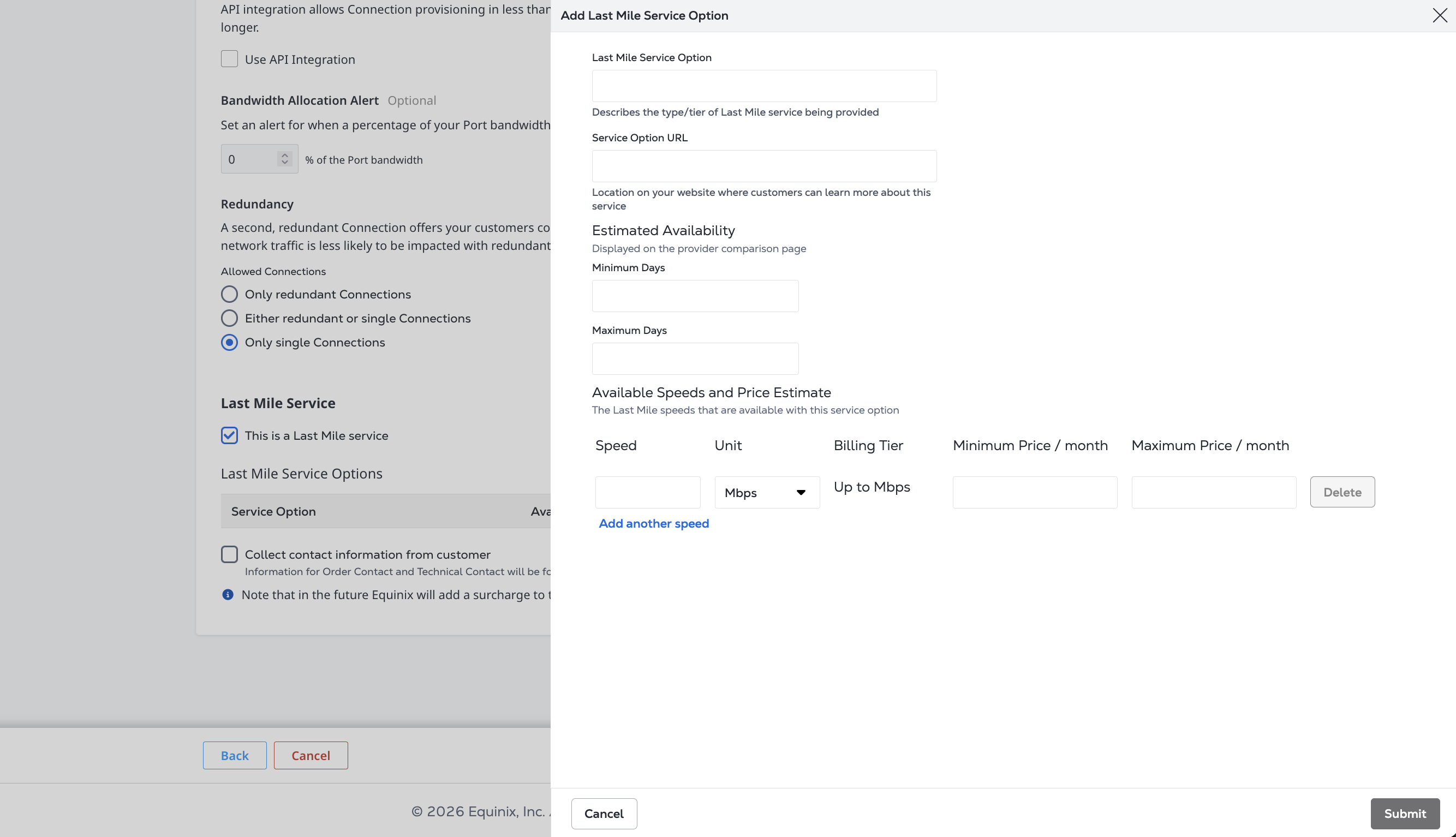

Last Mile Service​
If you are offering Last Mile services with this service profile, select the This is a Last Mile service box and define your available Last Mile offerings.
Last Mile service settings in service profile
See the Becoming a Last Mile Service Provider page for more information on configuring your service profile and your company profile to offer Last Mile services in the Fabric Marketplace.
