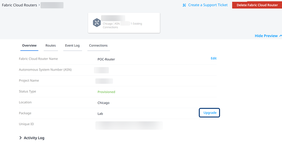

  1. Click the Cloud Router that you want to upgrade. Details for the Cloud Router connection are displayed.
  2. In the Cloud Router Details window, next to the Package attribute, the Upgrade option is available for eligible Cloud Routers. Click Upgrade.
The Upgrade form is displayed on the right side of the screen.

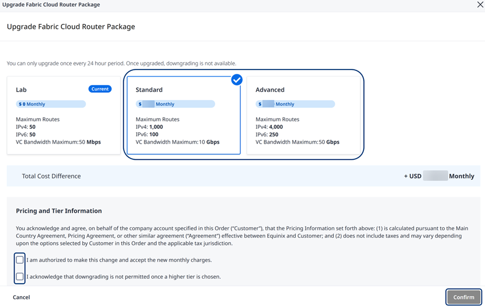

  1. Select the higher tier package that you would like to upgrade the Cloud Router to. The higher tier packages have a higher route quota and supported bandwidth for connections.
  1. Review the summary of the cost difference for the upgraded Fabric Cloud Router package.
If you are upgrading a Fabric Cloud Router from the Lab tier and it has associated connections, these connections are also added to your invoice at the standard Fabric prices for connections.
  1. In the Pricing and Tier Information section, select the checkboxes to authorize this change and to acknowledge that downgrading to a lower package is not possible.
  2. Click Confirm.

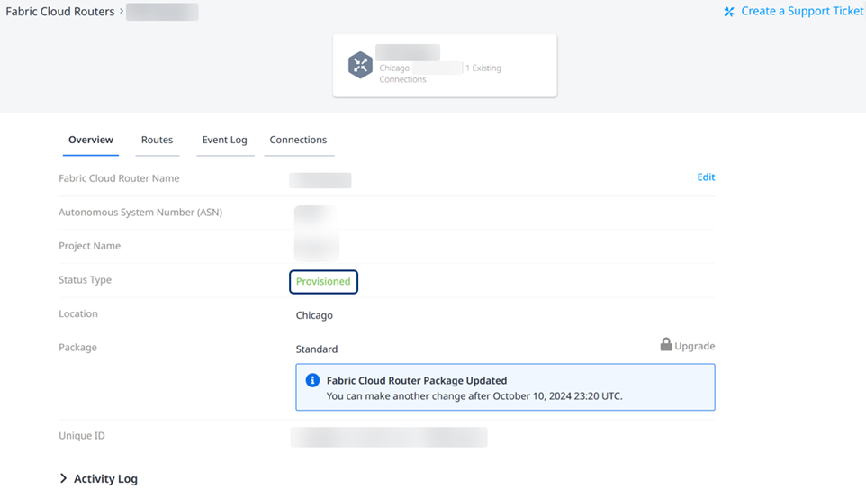

Once the upgrade is triggered, updating the Cloud Router and its associated connections is not possible. The Cloud Router status is locked and an informational box is displayed on the Cloud Router Details page, confirming that your request is submitted.
When the upgrade is complete, the Fabric Cloud Router status is set to Provisioned. The Details page displays an informational message.
Due to the way that Fabric handles billing updates, any billing-impact updates for the Cloud Router and its associated connections are allowed only after 24 hours. For example, a bandwidth upgrade on a connection would be delayed for 24 hours.
After a successful upgrade, an email notification is sent to the addresses associated with the Cloud Router.
