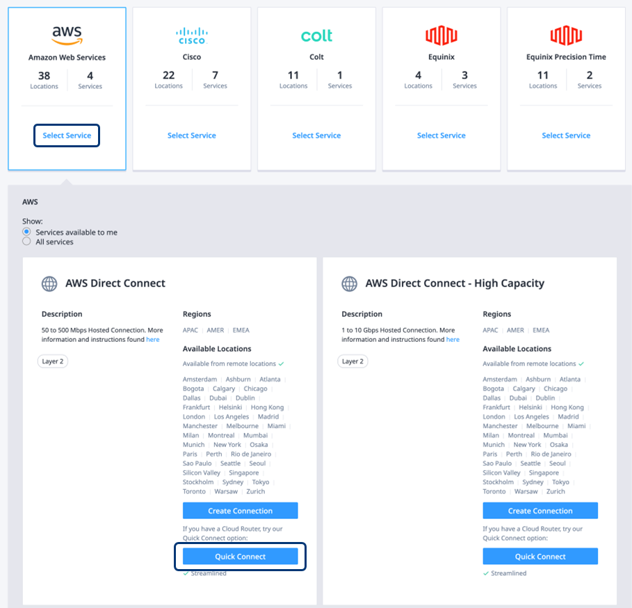

  3. From the Connections menu, select Create Connection.
  4. In the Frequent Connections section, click Select Services in the Amazon Web Services card to expand the available services.
  5. Based on the desired throughput of the Direct Connect, click Connect under the appropriate profile.
Connect – Amazon Web Services and Equinix Fabric

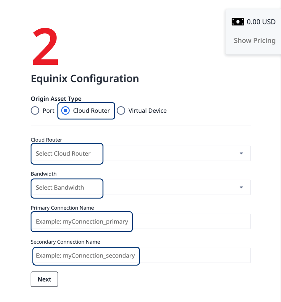

Equinix Configuration
  1. For the Origin Asset Type, click Cloud Router.
  2. From the Fabric Cloud Router drop-down list, choose the Cloud Router that you want to use.
  3. From the Bandwidth drop-down list, select the bandwidth you would like to use for the connection(s).
  4. Enter a unique Connection Name for each new connection, depending on the Connection Type that you selected in the Connect – Amazon Web Services section.
  5. Click Next.
