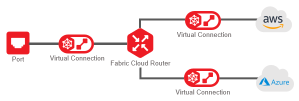

  • Service Profile – Aggregates several other components for the purpose of offering services to create connections. A service profile is either Layer 2-centric (built around ports) or Layer 3-centric (built around Routing Instances).
  • Service Token – Authorizes access to Fabric ports, allowing to create connections based on pre-determined set of parameters.
  • Network – Enables optimizing the number of connections needed to create multipoint-to-multipoint networks.
  • Fabric Cloud Router – A virtual routing service that enables Layer 3 connectivity between public clouds, colocated assets, Equinix Metal instances,s or Network Edge devices.
