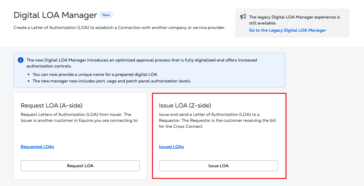

Issue a Digital LOA to a Requestor​
To issue and send a Digital LOA to a Requestor, follow these steps:

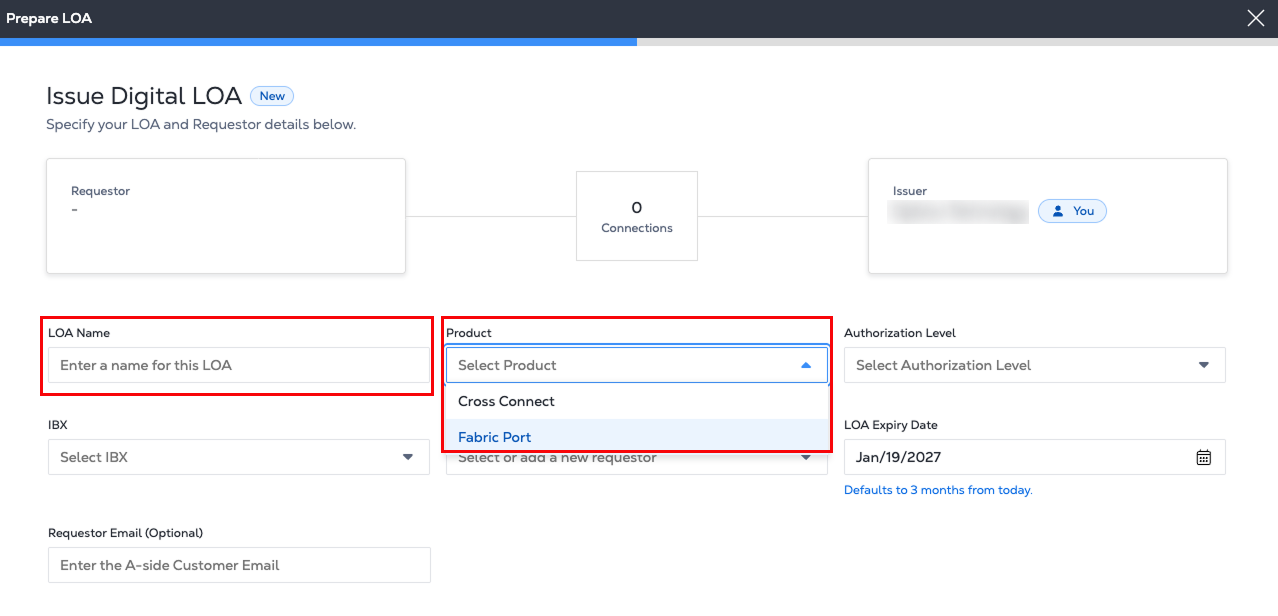

  1. Look for the Issue LOA (Z-side) card and click Issue LOA.
  2. Enter a name for the LOA and select a product from the Product list

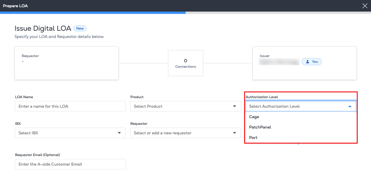

  3. The Authorization Level determines which equipment the LOA covers.
    • Cage: Grants access to an entire cage. The same LOA can be used for all assets in that cage, including new patch panels and ports.
    • Patch Panel: Grants access to a specific patch panel. The same LOA can be used for all ports on that panel.
    • Port: Grants access to a single port. The LOA can be used once, for that port only.

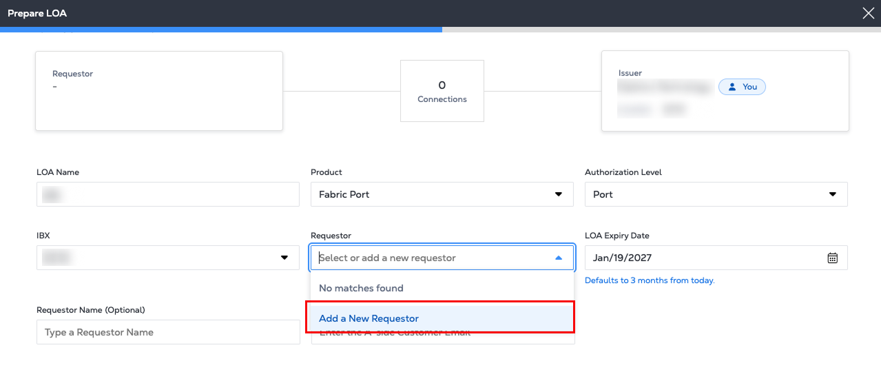

  4. Select the IBX and select or add a Requestor.
    • Click Add a New Requestor to enter the Requestor Name and Email. What happens next depends on what you enter:
      • Existing partner and email: The system confirms the email belongs to that organization and emails the Requestor.
      • Existing partner only: No email is sent. Use Copy Link to share the LOA.
      • New partner email only: The system identifies the organization from the email domain and emails that address.
      • New partner name only: The system matches the name to an existing organization. No email is sent. Use Copy Link to share the LOA.
      • Nothing is entered: No one is notified. Use Copy Link to share the LOA. Any user who opens the link can accept, and you then confirm them.
    If you select a partner from the list and also type a name, the selected partner is used and the typed name is ignored. If the system can't identify the Requestor's organization, you must confirm the Requestor again after they accept.

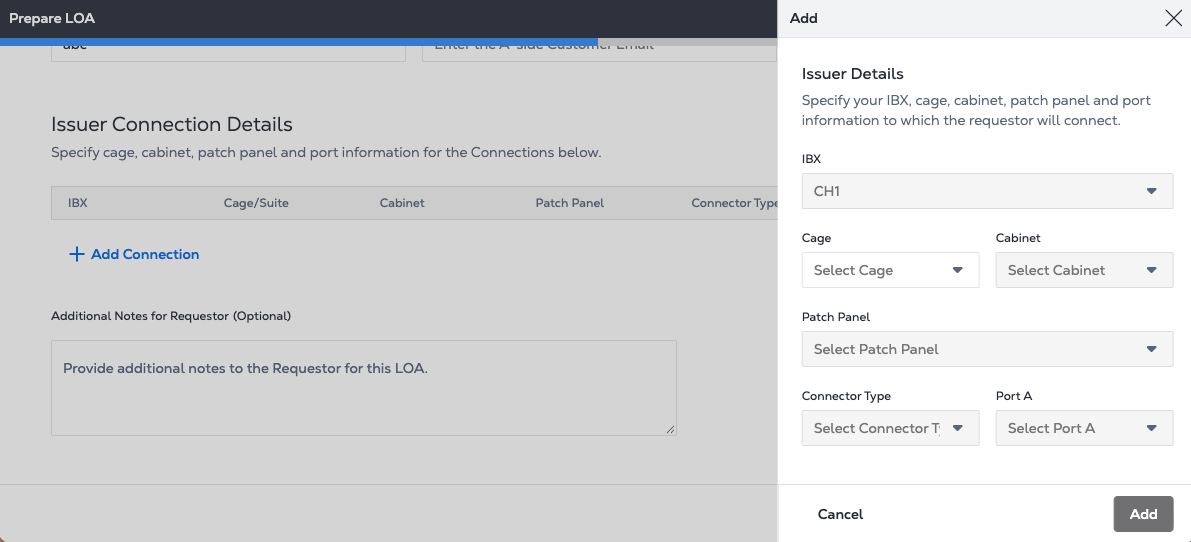

  6. Under Issuer Connection Details, click Add Connection and enter the equipment the requestor will connect to. The fields shown depend on the Authorization Level. This is the only place the LOA identifies the equipment it covers.
    • For the Cage level, enter IBX and cage.
    • For the Patch Panel level, enter IBX, cage, cabinet and patch panel.
    • For the Port level, enter IBX, cage, cabinet, patch panel, connector type, Port A (Port B for paired connectors).
    If you leave the port set to Next Available, the system assigns the next free port on that patch panel when the LOA is created. For paired connector types, it also assigns the second port. A port you select is always kept, and the two ports of a pair can't be the same. If the panel has no free port, the LOA is refused.

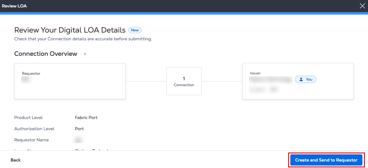

  7. In Review Your Digital LOA Details, verify that the connection details and contact information is accurate.
    • Click Create and Send to Requestor.

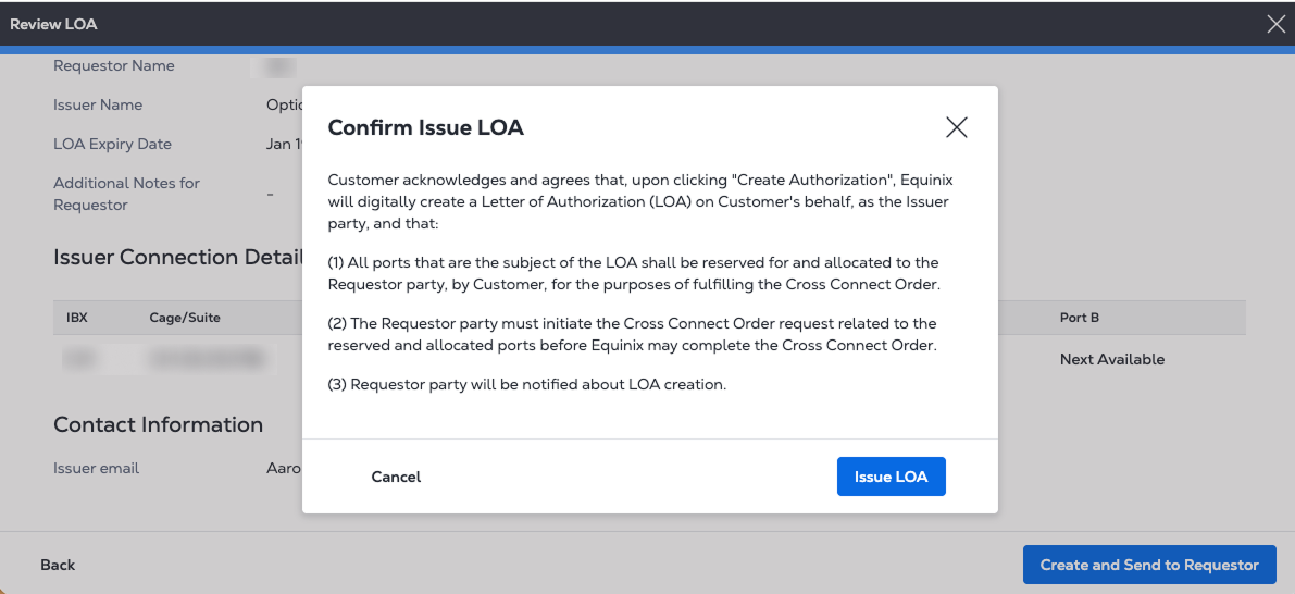

  8. In the Confirm Issue LOA card, click Issue LOA.

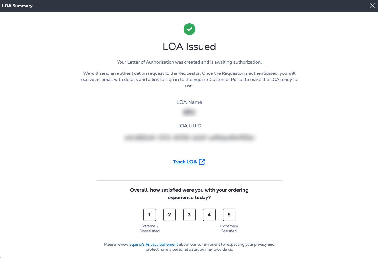

  9. The LOA Summary contains the LOA Token number which is a unique ID for the Digital LOA across the PDF, email, and in the Customer Portal. Your Requestor receives an email notification that includes the new Digital LOA as a PDF attachment.
    • Click Track LOA to view this new LOA in the Digital LOA Manager. The Digital LOA enters Processing (Pending) while the system generates the document and link. Because the success page appears before processing is complete, a newly created LOA may remain in Processing for a few seconds in the inventory.

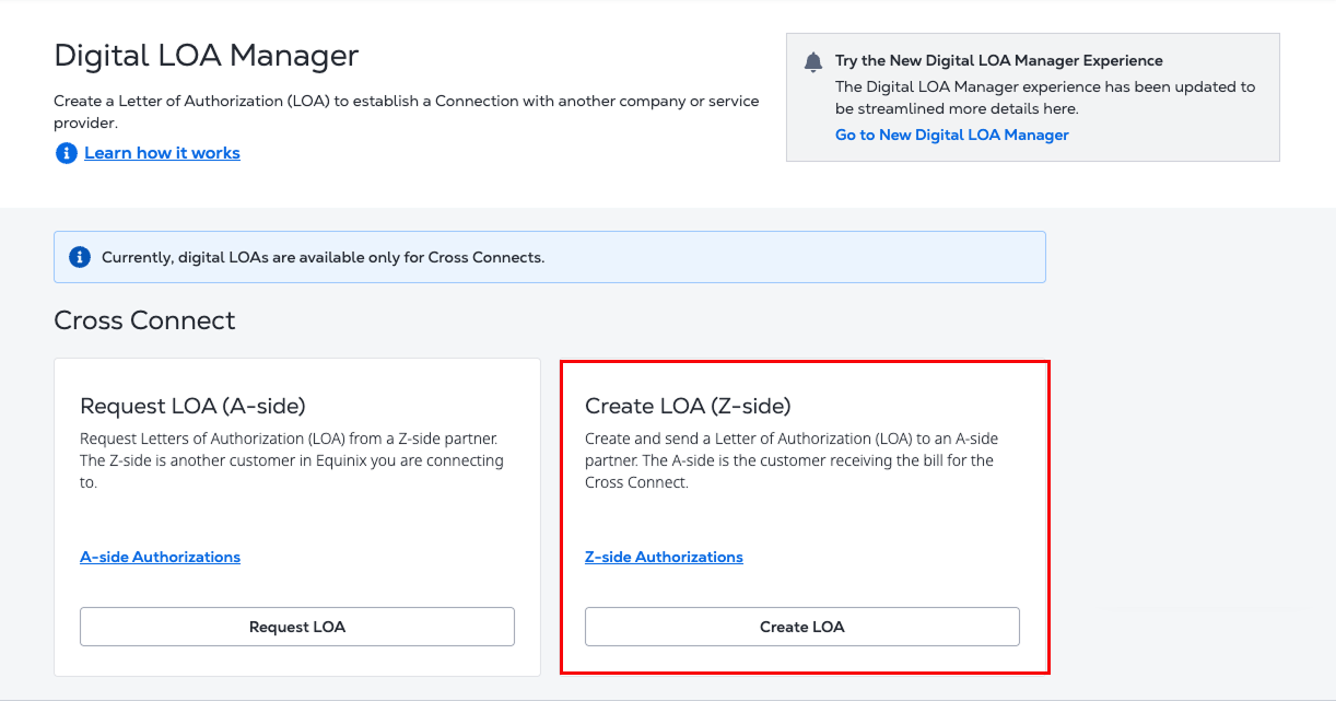

  1. Look for the Create LOA (Z-side) card and click Create LOA.
    • If you received an email request from an A-side partner, the link in the email takes you directly to this step.
