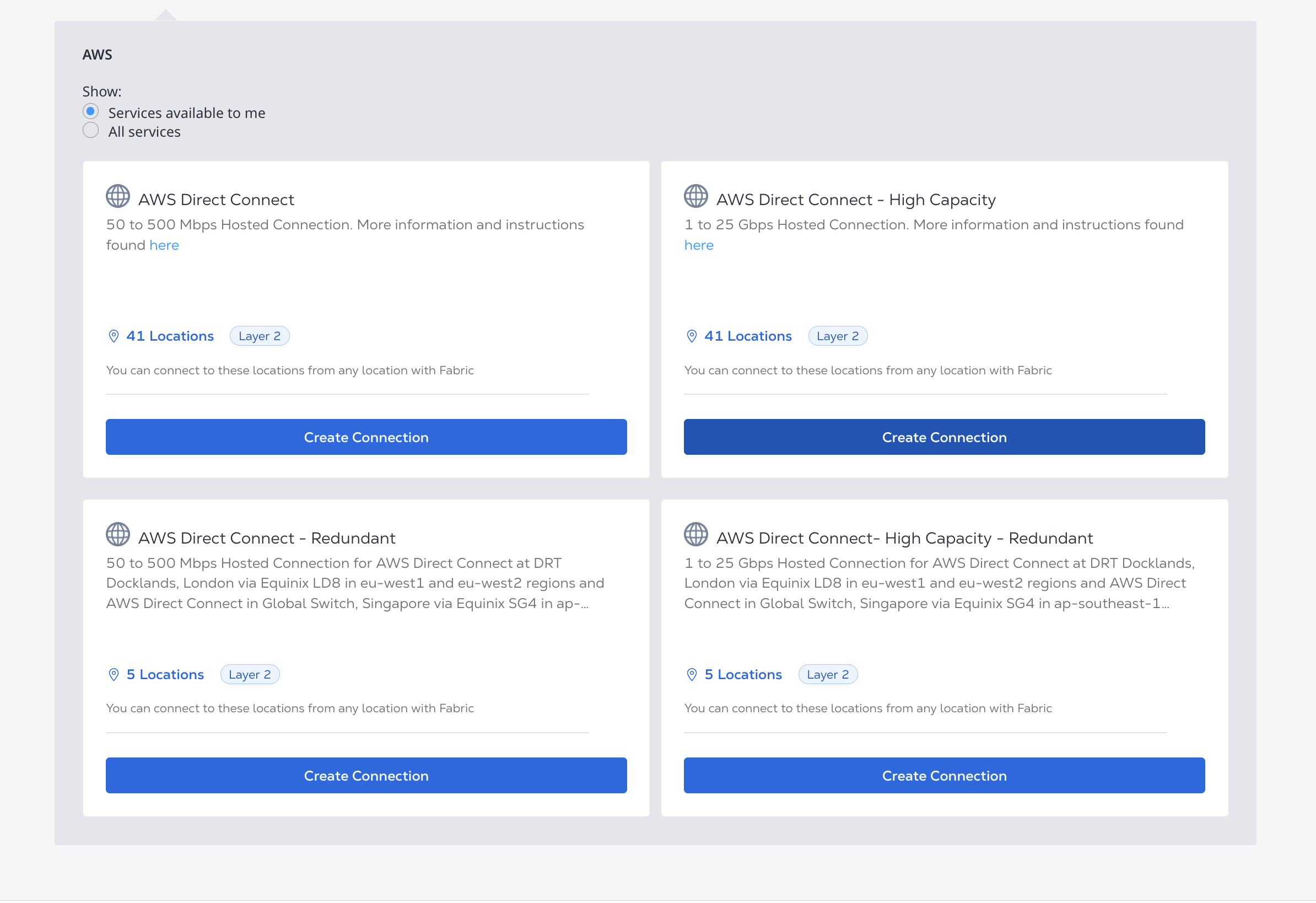

  4. In the A Service Provider card, click Connect to a Service Provider.
  5. On the Amazon Web Services card, identify the AWS Direct Connect service profile you want to use, then click Create Connection. More information on which service profile you should choose is on the AWS Direct Connect Overview page.
