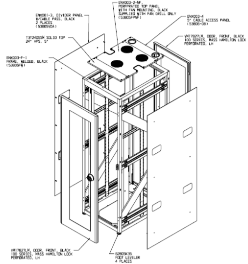

  • Cabinet Make and Model – The manufacturer's name and the cabinet model number. Provide cabinet spec sheets and diagrams, if possible. Example:
    Drawing of a cabinet with labeled parts
