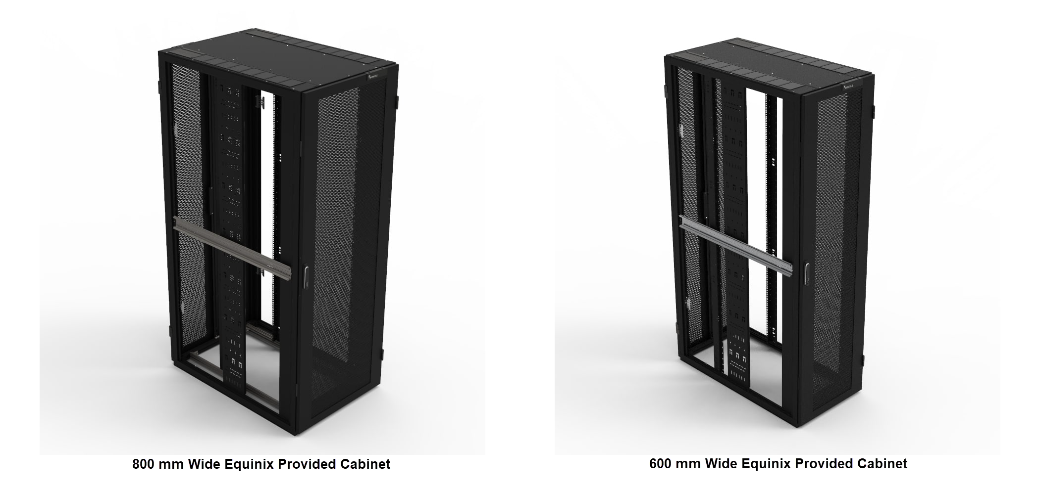

800 mm and 600 mm wide Equinix provided cabinets

Equinix-Provided Cabinet Specs​
EMEA​
AvailabilityBulgaria, Finland, France, Germany, Ireland, Italy, Netherlands, Oman, Poland, Portugal, Spain, Sweden, Switzerland, Turkey, United Arab Emirates (UAE), UK
DimensionsWidths: 600 mm or 800 mm
Depths: 1000 mm or 1200 mm
Heights: 2200 mm or 2422 mm
Note: Not all cabinet sizes are available in every IBX. Verify availability with your Sales Engineer.
Rack Unit Capacity2200 mm High: 47U
2422 mm High: 52U
Static Load Capacity1500 kg
EarthingFully earthed via central earthing point to Equinix earthing grid
Interior19 inch profiles: 4 vertical mounting rails with U Marking (1st U at bottom)
Adjustability: Front vertical mounting rails set 100 mm from door with stepless depth adjustment
Frame: Powder coated aluminum extrusions
DoorsFront Door: 80% perforated single front door
Rear Door: 80% perforated double rear door
Locking: Swivel handles with euro-profile key lock (Standard in Germany) OR Swivel handle with combination lock (Standard in all available locations except Germany)
RoofModularity: Modular inserts per 100 mm
Inserts: Cover Panels, Cable Entry Guides and Brushes
Air Flow Management80% perforated doors
Side skirts
Vertical mounting rail seal
Blanks / brushes to roof cable entry points
AccessoriesCable Management: 200 mm wide cable tray mounted 500 mm from the cabinet
Included Accessories: Earthing kit, Universal PDU Mounting Bracket (x2), Height (U) indication on all 4 vertical mounting rails
Optional Accessories: 200 mm wide cable tray, 300 mm wide cable tray, Strip to mount cable management to VMR & cable guides, Cable Management rings (10 pcs), Steel cable rings to mount on height profile, Double PDU Mounting bracket
Compatible ProductsSecure Cabinet (included as part of service)
Private Cage (as an installed accessory)
EU Business Suite (as an installed accessory)
