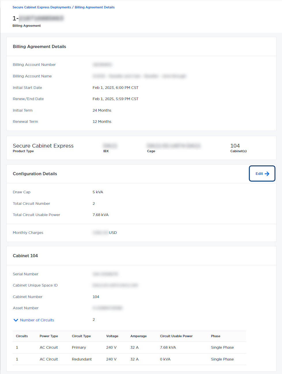

If you want to modify a Secure Cab Express deployment, see Modify Your Secure Cab Express Deployment.

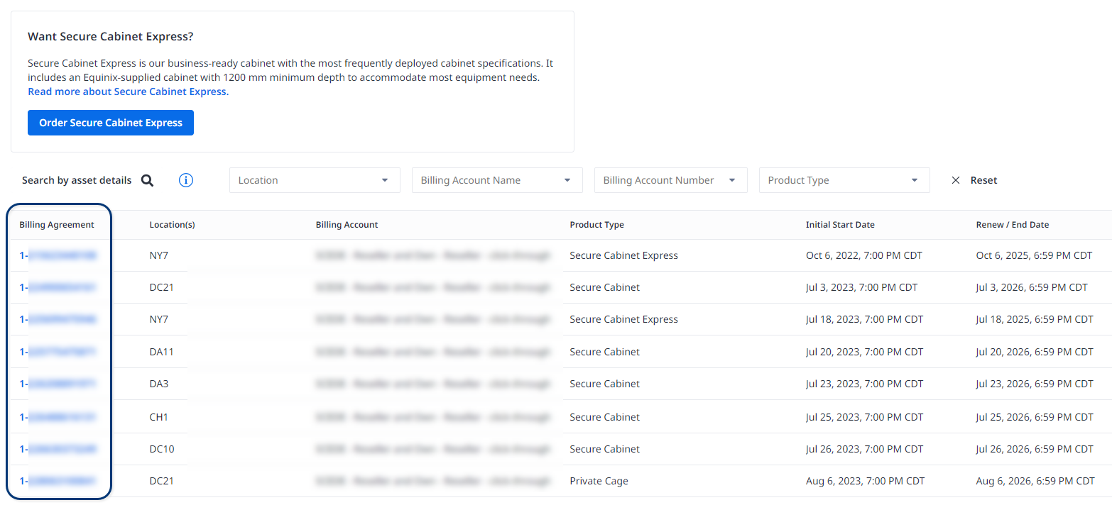

  3. Click on the billing agreement for the deployment you want to modify.
    Colocation Assets list with the Billing Agreement column highlighted
    tip
    You can search the list by cage number, cabinet number, cabinet asset number, or cabinet serial number. You can also filter by IBX location, billing account, and product type.

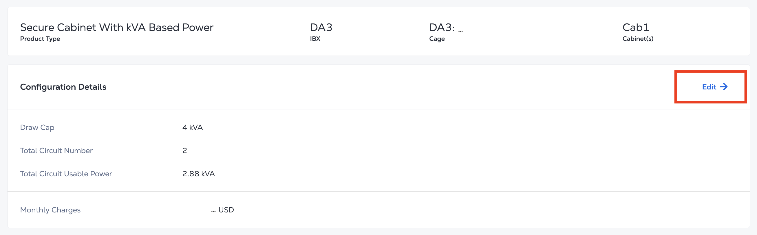

  4. On the Billing Agreement Details screen, click Edit.
    Billing Agreement Details with Edit highlighted
    The Edit Configuration Details screen is displayed.

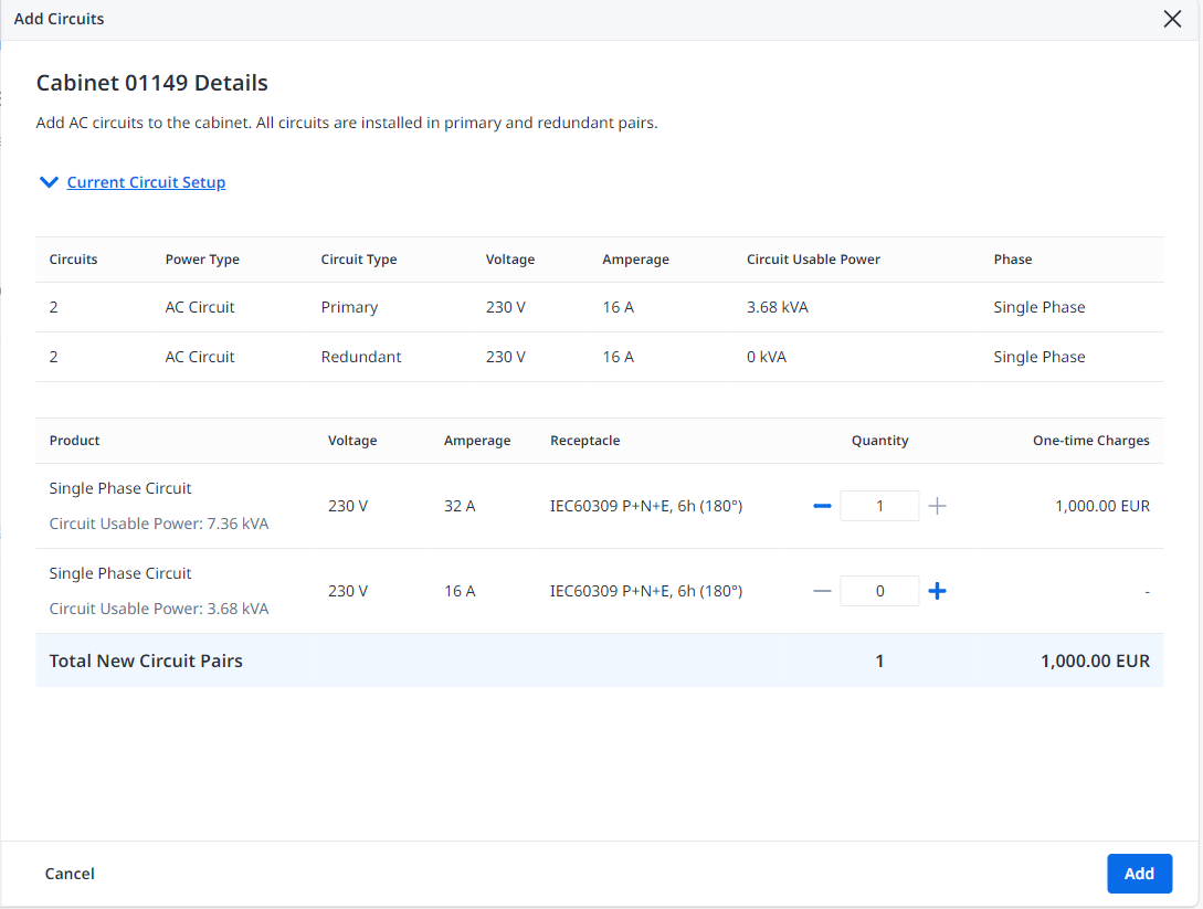

To add a circuit:

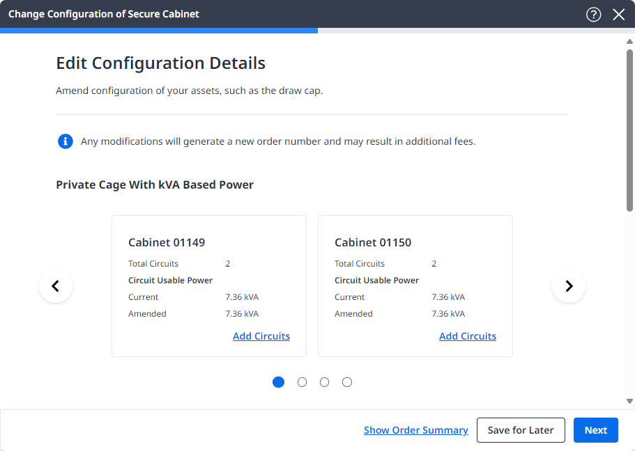

  1. Click Add Circuits for the cabinet you want to modify.
    Change Configuration of Secure Cabinet window
  2. Click + for the circuit you want to add. To remove a circuit, click -.
    Add Circuits window for one cabinet
  3. Click Add.

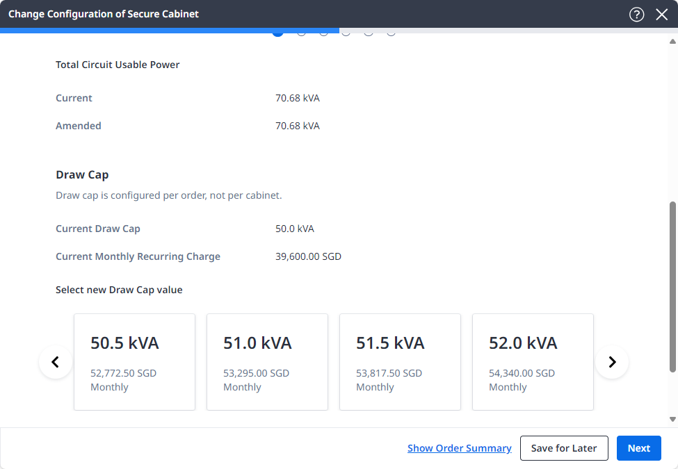

  4. Select a new draw cap value. This is the aggregate power draw cap for your entire deployment (not per cabinet).
  5. Click Next.
Increasing the Draw Cap​
  1. To increase the draw cap without adding circuits or cabinets, select the desired amount of kVA beneath Draw Cap, then click Next.
    Draw Cap section with new draw cap options
    info
