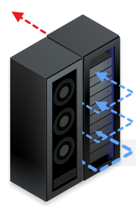

Augmented Air Cooling
Rear-door heat exchangers provide the following:
  • Enhanced air cooling
  • Does not require server-level retrofit
Illustration of a cabinet with a rear door heat exchanger

Each cabinet has a specified cold side and a specified hot side. It's important that your equipment is installed in line with the conditioned airflow, as follows:
  • The air inlet of the hardware must be at the cold side of the cabinet.
AND
  • The outlet (warm air) of the hardware must be ejected on the hot side of the cabinet.
info
Installing your equipment in the opposite direction could lead to cooling problems and malfunctioning of equipment. In the case of incorrect installation, Equinix’ service guarantees are invalidated. When we become aware of these issues, Equinix sends you a policy violation notification requesting that you correct the installation.

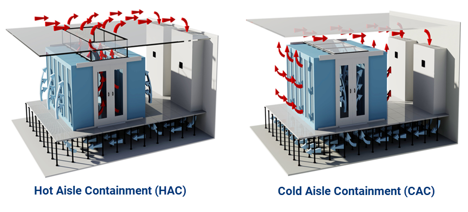

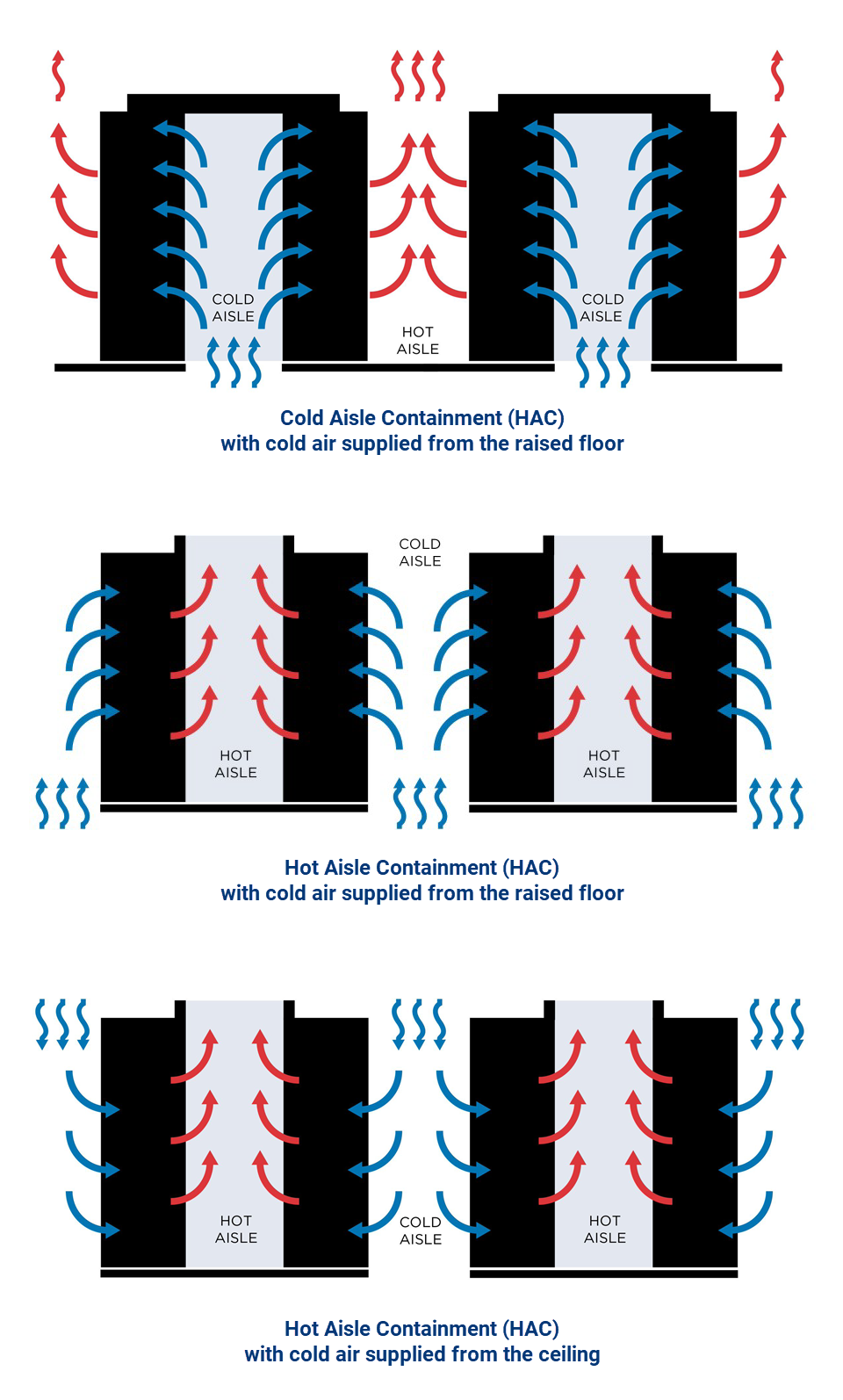

Air Containment Methods​
The most common air containment methods used at Equinix data centers are illustrated below.
The red arrows indicate hot air; the blue arrows indicate cold air.
Hot aisle and cold aisle containment diagrams
Airflow diagrams for hot aisle and cold aisle containment
Air containment methods vary by IBX data center, depending on the IBX configuration, the local building code requirements, and the local fire safety regulations.

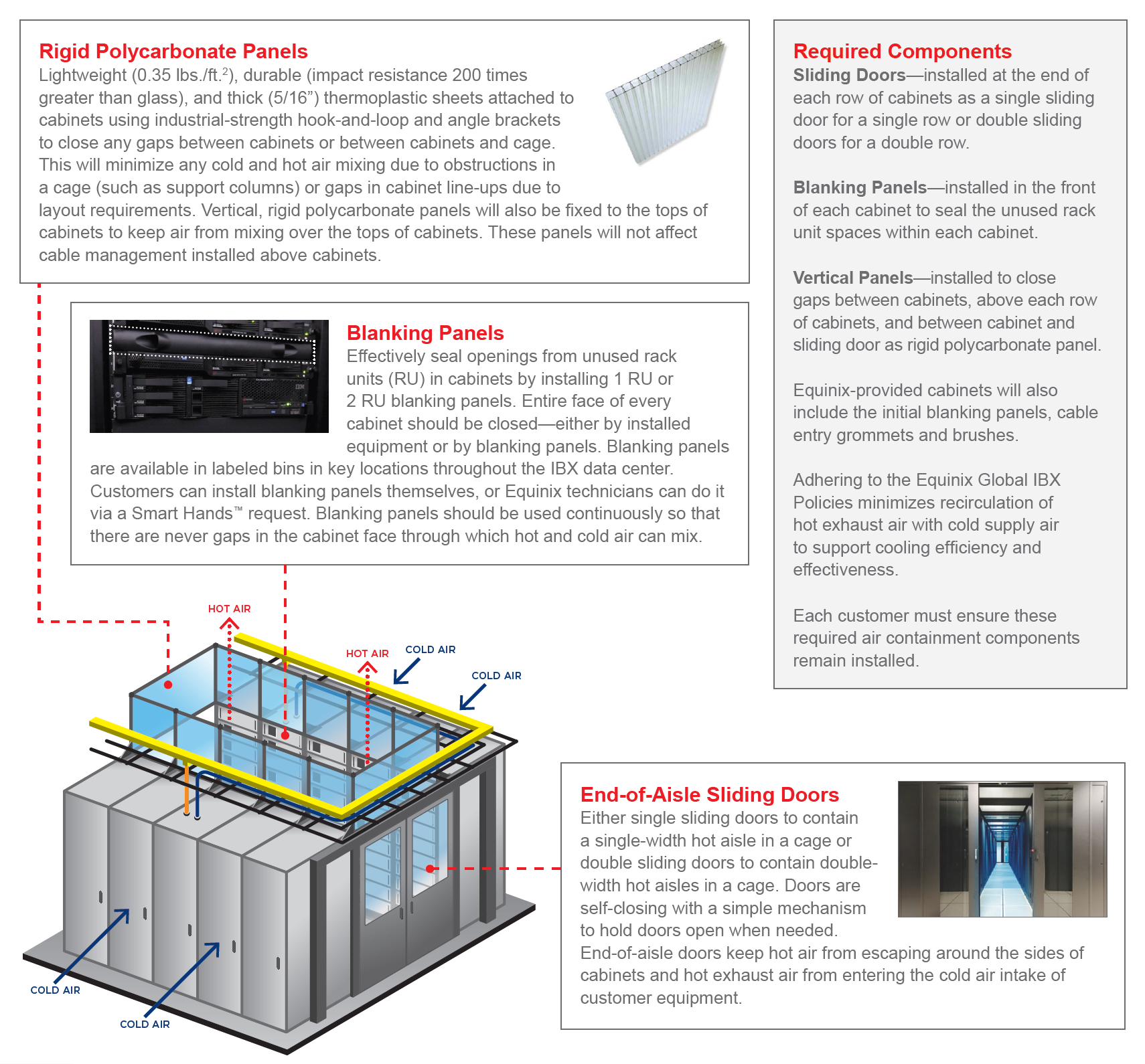

Air Containment Components​
Equinix charges for brush strips, rackseal foam, and switch duct accessories. Other components are provided and installed by Equinix at no additional cost to customers (in most cases).
These components are used to keep the cooled air supply separate from the hot exhaust air from equipment. Click the image below for component details:
Air containment components for a hot aisle
For more information, refer to our Customer installation Guidelines.

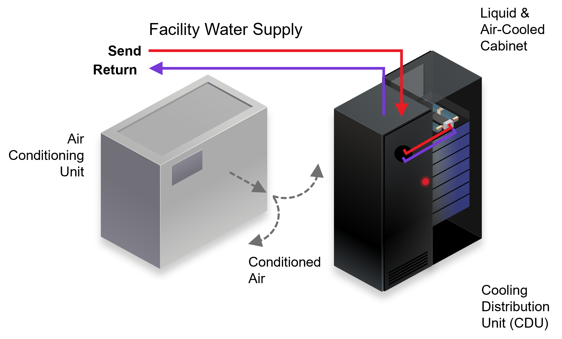

Liquid to Cage Offering​
The Equinix liquid-to-cage product offering provides the following features:
  • Standardized deployment configurations for your direct-to-chip hardware​
  • Enable both liquid-cooled and air-cooled hardware from a single environment ​
  • Equinix solution collaboration with your preferred original equipment manufacturer (OEM) & liquid cooling vendor ​
  • Bring your own cooling distribution unit (CDU) and connect directly to Equinix facility water supply ​
  • Compatible with most direct-to-chip OEM hardware ​
Diagram of a liquid and air-cooled cabinet with a cooling distribution unit
Liquid to the Cage:
  • Liquid circuits deliver controlled water flow to your cage
  • Primary tap off point to CDU as the liquid demarcation point
  • Bring your own CDU or purchase from Equinix

Liquid to Air Direct to Chip​
If you have a private cage, liquid cooling equipment may be allowed in your colocation space to support next-generation processors that require liquid cooling for optimal performance.
A liquid-to-air heat exchanger is a device used to dissipate the heat generated by electronic equipment. The heat exchanger circulates a cooling liquid (such as water or refrigerant) through a heat-transferring surface in close proximity to the equipment. The heat is transferred from the equipment to the liquid, which then carries the heat back to the heat exchanger, where it is dissipated into the air by a fan.
With direct-to-chip (D2C) cooling, the heat-transferring surface operates on or near the surface of the silicon chip. This maximizes heat dissipation, allowing processors to operate more efficiently than those cooled by air-to-air heat exchange.
Requirements:
  • Your colocation space must be a private cage (not a shared space).
  • You must provide the in-rack cooling equipment. It must be a self-contained liquid-to-air heat exchanger that sits inside the cabinet and does not pass coolant liquid to other cabinets.
  • The equipment must use non-flammable, non-combustible coolant such as deionized (DI) treated water or PG25.
